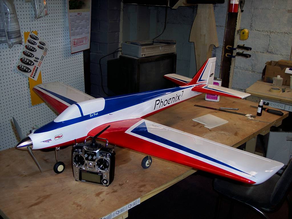

Here is my P-7
Futaba 10C 2.4
Webra Speed .61 with Macs black pipe
E-Flight electric retracts
1600 ma 6v battery
digital on flight controls, std. on throttle
8 lbs. dry weight
Now for the mods... Fiber glassed the FW to the fuselage. Shimed the MM to line up the spinner w/ the nose ring. Added a sub rib the the wing LG mounts and made a slurry of epoxy and milled fibers to the joints.

Retracts were really never about drag reduction. If some thought that was the case, it really wasn't. Now if you put doors on the gear and close up the holes, now you have drag reduction. But retracts were always about the look. They just make the plane look much better, particularly models of the era. Also a small improvement in bringing the weight of everything closer to the center of the model.

More thanks for the ideas guys. I agree with Tony mostly onthe retracts too, whatever drag (would that be parasitic or induced!) there is from the gear might be equal tothat produced from the open bays etc., but it does look good tucked away. I'm frustrated enough with mine that I'll probably stick the fixed gear in it and just fly it. Finally got the motor mount squared away to where I'm satisfied with it, the SIG EM001 mount is almost a one-for one replacement and only $4.25 at the LHS, the rails were much straighter and only required opening the holes for the firewall bolts. Only two weeks until the FVAC classic andI need some air time on it. Probably could've finished the TT III given the time spent on this. Going to go 1650 mAh NiMh for battery, I like the LiPo idea with the reg, but I just don't have time to get that set up (thanks Scott). Need to take care of the offset(fuse twist?) between the stab/wing and I should be done (I consideredheating the fuse to take out the twist, but then the vertical stab would not be perpindicular and then....., well you know). Any guesses as to how many P-7s will be at Rusty's Classic for 2011? I'm bettin at least a few!

Oh yeah Tried Tony's dubro tank mod on two different planes!! Awesome!!! Thanks Tony! A big fo sho on that mod! Outsides were much more consistent needle wise for sure! We bit less flight time tho[:@]
Now as for gear doors........... Hmmmm ELectra nose gear door setup would work maybe mains strut doors would work too!! That would be cool. Oh well next one maybe.
