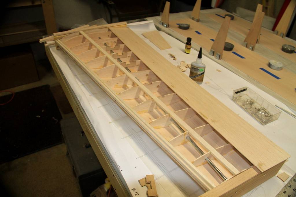

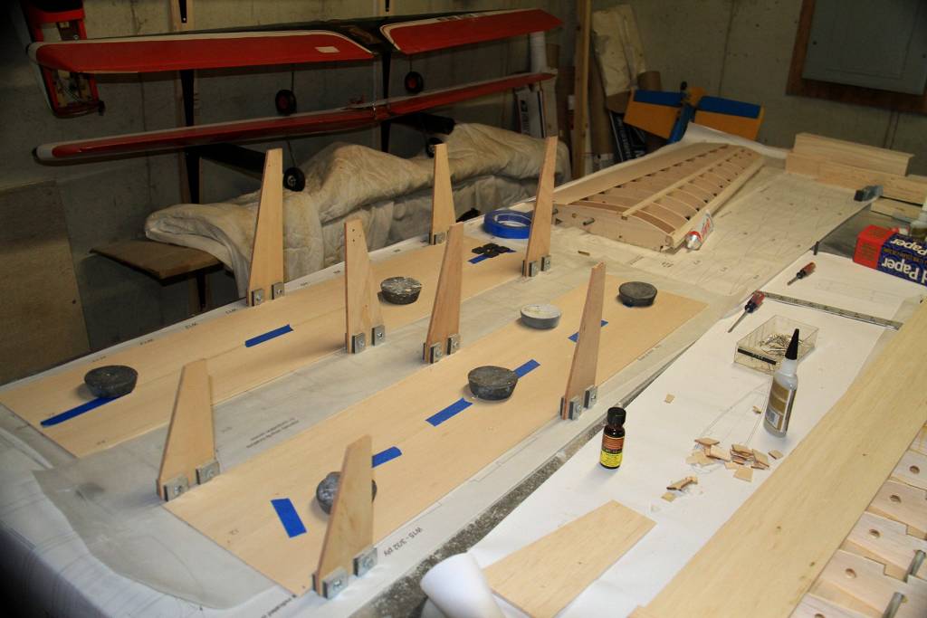

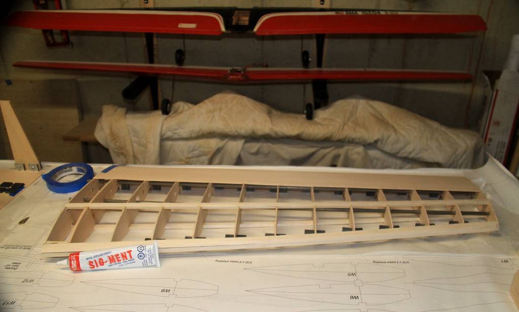

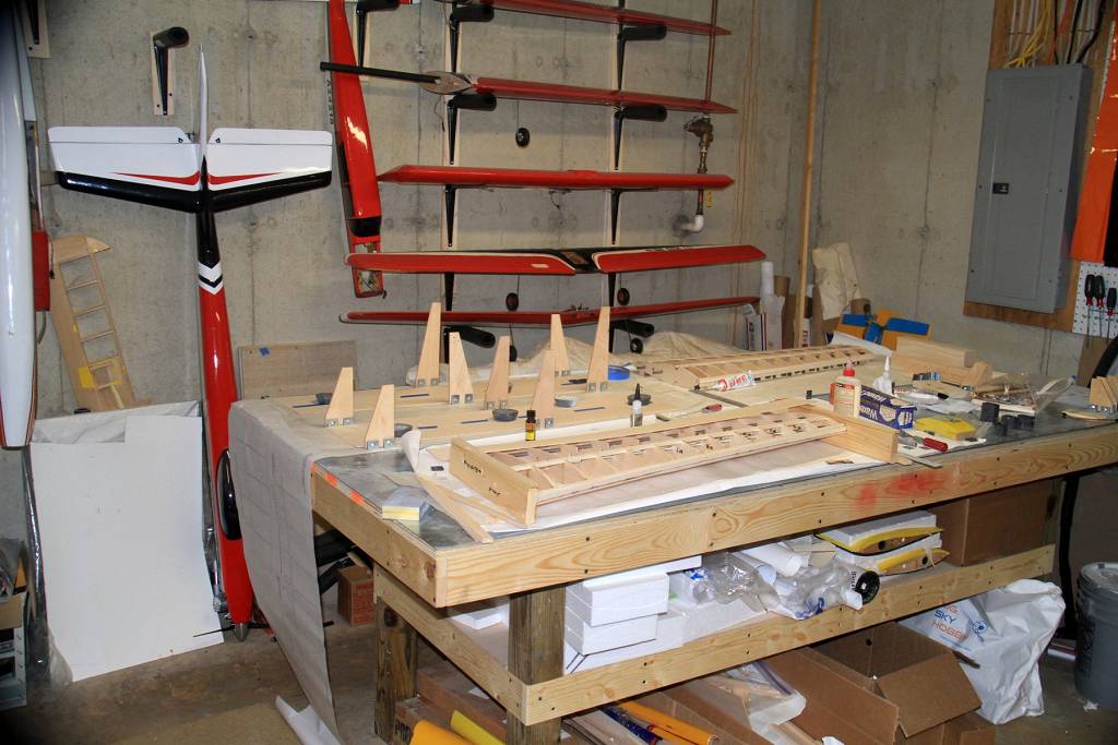

While we're waiting for some progress on the Simla(s), I thought I'd post a few pictures from the shop showing the King Altair wing in progress. Notice in the background the #1 prototype Simla standing up next the Altair #2, which is hanging there waiting for a few pieces of Monokote trim to finish. It is way too heavy for SPA, built with Tower balsa before I became weight-conscious, (don't buy your balsa there).
Ed Kazmirski's original Taurus II wing, (semisymmetrical) at only 1.1lbs as you see it, (note the original FAI sticker...it was Ed's back-up in Belgium..this was Ed's super thick wing), with the present Taurus II wing below.
I never made any claims to be as neat as Kevin.
Duane

Neat workshop? How do you do that????? I hate clutter but it always finds me!
Duane, that Sigment is the best for gluing wing sheeting. I wished it was carried by more hobby shops. I grew up using Ambroid. Testor's cement was also good for gluing sheeting. Your wing looks very good!
7.25 lbs for a King Altair? That would fly sweet. Please let us follow your build.
