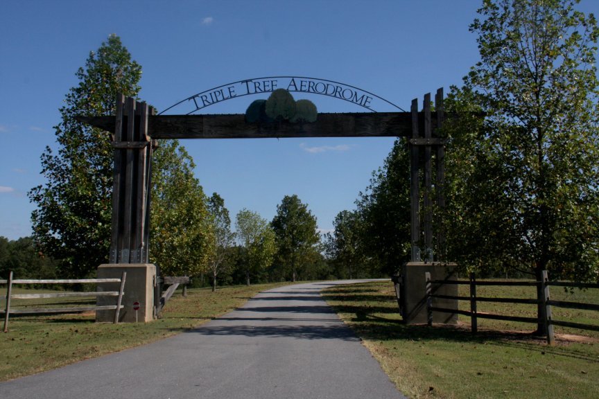

I will try to get permission to use Triple Tree...the sight of Simla's first flight.
Duane
