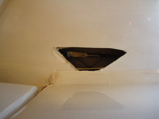

RE: SIMLA BUILD THREAD
In regards to elevator control horn access I tried something different. I made a small access hole on the port side as my fingers seem to be too big to get at it from the bottom. I can insert and remove the goldenrod push rod through this port. Removing and attaching the clevis is done with a small "L" shaped pick and the clevis keeper with small forceps. When all is finished I'll cover the port with monokote.
Tonight I'll glue on the canopy. Tomorrow final balancing and then I'm done. Here are a few pictures of the access port and radio/fuel tank installation
#756
The side hatch is an interesting idea, and I'll see how well it would work on mine. I am, however, using a rigid carbon fiber pushrod.
I do like the simplicity of your control setup. Going with the pull-pull on the rudder has got the servos scattered all over the compartment, and to get a non-kinked run to the nose wheel, I had to use a separate servo. So, one each for rudder, elevator, nose gear, and throttle.
Richard,
The side hatch allows an almost straight shot up the fuse. I cut the side between the fuse diagonal stiffeners, added another stiffener inside to complete the triangular opening.. It should work with a rigid push rod as well.
Thom
Thom

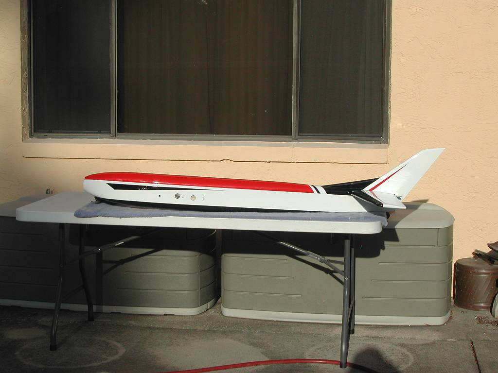

#772
Join Date: Oct 2009
Location: ORLANDO,
FL
Posts: 338
Duane,Jeff, Richard, Thom, et al,
Well I finally put some paint on my Simla fuselage this week. I guess it's about time since it sat in primer for over four months. Oh well, life somtimes gets in the way of the truely important stuff and many added unexpected projects did not help either.
My sincerest congratulations to Thom on Simla #4!
It will probably be a week or two before I am able to complete the wings. At which time I plan on asking one of our more prominent club members to maiden my Simla and even perhaps to maiden my Taurus at the same time. The gentleman I am referring to would be Mr Don Lowe of the Phoenix fame in the early 70's I believe. He isa club member who at the age of 85 still flies better than I could hope to. It should be great fun.
Anyway, here's a few shots. The last one might be of particular interest to those who are considering a paint job as opposed to a film finish.
Bill
PS- Yes that's me taking the picture of the hatches.
Bill
#773
Bill,
Bloody gorgeous! I can't draw lines that straight with a ruler; never mind spraying paint.
Mine will not approach that. Actually, I'm not even sure how I'm going to paint it. I'm pretty much out of funds, so picking up the other items I need for spray painting is not going to happen. Hate to say it, but rattle cans may be the way I have to go.
Cheers,
Richard
#774
Join Date: Oct 2009
Location: ORLANDO,
FL
Posts: 338
Richard,
What ever way works for you will be fine! I am also feeling the financial crunch to the point that I am not using what I would normally consider as top shelf materials. However, I am finding out that some quality paint work can be done with less expensive materials. It is true that I am still using urethanes, but not the most expensive ones. As a matter of fact I used Nason urethane clear instead of Dupont clear and the results that I posted were right from the spray gun (a cheap $20 Harbor Freight spray gun at that). And for those in the know I also know that Nason was purchased by Dupont some years ago, but the formulas are different.
Anyway, the straight lines are compliments of 1/4 inch3M fine line masking tape of the blue variety. I am not sure about the bottom black positioning, but it was the only way I could keep it parallel to the upper red panel. I guess some input from Duane is needed here, as I can alter whatever I need to before I am finally finished with the fuselage.
Bill
Bill
