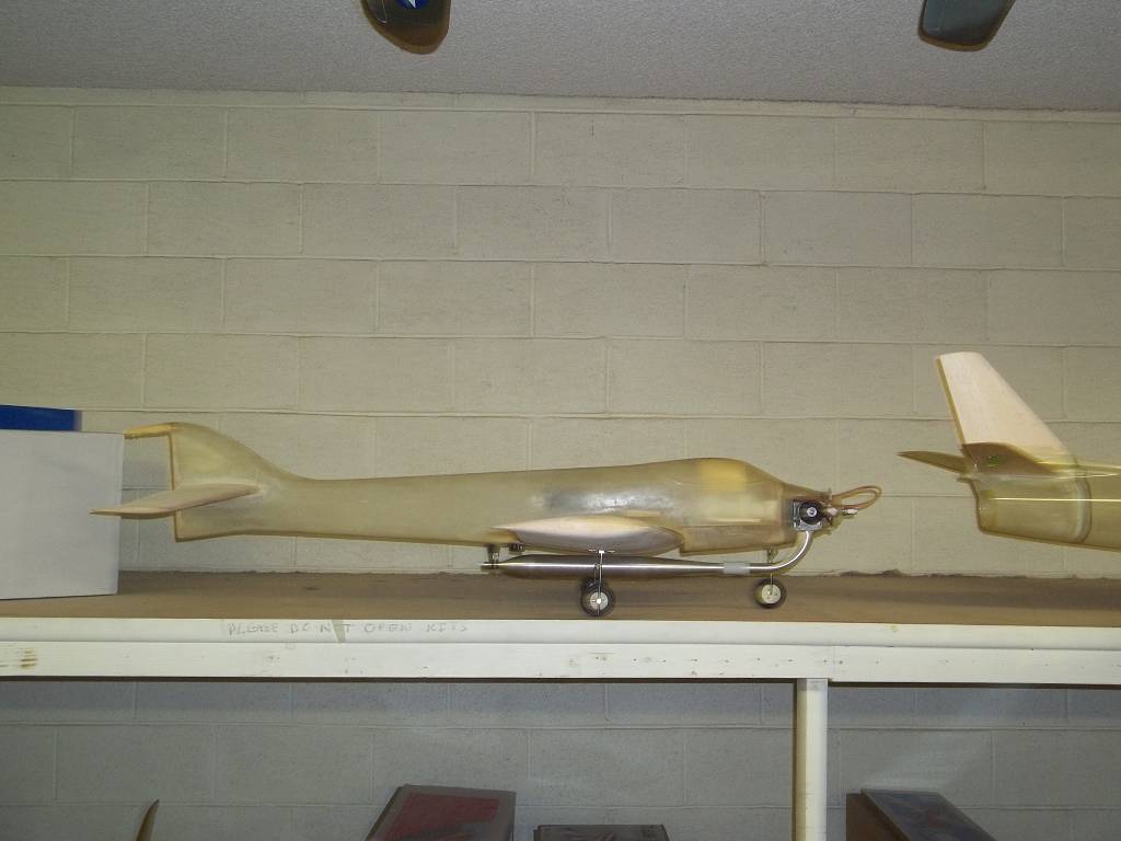

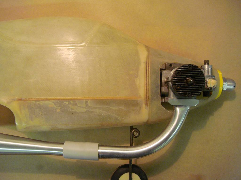

Here is a picture of my new fresh out of the mold SUPER CURARE. I am making very good progress, I have been on it about a week now. It has ys 61 engine with macs header and pipe,spring air retracts, with kraft wheels!! .nose wheel is larger than usual so it folds into wheel well at a 45 deg. angle. Wings were joined today and will get it fit to fuse Friday.

I was noticing the light reflection on the side of the fuselage and the detail of the canopy frame on the first picture. The glass work seems super smooth and should take on a great finish with very little filling. It's looking really good.

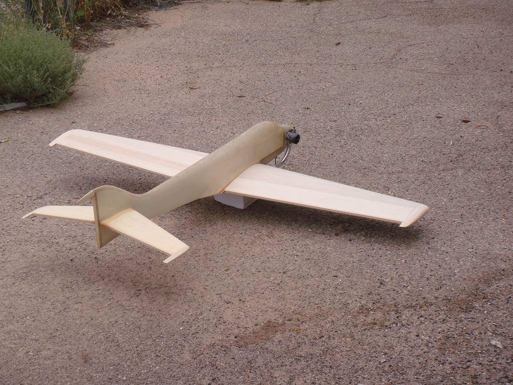

here is a pic of first get together of main parts!

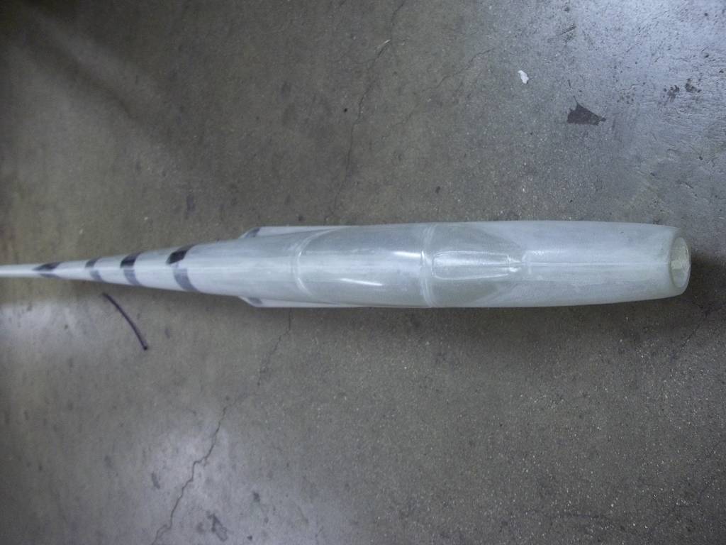

here ar pics of another super curare,with carbon viel laminated into rear of fuse this realy stiffened up the fuse,wish id done this on my current build. any interst in this one?

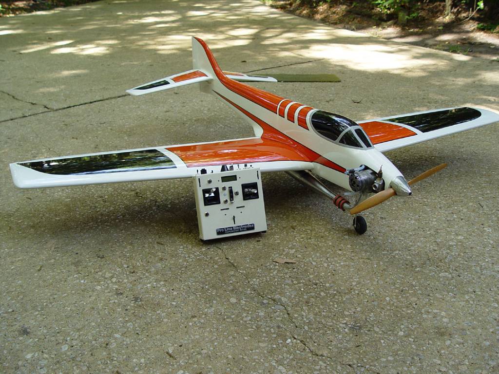

Here's afew pictures of a Super Curare Quality Line kit that I recently built. Powered with a Rossi .60 and equipped with Goldberg retracts. Flys great.

second attempt to post pictures of my Super Curare.

Nice looking model. You can really see the Tiporare lines in that one.

That is indeed a nice looking plane. Hard to deny the reward of painting.

VERY NICE! Great color scheme!

PM sent to you HRDFLITE. I think the added carbon in the fuse is a great idea. Will that be optional or standard?

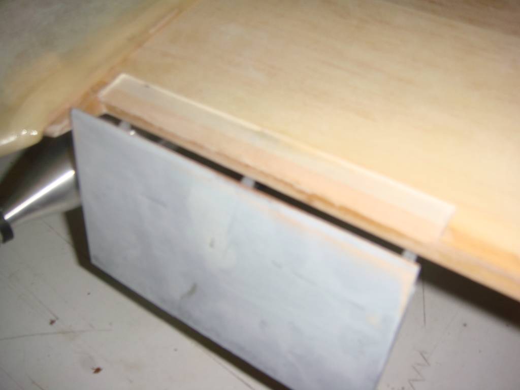

her are some pics of my speed brake arangement
