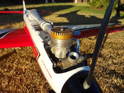

Hello gents

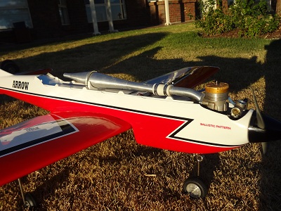

I have decided to finally finish an arrow pattern ship which I have been working on and off for the past 5 years.
The engine I have installed is an OPS 60 goldhead Super SPA RCA which I bought about 25 years ago but have
only run a few times. Unfortunatey I don't have any instructions for this motor. I have also purchased an OPS pipe
from the United States to suit the engine.
I'm relatively inexperienced with motors other than OS and Saito fourstrokes and have no experience with tuned pipes but have
read a lot of info from the very experienced modellers which contribute to this great website.
For initial testing I set the pipe length at 380mm (15 inches) from the glow plug, used an APC 11x9 prop and 10% nitro fuel.
The motor seems to run quite well although quite rich. At this pipe length I'm getting 11,300 RPM. The strange thing is that the needlevalve seems to do
nothing - I can wind it several turns either way with no difference to the rpm.
When I hold the model vertically the engine richens by a few hundred rpm. If the fuel tank is below half the motor
will stop when held vertically.
Would anyone have the instructions for this motor or be able to offer some advice on the use of the needle valve and recommended prop/tuned pipe length combinations ?
Many Thanks
Neville

RE: OPS 60 Goldhead instructions and advice
Neville,
Did you tach the engine at low? What plug are you using? Fuel (brand, oil)?
Does the engine shut down when the needle is closed? Does it transition smoothly? I don't see a pressure line, do you have one going to the header or pipe?
I'd suggest taking the prop down to an 11x7 to 11x8 for a starters if the engine is newish and bring the rpm up by tuning the exhaust. You ought to be able to get it in the 14K+ rpm on an 11x7 when tuned.
I'm going to look for my instructions.
David
PS Nice Arrow by the way! MK kit?

What kind of setup do you have? It does not look like you are using muffler pressure. Most guys used a pump with these engines to keep the fuel flowing. With out being able to adjust the needles, the pipe needs to be tuned too. If the engine can not "get on the pipe" the carb will not adjust right. Like above the prop size has to be right.
gents
thanks for all the good advice. I will take off the carby, clean it and inspect the fuel tank.
I was running muffler pressure - just didn't show up on the photos.
I will also try an APC 11x7 prop. The fuel I'm using is 10% cool power.
At idle the motor is doing slightly under 5000 RPM.

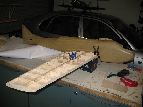

David - the model started out as a polyester fuselage which I "inherited" (see attached photo) - can't remember how exactly,
and then I scratch built wings and tailplane from plans off the net. I'm also trying e-flite electric retracts.
I have considered an OPS pump - I don't think I could actually fit it in however - I'm struggling to fit in the battery
and leads for ailerons, flaps, retracts etc etc
I will let everyone know once I've tried a few modifications
Thanks again
