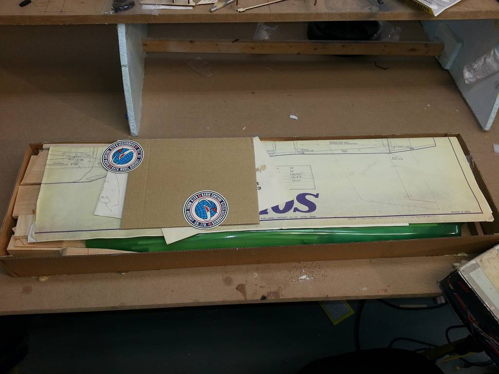

Feeling the urge to build, I have decided to start a Mk Cosmos. Although I have the kit, I will only use it for copying. In addition to cutting a lot of wood today, I also made a trip to Kinko's and copied the plans as well as saved them to a pdf format. Coincidently I have received 3 requests recently for a copy of the Cosmos plans. I will post a pdf here for those interested.
Here are a couple of the box photos. Of course hoping the recent problems with RCU have been resolved.

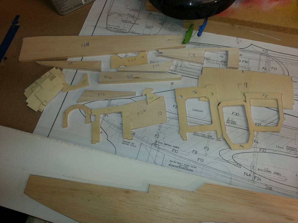

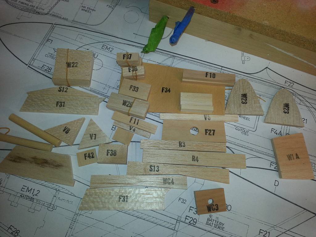

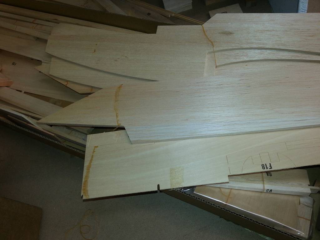

A view of the rubber bands around various packets of cut wood. Long ago dissolved into goo. As usual the wood quality and cutting is most excellent. I will be copying each and every piece and returning the kit to original conditions as best I can.

A view of some wood cutting today. As long as the wood is assembled square, the finished product is where you focus your efforts.

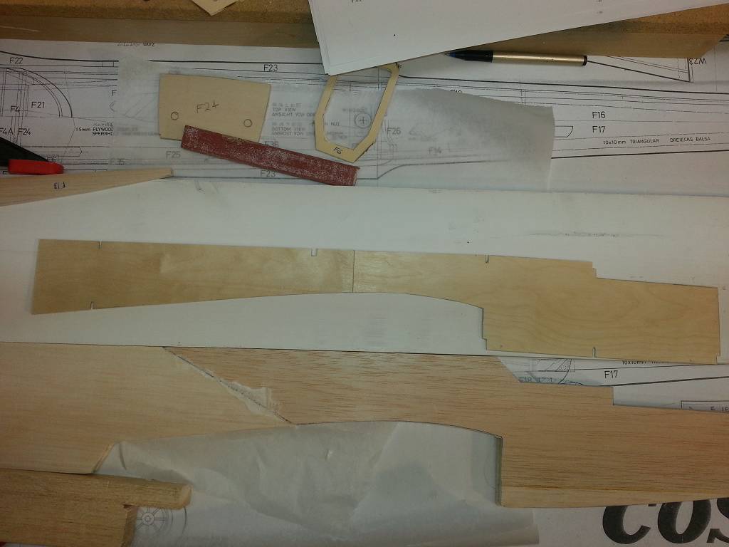

Working on the fuse sides. The sides are 1/4" slab balsa with a 1/16" ply doublers. RCU is only allowing 2 photos per post.

More side photos.

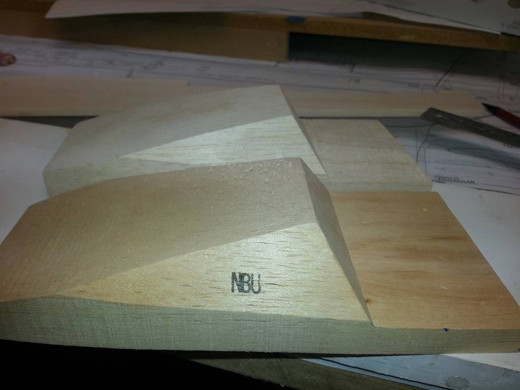

Working on one of the fuse top blocks. A Jet bandsaw will make quick work of balsa.

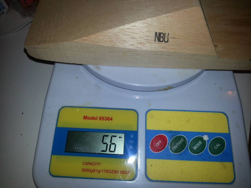

A bit heavier than the original but not completely sanded yet.
