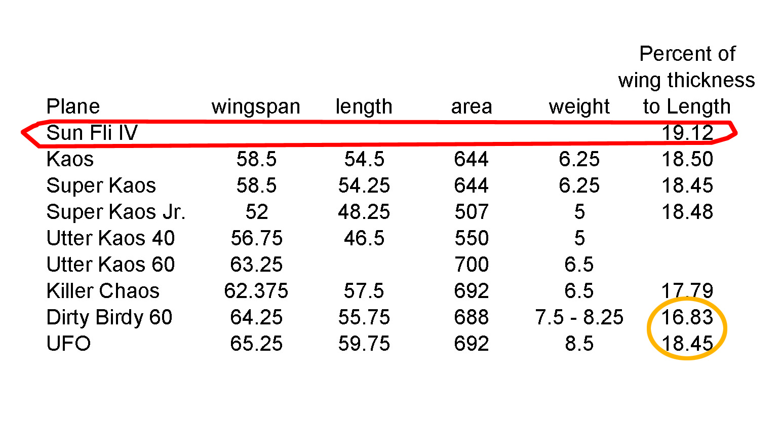

Your question led me to check out some various wing thicknesses of several of Bridi's older designs based on the percentage of wing thickness to cord width and of Bridi's designs mentioned above the Sun Fli 4 has an almost 20% (19.12%) wing section (thickness). see red outline in table below
If you're looking for a kit the Sun Fli 4 from Blue Jay should provide you a slow flying plane as long as you don't put the pedal to the metal. Not as slow as a Kadet, but slow enough that you should be fine with it. http://www.bridiairplanes.com/hangar/sunfli4.html The price for it is reasonable at $100 plus shipping.

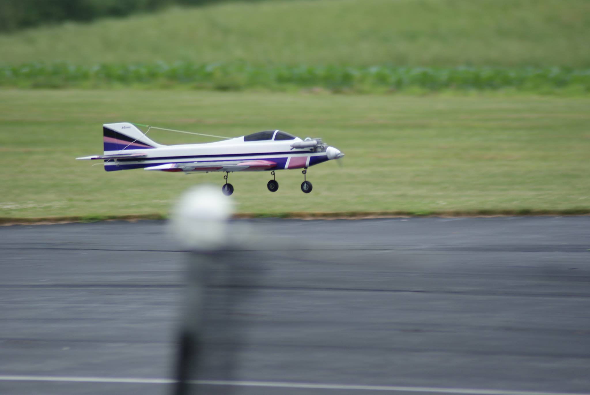

Hey Phil,
what I meant by a "slow stab" is that it is a lifting diamond airfoiled stab (slow is not a bad thing). This should make it a little "softer" in response to controls. The SP was specifically designed as a pattern trainer and uses a continuously variable airfoil. As you know, the root is semi-symmetric with a max thickness somewhere in the 40-50% of the foil. This moves to ~30% fully symmetric at the tip. According to the designer this wing should be very forgiving and allow good low speed handling in flight. Part of the problem with the original plans is that the foils are inaccurate and length incorrect. Brian just offered to send me some info so that we can fix this (I think it's mostly done but could use some cross-checking).
I forget what engine you have in yours but the model should handle well at ~30% throttle on a 40. Naturally with a 46 or 50 it will move out but the model was designed for a K&B 40 (or similar) so it should offer good handling with such an engine if built to 4.5-5 lbs.
I'm inclined to having a foam core wing cut for it as it would best represent the airfoil the designer had in mind.
David

I was going to post earlier in the thread but got side tracked on the table/chart. I had to go through all those plans and measure the cords of the wings from the side views.
I'll include the XLT and Escape but I do not have the Great Escape plans. I would need the length of the cord of the wing at the fuse side including ailerons and its height at the thickest part of the wing.
Wouldn't be cool to have a Spreadsheet or a table of the all the specs for these style of planes?
