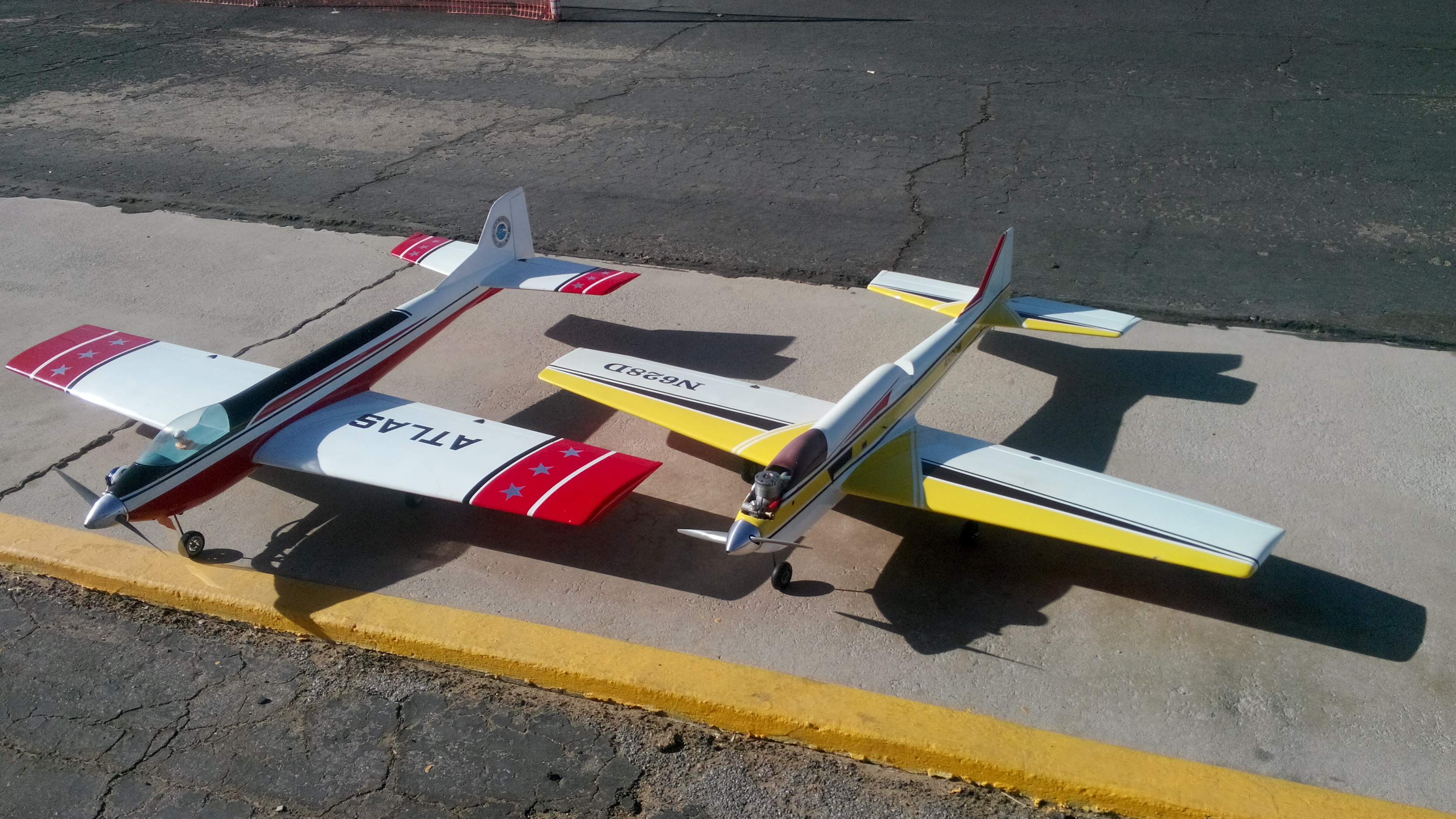

Hello Pattern guys
I just maidened my new Arrow, wearing a Picco 80 RE.
I suppose I have the CG wrong but please let me know if I am missing something. The plane flies "unstable" in the roll axis. It tends to increase roll to whatever side it starts banking. It is also extremely responsive to aileron input. I set up low rates at 65% w/ -50% exponential, and it is STILL too responsive.
I have checked everything and the plane (bought used) is perfectly straight and very light.
Supposing it was tail heavy, I added 3 oz of lead to the nose. It improved some, but seems to require more!!!
Totally puzzled. I supposed such a nice build should not require nose weight if using the Picco 80.
Help!!!

Hi Ed,
First, really nice looking airplanes!
As for the Arrow's aileron sensitivity - the CG has little, if any impact on aileron sensitivity much more so on elevator response (which is not the problem). You did not indicate how much actual throw you have, but I would guess that you have too much throw, especially given that you have an '80' for power (plenty of airspeed). How is the aileron response at low speed? I would try reducing the throw by %25 -%50 of the current maximum. You can probably remove the nose weight, too. The Arrow does not have an exceptionally long tail moment and with an '80' sized engine, plus retracts it is pretty hard to get it tail heavy.

Thanks Flywilly.
I will reduce the throws mechanically, but as I stated, the main problem is that it just continues to roll to either side as soon as it starts banking. That is, if I set at 30º it will continue to roll ON ITS OWN until it is close 90º. Thats to either side. I also setup aileron low rate to 60% AND -50% Expo The responsiveness was reduced but the situation mentioned above was not.

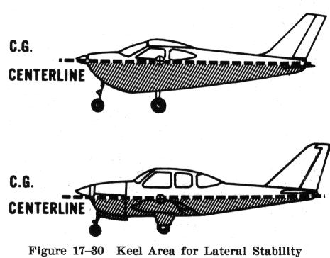

Hi Ed,
Just to be clear (for me), you initiate a bank then neutralize the ailerons and the Arrow continues to roll. Is there any slop in the aileron linkage? Are the ailerons sealed (no gap between the aileron and the wing)? I actually had this problem with my first Arrow; the cause was a bad RX which let the ailerons drift - this was more than 30 years ago. Does the Arrow show any rolling tendencies when in level flight (upright or inverted)?
If the roll improves, then it is possible that the CG may be too high for some reason (due to vertical location of engine, battery or fuel tank maybe).
For stable flight, the vertical location of the CG should be at or just below vertical location of the center of lift.
If not, the CG will be trying to over-roll the plane, so it can adopt the lowest point respect to the center of lift.

Two interesting possibilities. I would probably discount the first suggestion regarding the vertical CG placement, though plausible, the design of the Arrow precludes having equipment far enough from the center of lift to have an impact (the fuse top mounted pipe puts all the equipment at or slightly above the C/L with no real option for relocation). The nose heavy condition is logical, but Yak13 added 3 oz of nose weight and observed a slight improvement in the aileron sensitivity. If the Arrow was nose heavy enough to cause unwanted roll issues I would expect it would require significant up elevator trim to maintain level flight and have very 'mushy' elevator response.
Of course it is very hard to make a diagnosis from 3,000 miles away (or more)! I think we need more information, here.
After looking more closely at the photo of your Arrow, I wonder if that is an original Arrow or a Quality Line (Hobby Barn) Arrow 800. The wings appear to have more span than the original Arrow. The original Arrow had a span of 63" and a length of 55". What are the dimensions of your Arrow? Also, what is the construction (wood or glass and foam)?
