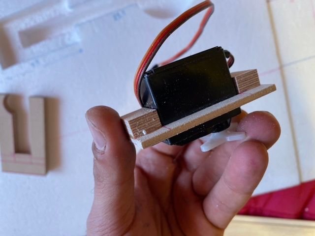

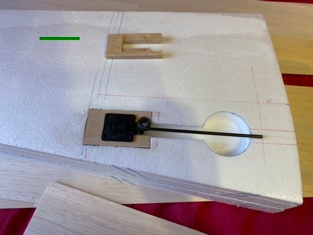

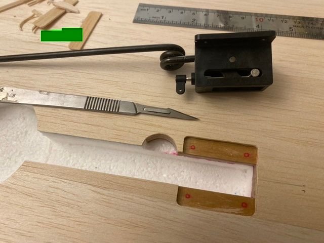

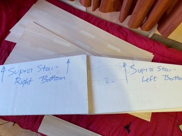

Hi all
Finally I found a lot of time in quarantine days of COVID19 to make one of my favorites.
this will be an image based thread with no or less explanation.
Ehsan
Foam cores from 12kg/m3 density foam. Cut with a simple home made hot wire foam cutter
1.5 mm balsa skin
Foam is hollowed with dremel and round Cylindrical sandpaper
Reinforcement of wing and landing gear mount with glass fiber strips an carbon thread
Ehsan
1.5 mm balsa skin
