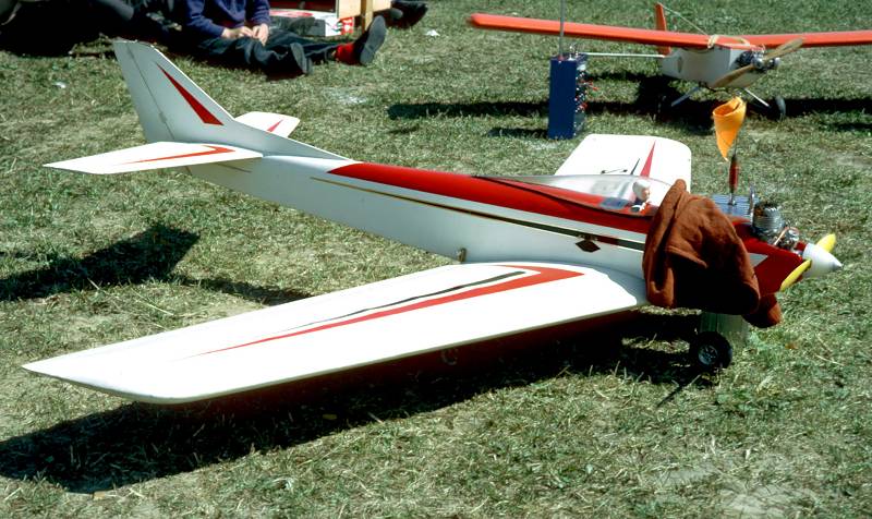

Phoenix 1 was published by RCM. Was kitted with fiberglass fuselage, but I never saw one of these kits. Originally powered by a Super Tigre .46, then a .51, then a .56 as they became available.
Phoenix 2 was a Phoenix 1 with less sweep, about 15 degrees. Not published. One built.
Phoenix 3 was somewhat larger, similar sweep as Phoenix 1 One built, not published. Airplane still exists.
Phoenix 4 was a new design, less sweep, one built, not published.

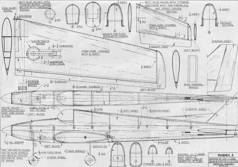

Phoenix 5 used the wing and tail from the Phoenix 4, more side area for knife edge, published by American Modeler magazine. Kitted with fiberglass fuselage, foam wing by numerous people. Also a 40 sized version was kitted with a fiberglass fuselage. TONS of these were built. Wing Manufacturing has the molds and is kitting them.
Phoenix 6 was somewhat smaller. Was kitted with a fiberglass fuselage/foam wings. Kit wasn't very good, and was heavy.
Phoenix 7 was a very minor departure from the Phoenix 6, primarily done for another fiberglass kit seller for something different. High quality kits produced by Joe Bridi, but sold under another name.
Phoenix 8 was somewhat larger. Kits allegedly still available from PAC, but haven't tried to get one. I know the molds exist.
Phoenix 9 was a departure from previous thinking and designed for turnaround pattern. Swept leading edge, straight trailing edge. Larger overall, two piece wing, specifically designed for a muffled tuned pipe. The late Bob Godfrey (of TOC fame) built some of them up for various people. I have one, with an OS .61 RFP ABC, and pipe. Not published.
Phoenix 10 was essentially a Phoenix 9 with a longer fuselage (2 inches?). One built with a Hanno .61. Plane still exists. Last in the series.

I had a Phoenix 6 1/2. It was a Phoenix 6 with the horizontal stab repositioned to reduce (eliminate) some roll coupling. I loved that model. It had the sexiest lines and flew extremely well. It died an ignoble death, had a retract failure and the model went off the runway and hit a post. I had just purchased a Phoenix 8 so I never rebuilt it. I wish I had it now and would install a YS 91 with muffler.

I had a Phoenix 6 in the early '80s.
I bought it from a fellow club member in SE Texas when I couldn't get an 8. Seemed they were always out of stock or backordered. I thought the 8 was the most graceful looking of it's time. Plus I loved the name Phoenix. I had a logo all designed to have on an 8 but I never got one. The 6 I had used a gel coated fuselage. It had a "hook" in the tail I didn't recognize until I had built and flown it. I had 100's of flights on the plane when I lost it hotdogging at practice for a contest the night before. I really enjoyed the plane.

I had the P-5 cut my teeth in pattern on it. Great flying airplane but I was to hyper to sit and really practice for pattern in my teens.
You did forget one model though. The Funex, it was a 049 pheonix with fiberglass fuse and foam cores. Flew great on a OS 10fsr

I found the article in American Aircraft Modeler magazine on the Phoenix 5. It describes the differences in models up to the 5 in the series.
