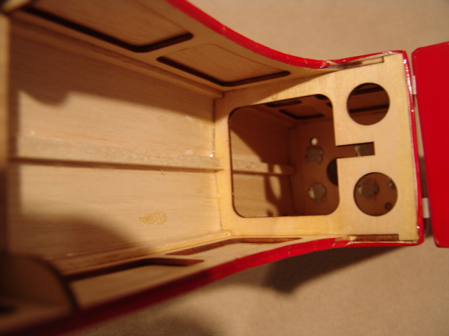

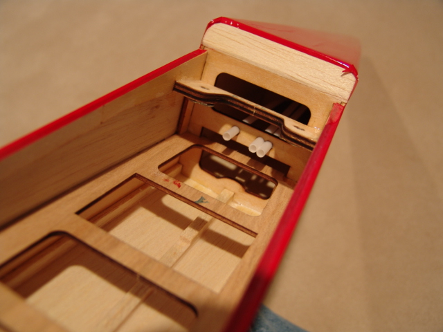

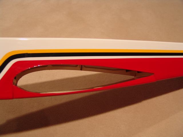

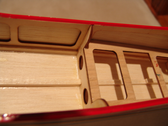

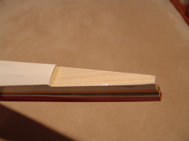

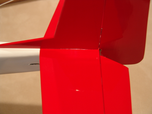

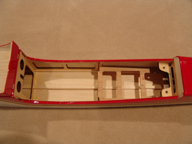

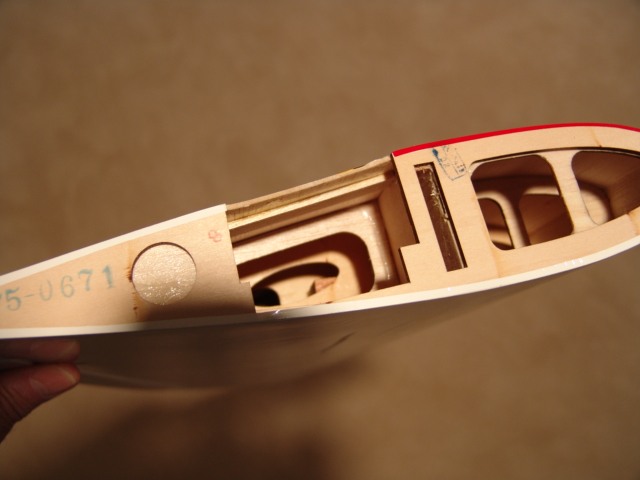

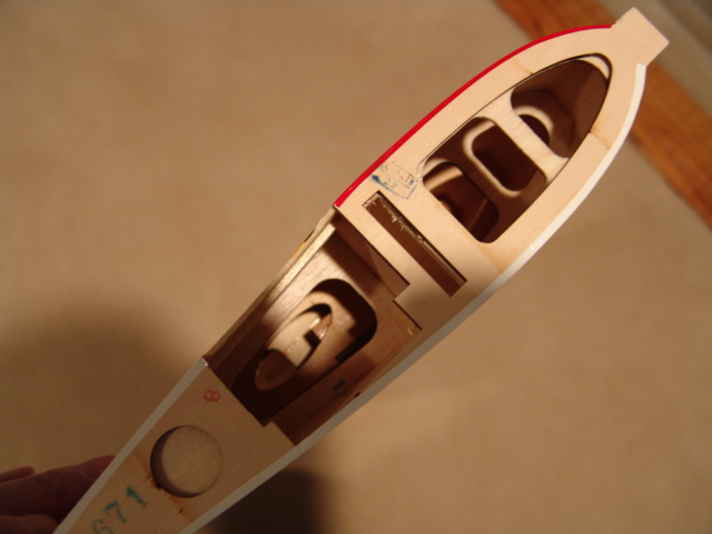

Recently a Tower Kaos 40 ARF showed up at my doorstep! I have no clue why an ARF would be on my doorstep but it looked forlorn sitting there in the rain and I decided to take it in for safe keeping. While I have it, I thought it would be interesting to compare it to my modified kit built Koas 40, my NIB un-built kit and the old Tower MonoKote covered Kaos 40 ARF.
The first thing I noticed is that it is covered with some type of heat shrink covering that looks OK but is not as shinny as MonoKote. It has a few wrinkles that are typical with ARFs.
The distance from front of the wing to the nose the fuselage is slightly less than the MonoKote ARF and kit. The firewall also has built in right thrust and the front of the fuselage now has a U shaped brace in front. I’m not a big fan of right thrust. The motor mount is now a single piece metal unit rather than the two piece plastic unit used in the MonoKote ARF and kit. The shorter nose should help solve tail ballast weight that the MonoKote ARF required.
The red and white parts are the new ARF, the purple and white is the MonoKote ARF and the red, yellow, blue and white is the modified kit.

Two more! The covering needs some trim work around the engine bay!

It also looks like it needs some fuel proofing on the ends of the square stock protruding past the firewall.
The original Super Kaos Jr. plans did not have a full belly pan under the wing. I bought a copy of the RCM plans this last July. Was debating about purchasing this arf. Bought a Bridiairplanes Utter Chaos for $65.00. "Money-kote" at the LHS is $20.00 a roll. Might need three rolls if I want a choice of colours. The price of the arf is looking a like a better investment. By the time i'm done with engine mount, fuel tank, and covering it should run me about $170.00 CAD to complete. The tower koas might run me with shipping, Canadian 7% pst (provincial sales tax) and 7% gst (goods & services tax) about $150.00. Yes our health care is free, but we pay for it in other ways.

Looks like it. I like to trim the covering and then paint the engine bay with epoxy and seal the edges of the covering around the bay as well.

After looking at it again, I see that all of the engine bay, including the square stock is coated. I keep putting all back in the box in case the owner of it shows up. It would be embarrassing to have it spread out all over the house and have the owner show up. If they don’t show up soon I may just snap it together and fly the darn thing.

The belly pan could use some additional reinforcement of thicker sheet material behind the balsa. If the bolts are tightened too much you could crack the belly pan at the bolt holes. The original kaos had this carved out of 1/4" sheet.
ORIGINAL: 8178
The fuselage has a slight rounded shape on top that is accomplished by using sheeting rather than the solid balsa plank that was used on the MonoKote ARF and kit. There is a frame work to support the sheeting. The belly pan is now a separate single piece rather than the ill fitting two piece pan that was pre-attached to the wings on the MonoKote ARF.
