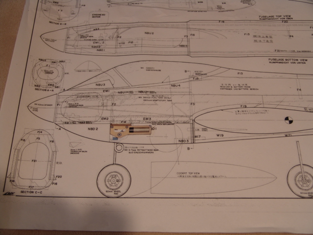

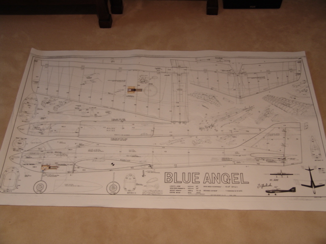

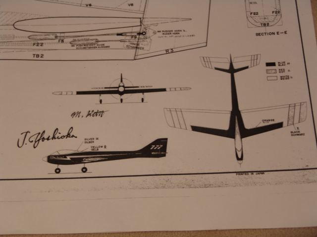

My benefactor with the MK plans sent me the plans. The good news is that the plans arrived in great shape but the bad news is that they do not have drawings of the root and tip airfoil for the wing and horizontal stab needed to make the foam wing templates. So I’ve contacted him and I’m waiting to see if he will be willing to trace the ribs I need.
View of the plans. Because the fuselage has so many compound curves the construction is very complicated but the beauty of the design is stunning.
To be continued…

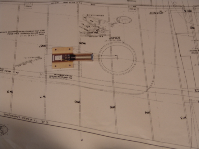

I pulled some images of the Spring Air retracts from their website then scaled them and printed them to use as templates to check their fit. I want to make sure I order correct type for the Blue Angel. I’m going to use the Spring Airs because they are the best quality and their service is absolutely super. I’ll get my Spring Air order in on Monday.
I will need to use a slightly smaller nose wheel to clear the back of the retract unit.

Those plans are a work of art. The Japanese aesthetic sensibility, even when it comes to utilitarian things like mechanical drawings, never ceases to amaze me.
Oh, and the plane itself is magnificent. Great taste 8178.
