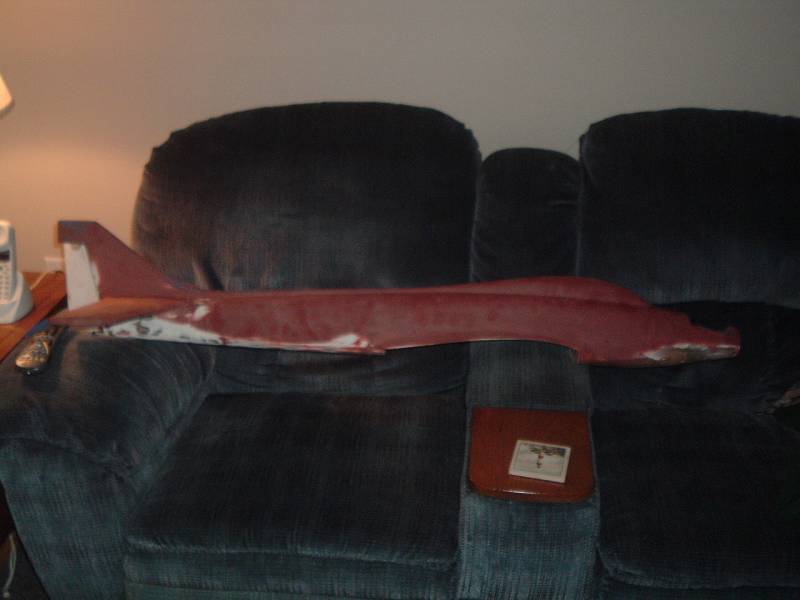

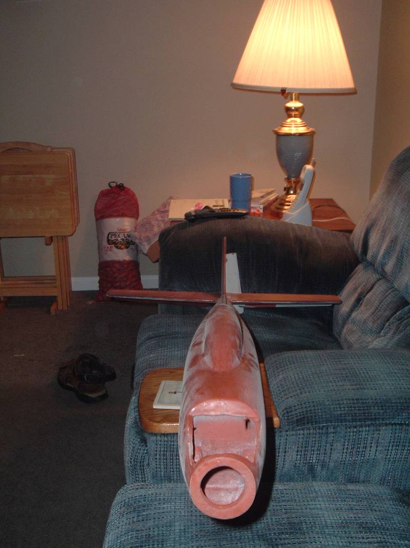

After a very, very long time out of the hobby, I have decided to get my feet wet again. Back in the day... <chuckle> way back.... I flew Mach I's.... retracts and Webra speed. Well, I know times have changed, but I'm thinking of building a couple of these to compete in SPA. I know they are legal, but I'm wondering how much leeway I have with the design? As much as I like the trike gears and retracts, I understand that I have to leave them out to fly. Also, my local fields are all grass now and small wheels, retracts and grass aren't always the best of friends. Can I make the Mach I a taildragger and still be legal? I'm thinking that with the new light building technology (vac bag wings, etc.) that I might be able to keep the weight down enough to use one of my old Webra's. Thoughts???
I've attached a picture of a pair of Mach I's that my dad and I flew back in the 70's
If you haven't flown one of these monsters before.... Hmmmmm they give the term 'On Rails' a whole new meaning...
I'm also considering scaling this bird up to 2M and try my hand at the new pattern.. <Mad Scientist chuckle>

Yes, the MACH 1 (Norm Page design) would be a good SPA bird....(loved your photos you included of your and Dad's).
Sure, you may build as a taildragger, Most of them on the circuit are TD's now what with the "taxi-to-the-hanger" no
longer in the patterns, no need to haul around a nose gear and maybe another servo. Just a good 5/32nd wire gear
toward the Leading edge and a good steerable tail wheel will do the job. That's what I use in my Daddy-Rabbits,
Phantom-1's and am now doing a building project on Chidgey's Tigertail...and will use that setup. As far as mods go,
just keep it looking like the plans called for originally, our Board realizes most of them nowadays are lengthened in
the aft section to accomodate the heavier engines (mostly 4 S O.S. 90's) so a modeler doesn't have to load down
the fuse rear with a bunch of ugly lead. Lengthen it some, if you'd like, just keep it moderate and looking much like
the original. If you use your Webra .60, you probably want to stick to Norm's original specs...and with some good
light balsa you'll come in at a very respectable weight.

Cool photo Dave! SPA has a 10% design change rule. Yes you can use conventional landing gear. There are several SPA members here in Central Florida and we have talked about getting together in Ocala to fly, just fun stuff to start and get to know each other. The Mach I was a great design from Norm Page whom I met while living on Chicago's south side, there use to be pattern contests at SAC field which was about 15 miles from my home.
A two meter Mach I would be interesting! I am in the process of enlarging three old pattern designs in hopes of making them fly a little better -- kind of a tweener from old school pattern and the new two meter ships. These would qualify in the Novice SPA competition only where there are no regulations on design or engine size.
