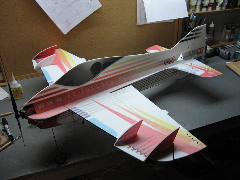

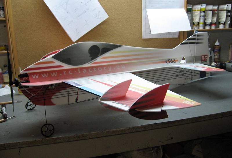

    RE: Aurora 60 Build Thread - Electric Power
    ORIGINAL: Bootalini
    For those wondering, I've not completely abandoned my project. Work and other competing interests have made it difficult. The radio installation and retract rigging is pretty much done and I'll be taking everything out soon so I can continue with applying the finish. I anticipate good progress between now and the end of the X-Mas holiday.
    As an aside, any of you following the indoor pattern F3P stuff?.....it looks plenty challenging and fun. I just purchased a 'Clik' pattern foamy and will be flying this winter with the indoor crowd here in Ottawa.
    Jeff
    Nice installation on your Aurora. Yup, the Clik is one of the hot F3P planes at the moment.
    Tom
