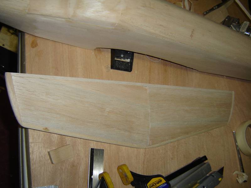

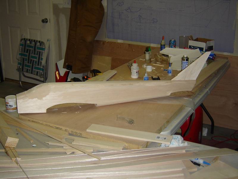

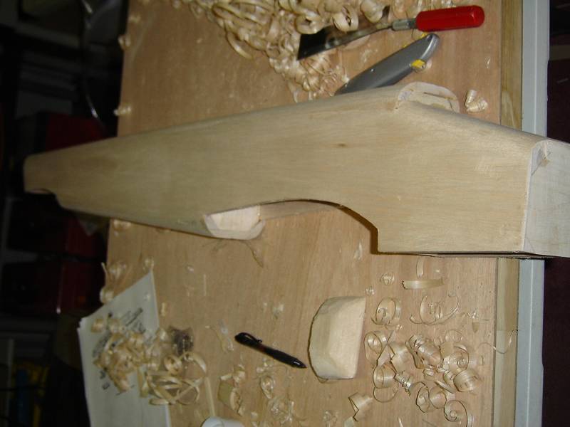

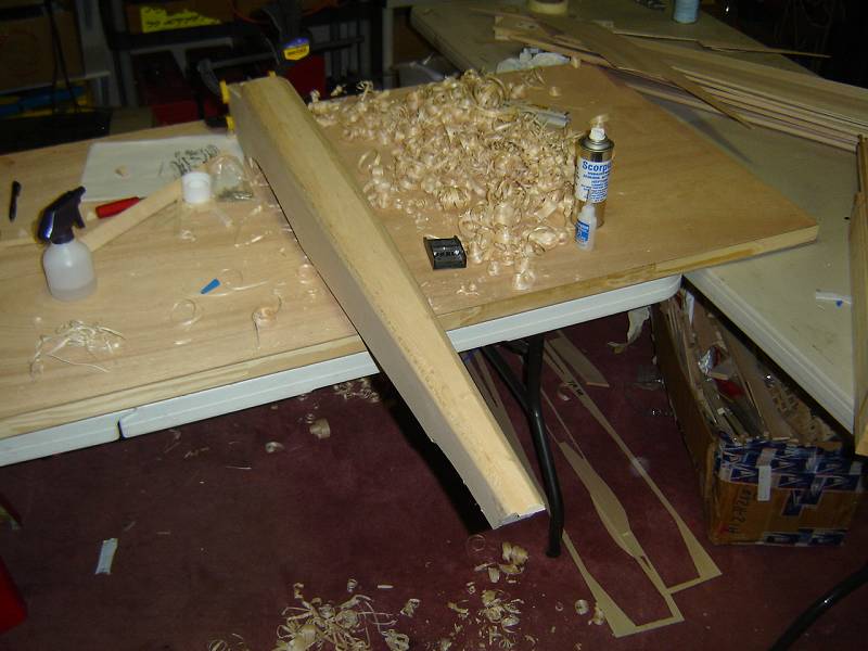

AHHHHH. I had forgotten how enjoyable sanding can be. What you see here is two days progress. About 9 hours total build time. The fuselage is taking shape, but is nowhere near final. The canopy section is going to be fun trying to figure out.

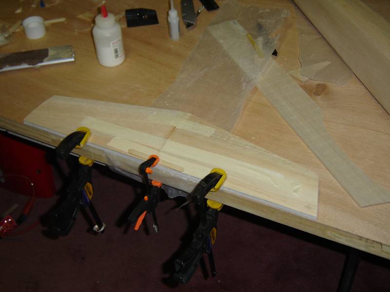

I have the sheeting on the stab foam cores sitting overnight. I use Gorilla Glue.
A really satisfying and fun project so far.

Go to your plans and make some templates from the bulkhead sections. They will help determine how much material to remove in curving the top side. It's quite a bit as you can see in this picture. The top will wind up virtually round.

That pic is a big help! I couldnt figure out how the canopy area was to work.

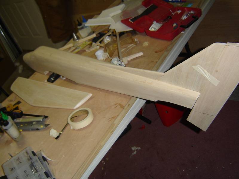

OK, tonight I made some pretty good progress. I figured out what I wanted to do with the canopy area and finished that (balsa filler is my friend). I also rounded the fuselage as "stripes" suggested (thanks). I trimmed up the stabs and they are gluing together as we speak. Should be able to cap them tomorrow. Lastly, I made my fin. I'm not sure I will have the dorsal run all the way to the canopy as the plans suggest as this plane is stretched and we are working with an unknown. Besides, more chance for me to screw up! hehe
So far so good!
Dave

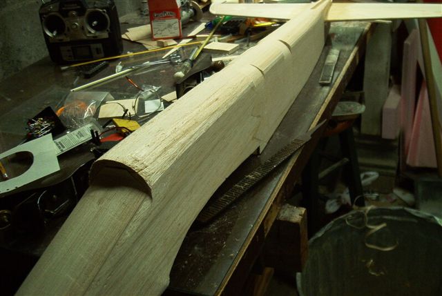

Well yesterday I finished the nose section and got the stabilizer almost finished. I'll do some final shaping after I cut the elevators. The engine is angled so the tuned pipe will run down the belly of the plane. The fin and dorsal are done but not mounted. Rudder still remains to be shaped. I won't be able to avoid the wings much longer!
Dave

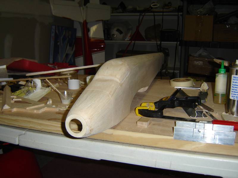

Well, back to work I go... Got the foam cores out today and cut the servo wells. Going to use one per aileron. Big dissapointment here... I'm going to use a set of fixed gear. The retracts I have a too big and heavy for this bird.
The picture shows the wing skins being assembled. After they are dry, I'll sand them and glue them to the foam cores..

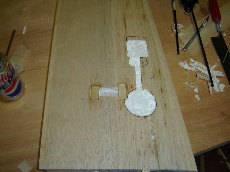

Oh, alright. I found a mounting method in the instruction booklet for my Robart retracts that doesn't need a false rib. So, I can start cutting!
Here's what I did so far. I cut out the shape, then I'll use a hot wire to cut the wells out of the foam. The ply mounting "horse shoe" will have dowels extending through the foam and ending up against the top wing sheeting. I'll run some carbon fiber strips along the bottom wing sheeting to beef up the now weakened structure.
this thing may weigh ten pounds, but it will be a screamer, eh?

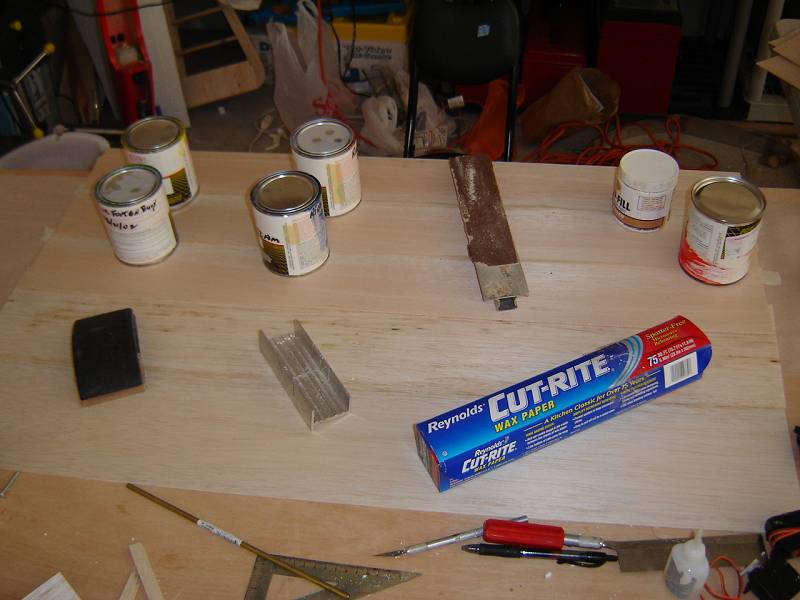

This is a Field & Bench review of the Airborne Associates kit you may find interesting.
Ray
