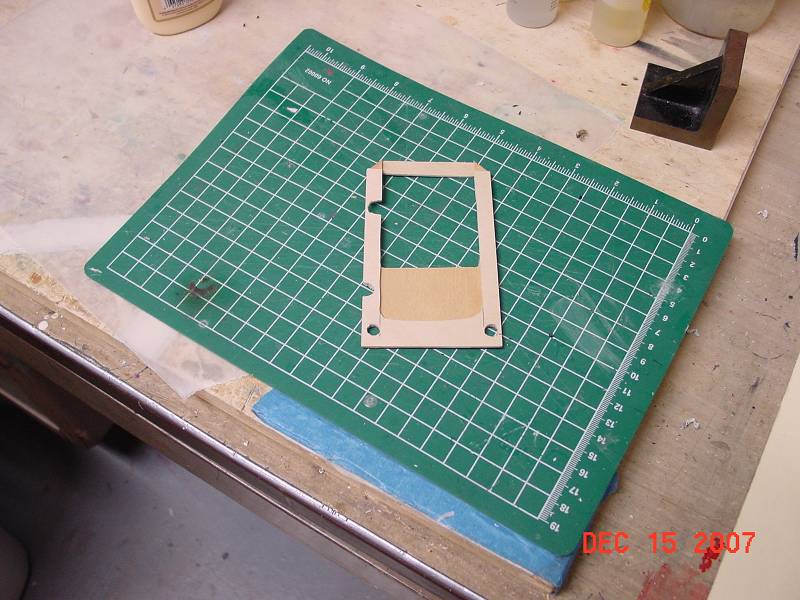

The epoxy thrust wedge popped out just fine. Now I have to sand off the meniscus that formed around the edge.
FYI - http://en.wikipedia.org/wiki/Meniscus

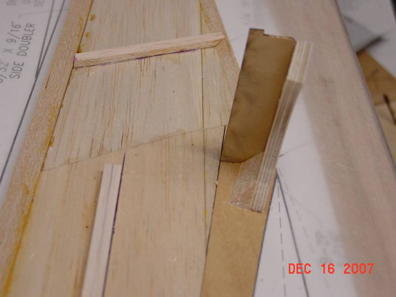

Progress, no matter how small..........
Yes, try to do something all the time, even if it is just a little. Here's the epoxy thrust wedge, came out fantastic. Free Bird, I still want those wedges, in case I have to make adjustments. Doesn't look like much, but it is a solid two degrees of downthrust. I put an indent mark at the low point, it came out in the cast perfectly.

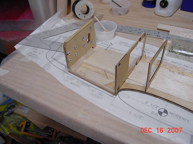

Now the Firewall. It is without a doubt an important piece of a plane. Notice the 8 holes, 4 for the motor mount, 4 for the nosegear mount. I also trimmed the epoxy thrust wedge, added the cut-out for the fuel tubing (I know it's not straight, it doesn't have to be)
And yes, Bob, there's the ring of plywood for behind the spinner.
I consider this part of building the PITA phase (Pain In The A**)

Fuelproofing the firewall is a serious business.
I make sure I have every hole and access finished, then coat it in 20-minute thin epoxy all over. Since you have to hold it, it is a two-step process. I even coat the inside of the holes before I put in the blind nuts. Load the hole up, then stick a toothpick in there, swish it around, and wipe up the excess. Paint both sides and all the edges, then wipe them down lightly with a paper towel. This makes a super thin coating that is absolutely fuelproof. In the past, I have seen the screw holes be the point of failure because they are not fuel-proofed. BTW, after you put in the blind nuts, give their piercings a dab of epoxy, too.
Details, details.
Details, details.

So far today I have epoxied the other half of the firewall, and made the rear wing hold-down. After looking at that 1/16 TE former, I decided that it is adequate, so long as I tie my 1/4 ply firmly to the ply wing doubler. The best way, which I used to use in the past, is to use tri-stock. I glued the ply with thick CA, so I could position it with my fingers, but the tri-stock is done with titebond. Notice I left about 1/16 inset on the plate. This is to allow for the wing center F'glas tape.
I will tap the ply itself for the 1/4-20 bolts.

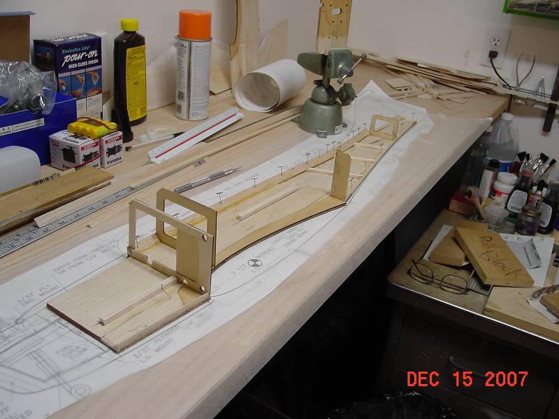

Today's small progress:
Moment of truth - Time to tie the aft end together. The photo doesn't show well, but the fuse is laid upside down on the top view, and the firewall and front sides lined up to the plan. then I pinned the front end. I pulled the back end together, and held it with a couple of clothespins. It was off center. Remove, adjust, replace. Repeat. Now it is centered. Look carefully from all angles, measure as best as you can, then hold your breath and put a drop or two of CA in the joint. Pray. Cross fingers. Cross toes. Take shallow breaths.
I THINK IT'S STRAIGHT (cue for applause, streamers and confetti, champagne cork pops in the background)
Phew! OK, now to insure it doesn't move, quickly put some of the bottom sheeting in place.
More to come tomorrow. Or the next day.
