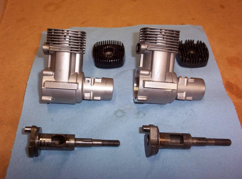

LS= Long Stroke
R= Rear Exhaust
AR= Short for: arrrrrr... Get out of my Way
(Actually..The YS 61R AR was a Hopped up version of the YS 61R LS....Kinda like the OS RF-P and the RF-P Hanno Special)
ST= I'm not exactly sure what that stands for...But the ST-2 engine is a current Hecolopter engine (I think is still being manufactured??)...It's not a Pattern Aircraft engine...
This may help?? I posted this a week or so ago in another forum in response to a question:
ORIGINAL: ELI Kats
I would like to understand the YS-61 variants that were used in the 90's.
What is the differense differense between the YS-61 R/AR/FR (YS0090 and YS0091)
Eli
Ha...Just so happens I have a couple of basket cases taken apart so you may be able to see some of the differences a bit easier...(Photos Below)...Now I'm not an expert on these...I'm still studying and learning as I go with these engines...I think there are allot of guys who flew these in the 90's who may have some better info than I...I'm kinda going off what I have learned thusfar and don't have allot of past experience to speak from...So if I get something wrong...You Old School Guys feel free to correct me!!
In the "Parts" photos...The AR stuff is on the left...The Std LS stuff is on the right...
Pic 1: You see some pretty noticeable design difference in the AR's Piston & Liner vs the std LS...The AR's piston liner is Aluminum (AAC) and is allot lighter than the std LS which is an ABC piston/liner...
Pic 2: If you look very closely you will notice there are some differences in the crank...The AR crank has a couple of shims placed aft of the rear bearing land...Those shims ride inside a brass collar seen in the next photo...Apparently this was designed to aid in fuel delivery...The "Intake Porting" is different also...I believe timing is a little different too...You will also notice in the AR case has a hole just below carburetor which is for oiling the rear bearing for storage...And the AR has a machined head vs the LS's cast aluminum head...
Pic 3: A look at the "Brass Sleeve" which is mentioned above...
Pic 4 thru 6: You'll notice the engines look very similar externally...The difference in the heads and oil plug are about the only noticeable external differences between them...
The performance difference between the LS and the AR is similar to the differences between the standard OS RF-P and the OS RF-P "Hanno Special"...
Designed to run Tuned Pipes (Hatori 650)...
The LS makes it's power while turning a little higher RPM...About 11,500 on a 12x8 is what I have read the guys were running "Back in the Day"...A 12x10 is about tops on the std LS...Mine are turning 10,800 on a 12x10 on my test stand...Very similar to the OS RF-P...
The AR is kinda like the Hanno...It is designed to turn less RPM's and will swing a bigger prop...I'm still learning all this too...But I'm planning on running the AR on a 12x12 or a 12.5x12 and shooting for just under 10k RPM's...My Hanno's are turning 10,300 on a 12x12 APC prop on the test stand...I expect the AR will be right there too...So I'd like to tweek them closer to 9500 RPM...Which is apparently the "sweet spot"...
