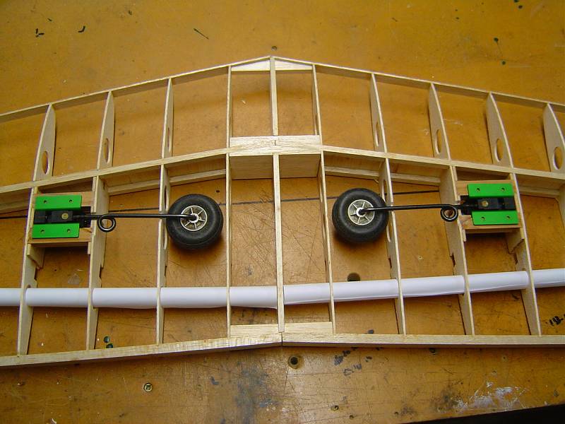

Hello Everyone.

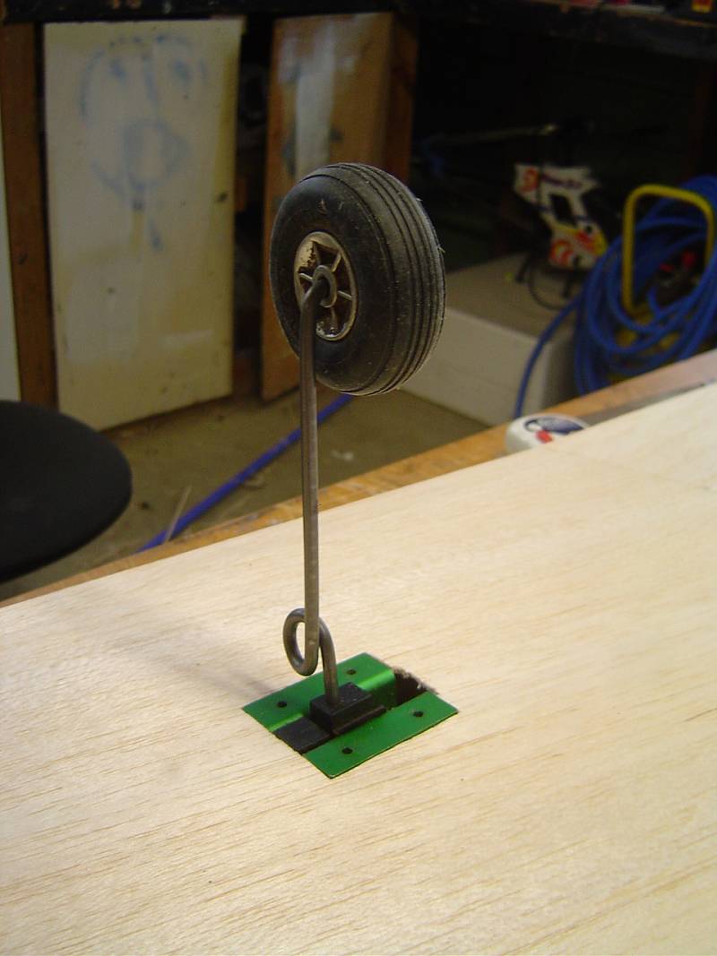

I have made new undercarriage bearers to suit my retracts. I used the front and back edges of the cutouts in the ply as a starting point and made the cutouts larger from there. I then trial fitted the retracts and needed to notch the bearers to allow room for the pivot pin and spring coil.
Then I glued them in making sure to get the ply parts as tight as possible to the spars.
Cheers
Tarquin

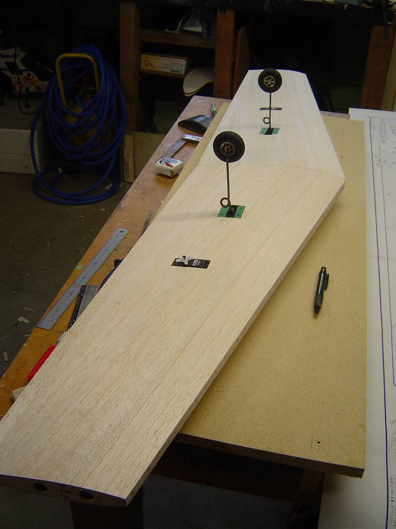

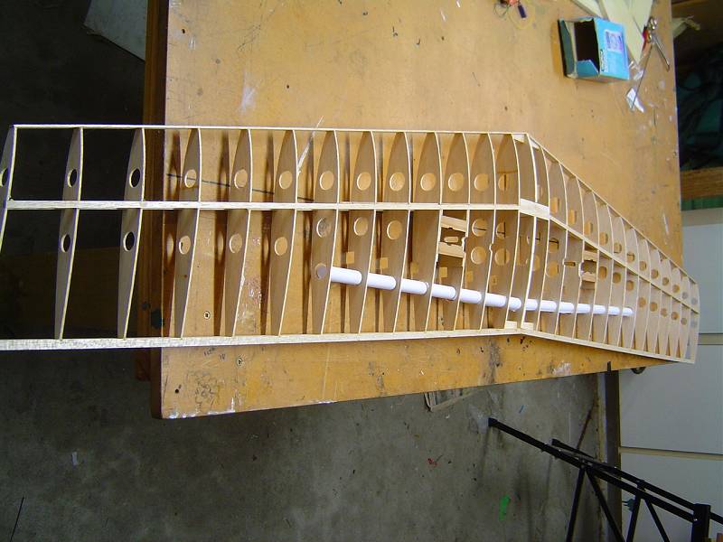

Hello Everyone
Work on the beetle has been really slow lately. I keep getting distracted by other things: everything from 1/2a to giant ugly sticks.
Since you saw photos last time the wings have been joined. It took hours of measuring and set up for a short glue job. I'ld rather spend 2 hours getting it right than 2 hours trying to fix a screw up!
I have to complete the retract actuation install and then onto sheeting. I am not looking forward to putting the sheeting on as I don't want to build a warp in. On the plus side though when the wings are sheeted I can pose it the plane on its three legs to get inspired.
Cheers
Tarquin

#56
My Feedback: (121)
RE: MK Beetle Build
Hi Tarquin - looks great so far!
This is a little late (for this build), but I sheet the top of built-up wings (MK kits) before joining them. This adds a significant amount of ridgidity. I then jig the two halves; joiin them and add the bottom sheeting while the wings are jigged. I also add the fiberglass center section reinforcement. When that has cured I can take the wing off the jig, flip it and add the top fiberglassing. This method has worked for me for many wings.
I would carefully jig your assembled wing then add sheeting (top or bottom depending on how you jigged it). At the current stage, the wing is quite delicate as I'm sure you are aware. when completed it is very strong and light!
Keep us posted - very enjoyable!!
-Will B.
-Will B.

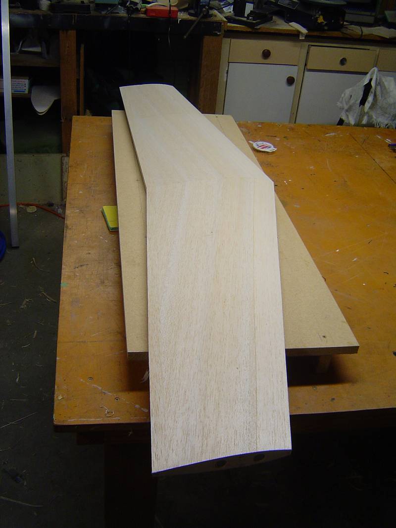

RE: MK Beetle Build

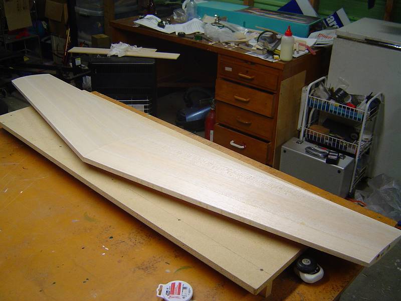

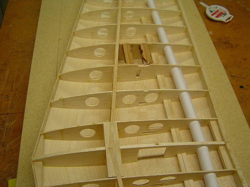

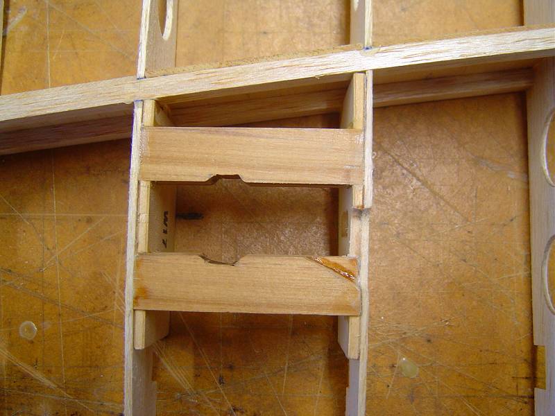

Hello Everyone
It has been a while since I posted but there has been some progress.
The ribs have been adjusted to allow the push pull rods for the retracts through.
I have skinned the top surfaces using aliphatic glue and heaps of pins. In this kit the skin pieces are pre-glued together to form four complete sheets. I felt that this would make using CA very difficult to get a good reliable result. You may note that I filled in the square cutouts of the inner ribs with balsa (originally for servo wires). This sub-spar helped keep the correct shape in the fairly large open areas of the inner ribs.
Cheers
Tarquin

Hello Doxilia
The build is progressing... just slowly.
The second bottom skin went on tonight so the wings are all wrapped up. It was not something I was looking forward to as once the glue goes down there is no turning back. I also wanted to make real sure everything was in the wing before the skins went on.
The next thing to go in are the wheel wells and then the trailing egde stuff, ailerons and tips.
Did the beetle go for US$500? I think I only paid $545 singapore (around US$350). I think Singapore Hobbies had one on the shelf last time I was there.
Cheers

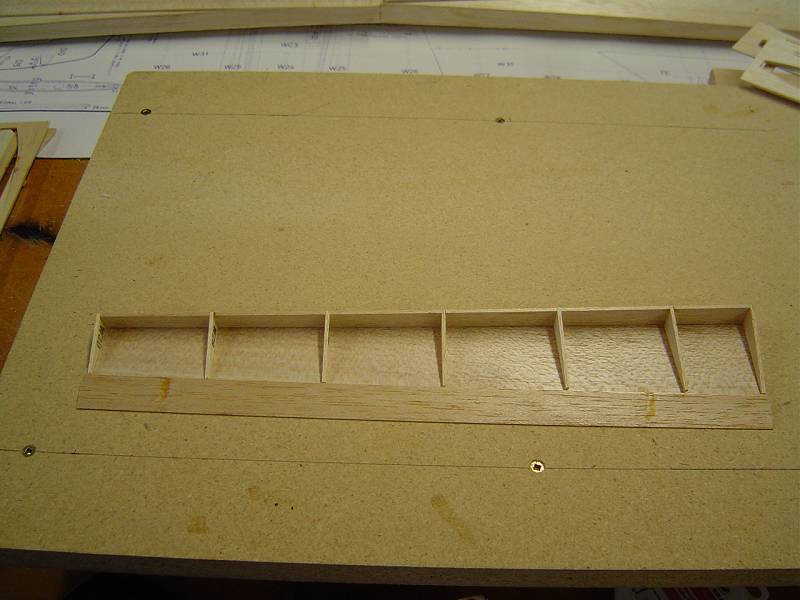

Hello Everyone
Cees
sorry, I didn't see your reply till just now.
I had planned to do the wheel wells before putting on the bottom sheeting as you suggest. On the plans it shows the well partially taking out one rib rather than being right between two. Before noticing this I bent the wire legs to sit between the ribs but then found that it sits decidely nose down when on the wheels. I will have to make new wire legs. With that said I decided to do as MK show on the plans and put the wells in after bottom sheeting.
I have cut the openings for the two aileron servos and the baasic retract area.

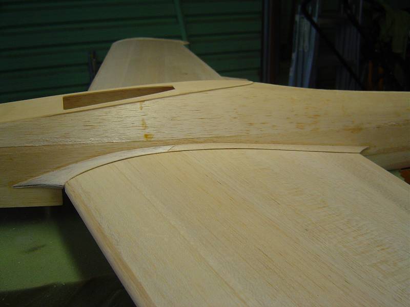

Posts: 158
RE: MK Beetle Build

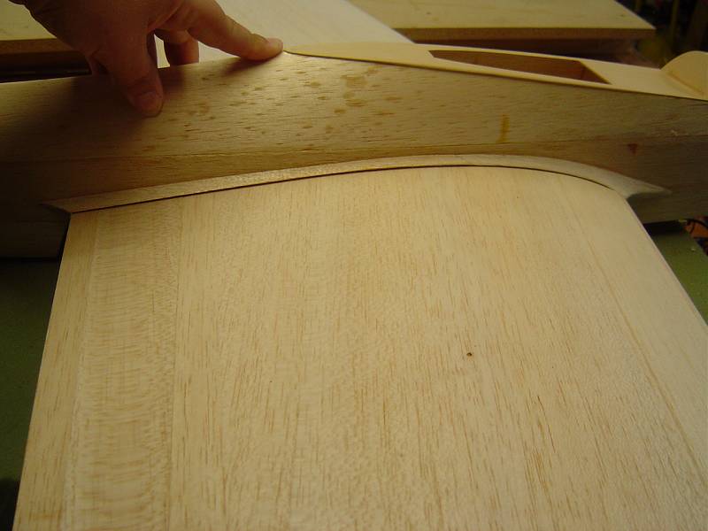

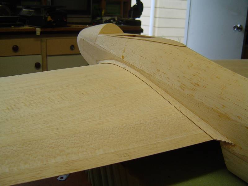

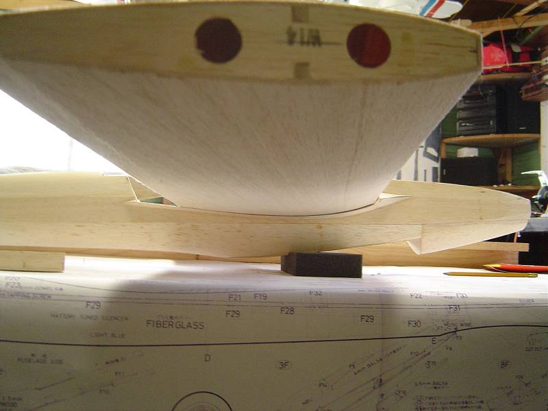

Hello
Here are a couple of photos to show where I am up to.
I am trying to get the wing to fit the saddle as best I can. Right now it fits OK when it is pushed back by about 1/4". That means that the trailing edge would need to be notched. It may also have an affect on incidence. I will use plasticene between the wing root and saddle to show where it is high and low and then sand to get best fit before using micro balloon type filler.
Cheers
Tarquin

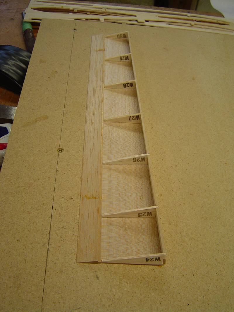

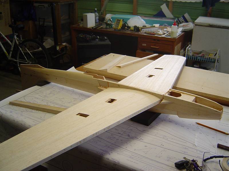

Hello Everyone
There is still some life in southern hemisphere. Work projects have gotten in the way of toy planes.
Since the last update I have glued on the leading and trailing edges and the tip sections. The rest of my time in the shed has gone into getting the saddle fit right. The left side is fitting fairly well but the right side has a gap still. I have to be a little careful to keep the wing square to the fin - a fraction of an inch at the root moves the tip a lot. Also the underside of the leading edge fairing will probably need to be built up slightly.
Cheers
Tarquin

Hello Gimsace
The Beetle is pretty much in the same state as you see it in the photos. Work and personal commitments have taken me away from the shed. That combined with winter and a cold shed... ah, excuses, excuses... I should just take a concrete pill.
I did spend a little time working on the wing fit the other week. I was quite happy with the fit and the measures for level and square looked ok - maybe a bit out. I glued the front former with the wing dowels in. When the wing was all set in place to set overnight I had another look and something just didn't seem right, so I grabbed the tailplanes fitted them together and eyeballed them with the wing and it was way out. Doh. I checked the squareness of the tailplanes to the fin and they were fine. The thought crossed my mind that I should pack the wing until it was aligned with the tail and then fill the gap later. The it occured to me that shortcuts always result in the longer path! Off with the wing and clean the glue off. [:@] The only thing left was to go inside and have a beer.
I promise I will get back to building so long as people keep on my case.
Cheers
Tarquin
