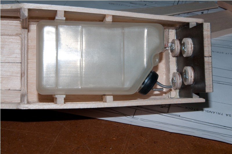

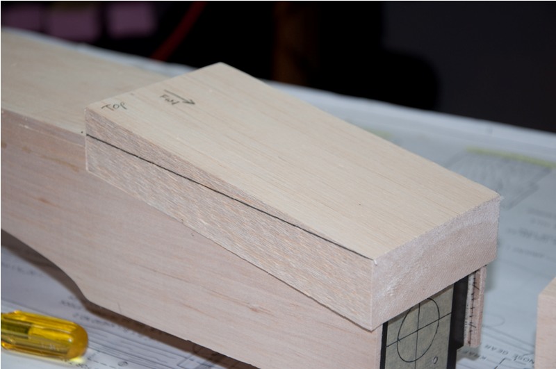

I got to make some progress on the front of the fuselage today. After marking up the huge block and making my plan of attack, it took me about an hour to to whittle this thing down to size. I started with the coping saw, then went to the power planer. A trip to the band saw. . . flip it over and begin making a cloud of balsa dust with my Dremel in router mode. . . . then just carving out huge chunks with a big square X-acto blade . . . finish up with 80 grit glued to a piece of pink foam. While it was fun hacking into this big block of wood with all of my toys, if I had it to do over again I would just get out some 3/8" and build the top front of the fuse.. .
Yes, I went a little OCD on the inside of the tank compartment. . .

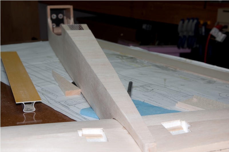

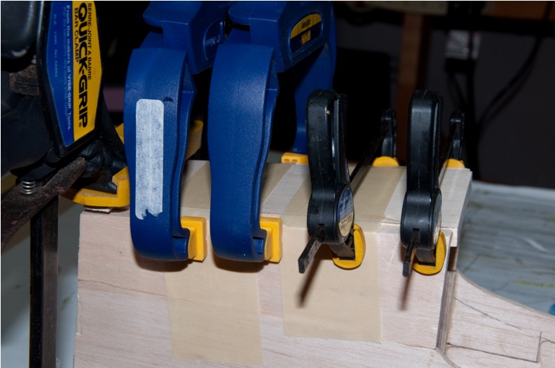

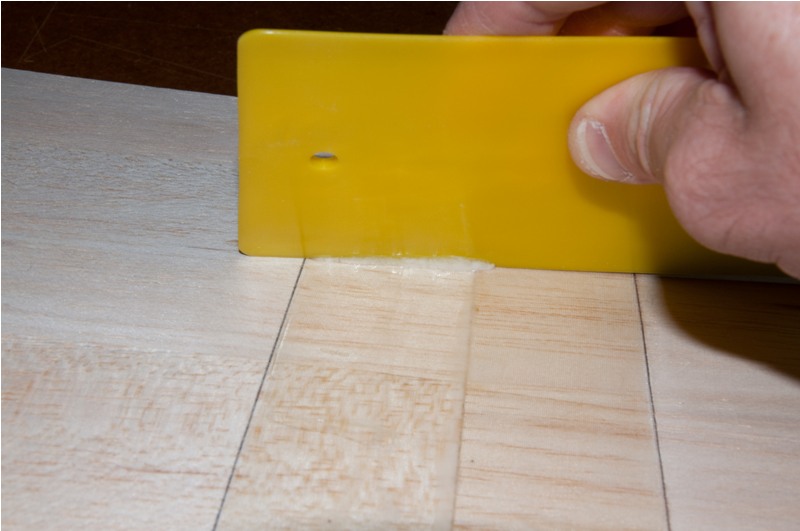

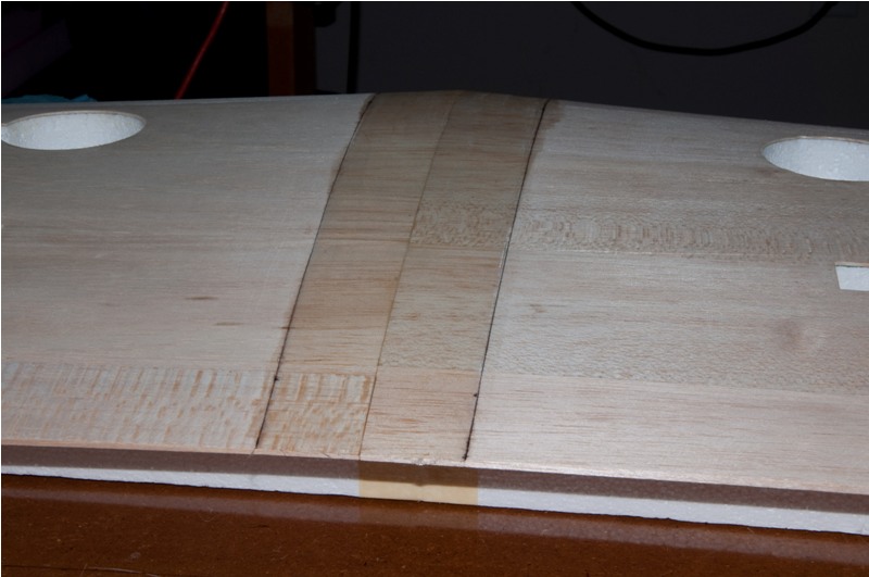

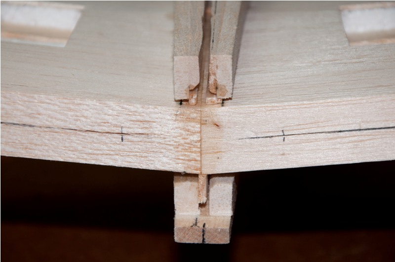

Between pictures #2 and #3 above, I was waiting for the polyurethane glue to cure. I decided to go ahead and glass the center section of the wing.

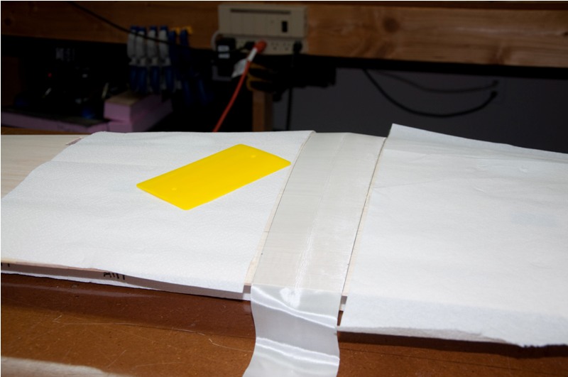

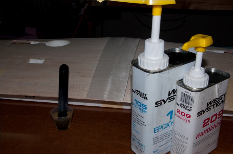

The first thing I did was mix up some epoxy and add a little acetone to get it going and thin it out. Yes, I know I got the wrong kind of hardener (209 instead of 205), I can never remember the correct number of what I got last time when ordering. I think this will work, just takes longer to cure. I then measure out and cut my fiberglass with a rotary cutter. I like the rotary cutter since it doesn't mess up the fabric. The next step I do is mask off the areas around where I'm going to apply the glass and spray a light tack coat of 3M 77 spray. I then carefully lay down the fiberglass cloth and smooth it out with the plastic scraper. This keeps the cloth in place while applying the resin and keeps any wrinkles out after I get it laid down.
Once the cloth is in place I liberally apply the resin. I make sure the glass is wet all the way thru to the wood. If your shop is cold, you can also enlist the help of your wife's hair dryer to warm it up and help it flow. Once the resin is soaked into the cloth and balsa, take your plastic scraper and carefully scrape the resin. I practiced this on a couple pieces of scrap balsa before trying it on my model. Once you get the right combination of angle, pressure, and speed, you can remove almost all of the excess resin and leave only a little that has soaked into the wood and the glass. The surface will look dry. If you work your way from the leading to trailing edge, your last glob of resin will slide right off the trailing edge and drop onto your paper towel. A little technique I use is to soak the top half of your paper towel with denatured alcohol to help wipe off your scraper and finger. I tried acetone, but it evaporated too quickly.

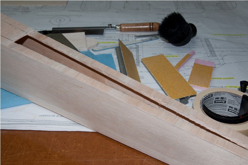

There is alot of "thick" wood on this plane that I have thinned out by using my Dremel tool with routing attachment. I've also replaced several bulkheads with composite honeycomb. If you were going to try one of these electric, you could save some serious weight in the nose by going with 1/8" lite ply for the firewall. Using fixed gear would easily save several ounces along with some of the other changes I mentioned earlier. The canopy came pretty thick and heavy, so I'm going to try to shave it down from the inside with my Dremel and cutting wheel. We'll see how well THATworks out. . . If I had the skill and equipment, the obvious choice would be to make a canopy out of carbon fibre using the supplied one as a mold. I've been trolling the composite forums. . . maybe if enough guys are interested I may take a stab at molding a few.
I edited my last post to add my current weight chart, it is the .pdf file that's hard to see below the pictures. Some of the engine components are guesstimates, but right now I'm at 6.93 pounds, before finishing. I haven't updated it in a few days and need to re-weigh and combine a few items. I'll try to get that done tonight so I can post it with today's progress.

Only got to work on the plane a couple hours today. Installed a structure to hold the tank in the nose, and then installed a couple more pieces on the nose. . .
I also updated the weight spreadsheet and attached it to this post.

I decided it was time to get the horizontal stabilizer mounted to the fuse. I began by securing the fuselage to the building table. The next step I do is to make sure that the hole in the fuse for the stab is slightly larger than the stab so I'll have some "wiggle room" while I get the stab set to zero degrees.
To get the stab perfectly square with the fuselage, insert two T-pins in the stab at symmetrical points as far away from the centerline as you can get. I used the intersection of the leading edge stock and tip block. Then find a point on the centerline of the fuselage as far away from the stab as you can get. The larger you can make this triangle, the more accurately aligned your stab will be. I tried to use the centerline of the firewall, but my measuring stick wouldn't reach, so I moved back to the wing cradle. Using a string to hold the stab in position, I adjusted the stab until the tips were equidistant from the T-pin on the fuselage.

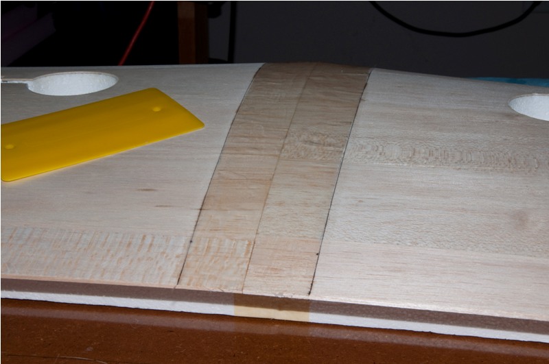

Now that I had the stab aligned perpendicular to the fuse centerline, I started to align it for zero degrees incidence. With the fuse still secured to the table, I inserted four T-pins on the centerline of the leading and trailing edges of the stab an equal distance from the centerline of the stab. I then cut up four wedges of pink foam to suspend the stab inside the hole I cut in the fuse. You want to start with the stab in a position where it doesn't touch the fuselage.
Now comes the fun part. Using some sort of measuring device, start working your way around all four T-pins making teensy-tiny little adjustments until all four pins are an equal distance from your building table surface. Assuming that your table is flat, and the fuselage is secured at 0 degrees incidence, your stab will now be perfectly aligned with the fuse. Ideally, the stab is still "floating" inside the hole you cut in the fuse.
To secure the stab permanently, take little pieces of balsa and CAREFULLY insert them inside the fuselage so they touch both the stab and fuse side. Secure the balsa with a couple drops of CA. Do this enough times so the stab is now fully secured from inside. This can look ugly since later you'll seal the gap with your favorite fillet material and they will be hidden forever. (Unless you're doing a build thread, then everyone will see them.)

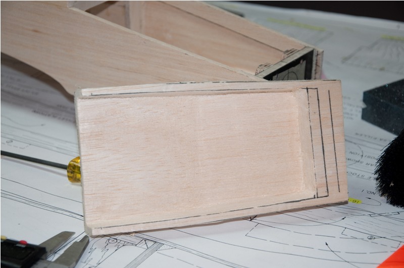

Well, its that time in every build that I realize I messed something up and need to engage in some "creative engineering". . Luckily my wife is out of town on a business trip because as a professional project manager she has an uncanny ability to detect when I have resorted to any major "project re-work". The worst part is having to document the whole incident and submit a report to her explaining how this affects the project end date and assigning blame . . . (just kidding). . .
Back whenI started, I decided to mill out alot of the parts to try to shave some weight off the plane. When I milled down the right fuselage side, I was able to leave a respectable 1/8" of wood. However, when I routered the left fuse side, somehow I managed to shave it down almost paper-thin. I have been looking at it throughout the build thinking it would be OK, but when I began taping down the bottom sheeting I realized that the side was bowing out and almost had the consistency of Monokote. In one of the pictures you can almost see the wood bowing in to finger pressure. I've been thinking about this for a couple days, to include hrrcflyer's comment, and decided that it may be a good idea to stop here and try to fix this before proceeding any further. . .
They say there are five steps to the Grieving Process. . .
The first step, of course is Denial. . . "Well, it should be OK, I have alot of planes with Monokote sides. Besides, I have already sheeted the bottom and can't get to the inside of the fuse."
Then comes Anger . . . "(~%($%#$^*()_+%##$%@%!!!!!!!!!!!!"
The next step is Negotiation . . ."I'm going to glass and paint the fuse so that will add alot of strength, right?"
After that is Depression . . . "Man, this is going to take forever, add weight, and end up being a kludge fix. . .."
The final step is Acceptance . . . "Well, its better than having to rebuild the whole thing if the tail rips off. . . where's that razor saw?"
