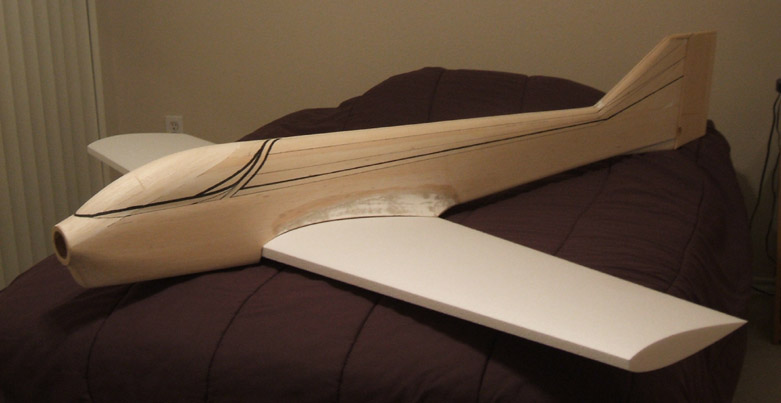

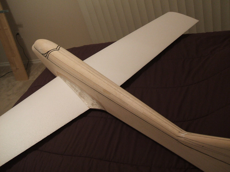

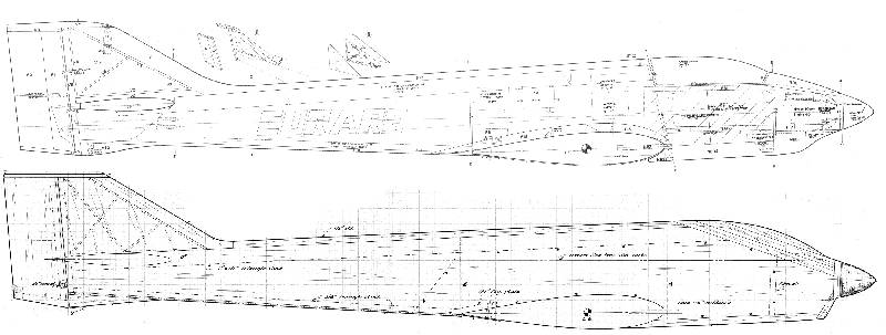

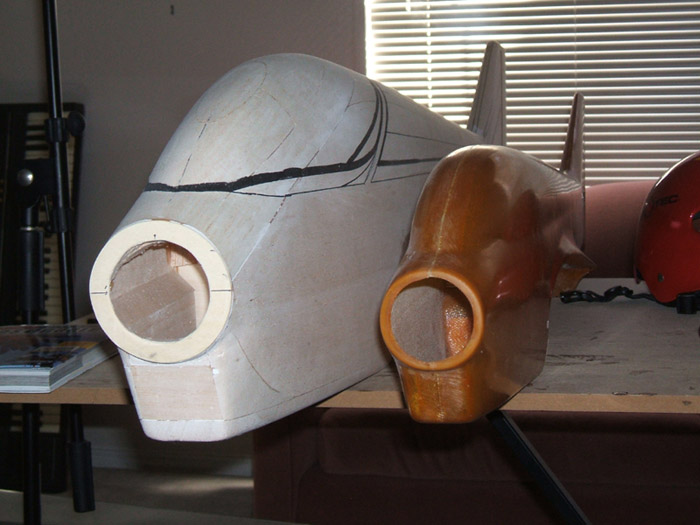

After having studied all the plans carefully (all 5 of them now), I discovered an amazing fact:
The grid size of each plan increases almost exactly (< 1/64" deviation) in 1/8" increments!
In other words, the grid size of each plan is:
1) Picorare (Tipo 10): 5/8"
2) Nanorare (Tipo 20): 6/8" = 3/4"
3) Mirare (Tipo 40): 7/8"
4) Tiporare (Tipo 60): 8/8" = 1"
5) Merare (Tipo 120): 9/8" = 1-1/8"
I'm not sure about divine intervention but that sure as heck surprised me!! [X(]
These scalings practically follow the golden rule... even though that was never the intention.
Pete,
After looking at the 120 plans I thought... what a beast! Do let me know if you get going on one of these. An OS 91FX or 120AX or even an inverted YS 120-140 would make interesting power plants.
Anyone else out there building one of these beauties in wood?
A couple of pics to provide inspiration...
David.

Right on Roguedog!
Wouldn't it be cool of all plans were laid on vellum graph paper. I had noticed the 1" grid for the 60 but I sure didn't expect all the plans to come out at even 1/8" intervals including the 120! I just said... ok, what's a good size/span/weight for a craft with this engine size? I then scaled them according to my "educated guesses". And then I measured them in turn and, bang - 1/8" steps!
Come to think of it, that might just apply in general when scaling models... I'd just have to figure out (or dig up from some good aeronautical engineering book) the relationship between power/displacement and wing span - a nice little formula of sorts. With displacement roughly doubling at 1/8" intervals what does the power curve look like?
In any case, what do you say about that Deception?
Cheers, David.

Interesting that during the scaling process it turn out right at 1/8" intervals. I know I'll be using that figure as a test bed for anything I scale in the future. When I scaled the Deception Plans I did quite a bit of research on different 20, 40, and 60 size pattern plane plans. Once I had several wing spans to work with I then simply used a little math to figure out the scaling percentage in Photoshop, .
Photoshop has a cool feature that allows you to place guides (light blue in color) a various locations. Similar to making your own grid on the plans. I used this feature extensively while scaling my plans.
It would be interesting to see the curve. But I think I'll use what's left of my mental faculties for building and customizing the planes I want to build. Hehe. Partied way too much when I was younger.
Here's a different perspective using percentages based on the Original 60 size, using your naming convention of course.
1) Picorare (Tipo 10): 5/8" = 62.5% of 60 Size
2) Nanorare (Tipo 20): 6/8" = 3/4" = 75% of 60 Size
3) Mirare (Tipo 40): 7/8" = 87.5% of 60 Size
4) Tiporare (Tipo 60): 8/8" = 1" = 100%
5) Merare (Tipo 120): 9/8" = 1-1/8" = 12.5% over Size
Did you get the original 60 size and the build article?

Roguedog,
I guess modelers minds work in similar ways. The plans in this thread were scaled just the way you describe, except that the scaling was done based on wing span rather than exact grid reduction (or increase in the case of the 120). Having said that, "almost exactly 1/8" steps" is the case (less that 2% deviation) given the following:
1) Picorare (Tipo 10): Span 40" = 61.54% (1.5% deviation from 62.5% of 60 Size)
2) Nanorare (Tipo 20): Span 48" = 73.85% (1.5% deviation from 75% of 60 Size)
3) Mirare (Tipo 40): Span 56" = 86.15% (1.5% deviation from 87.5% of 60 Size)
4) Tiporare (Tipo 60): Span 65" = 100% (< 0% deviation from the mother ship! )
5) Merare (Tipo 120): Span 72" = 110.77% (1.5% deviation from 112.5% of 60 Size)
Your percentages of course reflect the exact 1/8" steps (comment for other readers who may not be reading as closely).
Now that we've adequately dissected this issue, it certainly should be useful for general scaling of plans of the given power system range. I'm sure this is re-inventing the wheel a bit (not like it isn't done on a daily basis by designers) but it is fun to make discoveries (maybe learn a little) out of thin air without having to crack a book (did plenty of that in my youth hopefully along with a decent dose of partying as well...).
Photoshop is also usually my tool of choice for this sort of stuff. In this case I used Illustrator though as it works in vector space rather than raster space. If one is fortunate enough to start with a lossless file such as a TIFF (in some cases), a TGA, a PNG or better yet a PDF or PS file, then any scaling is possible with zero loss in quality. But those guide thingies are great! I also use them to check things like plumb lines (e.g., a fuse CL laid parallel to the paper edge) on the various structures. Another cool feature I discovered in Acrobat is the possibility of drawing measuring lines on your PDF file. This allows you to annotate between arrows things like wing span, fuse length, wheel diameter, etc. Basically anything you want. You can then optionally print these marks or not (I use them on proxy printouts but not on the full size plans).
'nough said... I should be building but too tired after this particular weekend.
BTW, I did get the Deception files and emailed you back. Hope you received my note. Many thanks once again. I now have to wait for my wood shipment but am planning on putting a 10 size Deception together with an old ST .15 for which I'll have to find an appropriate sleeve to fit an X11 RC carb into the wider throat... and hopefully find a header from Macs that will fit the engine. Although I haven't built one before (in this size at least), I think there's something cool about a baby pattern ship of sorts with all the bells & whistles. Now.... should I put a retract trike in it (there will be the purists) or shave a little weight and move my main gear forward in the wing... (there will be the convention breakers!)

Check out the "Tipo Max"... a 2M by 2M version that I had started when I had wanted to get back into AMA pattern. It went on permanent hold when I learned about the BPA.

Stiletto,
She's a real beauty! Finally, we've come across someone who's built a wood fuse per the plans! You've got to finish her, BPA or not. What is the actual scale (wing span) in inches? Did you build it for trikes or tail dragger? Retracts? What power plant did you have in mind - 2c 1.20-1.40? or 4c 1.70?
Any pictures, notes and/or tips that you could provide on the construction sequence would be much appreciated by all. Don, from Eureka, is also looking for information regarding the fin construction. Since yours is finished it will be hard to show the innards but perhaps you could enlighten with some comments. Also, any thoughts on the fin LE? Does my fin construction sequence description above sound similar to what you did?
For the front top laminations in the nose area, any comments/photos would also be helpful. My approach would be to first tack glue the two full sheets fusing into the nose ring onto the fuse top. Then, the top third sheet, pre sanded to vertical contour (the top curve), would be installed. The entire assembly, in place, would then be sanded smooth to lateral contour. When done, the 3-ply laminate would be popped off and hollowed out to provide space for the tank above the gear and engine (and to reduce weight).
Cheers, David.

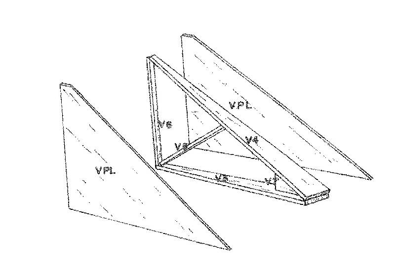

The first three pics are the Curare the last is a comparison of the Mk Curare (top) and the Model Builder Tiporare. The only real difference is the frame the MK has to make a box of the triangle. I think your best bet is to look at the Super Sicroly, MK Magic 60, and the Curare fins as these all seen to utilize what i believe your looking for. I have a MK Magic 20 and it is a similar build for it's fin as well.

I was actually imagining a OS 1.60 with the exhaust running under the wing. I always thought the exposed engine was attractive. It's built for trike gear.
The wingspan was clipped down to 78" after scaling up the fuse to 78". Supposedly the later tipos had started to evolve shorter wings. The thing still has 1180 sq in of wing area though!
The nose is really hard to carve and shape correctly. It still needs quite a bit of contouring and refinement to get where it needs to be. I started by gluing all three soft balsa sheets together right in place over the nose, then band sawing out the side contour after tracing the shape from the plans. Then it was a matter of using a long carving x-acto blade to get the rest of the rounded shapes. The side tucks aren't completely in yet, and I'm not sure how I'm going to get them to come out perfectly sharp and clean on both sides like the Great Planes fuselage.
