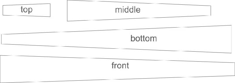

Ok, after getting some family issues up north taken care of, here are the 4 fin ribs for the .60 tipo. This is what will be in the short kit, and all but the smallest scaled down. Need to decide at what size a sanded slab is easier.
top : 1-13/16" long, 3/8" back, 1/2" front.
middle : 5.5" long, 3/8" back, 13/16" front
bottom : 8-13/16" long, 3/8" back, 1-1/16" front
front: 9" long, 1/2" top, 1-1/16" bottom
'Middle' rib is a horizontal rib centered verticaly between top and bottom.
Sizes are figured on 1/16" sheeting, and the fuse sides forced to be straight behing former 'B', as per plans. If sides are left to their own devices, 3/32" sheeting, and sanding to shape would be advisable.
Make a small triangle shaped piece where 'bottom' and 'front' join, using the plans, to help get angle right when building.
LE is made from 1" balsa as on the plans.
These fit great on the fuse I built up. Sizes take into consideration necessary bevel sanded on ends.
Hope this helps.

Yeah, I was figuring something like that for the front top also, With a canopy, so a cockpit could be cut into the foam part is desired. I wasn't doing it on the 120, but I could offer it. The 80"+ wing thing will be pretty cool. I am doing the Banshee and the Mach one along with the Tipo to start with, then who knows which other ones.
The .10 and .20 might have a slab fin, not sure about the stab yet.
I am also about done with CAD plans for the TIPO.. I'll put them up when done. That would make scaling much better. The problem that delayed the short kits was wood sizes, and their effect on fuse side size, etc. When scaled, the top blocks aren't standard sizes, nor are the tri stock, so they end up either shorter in height, (so the outline isn't to scale) or taller, and need more carving. Redoing the wood sizes, and altering the fuse side sizes to keep the ouline where it should be, is what I am doing. I hope this explanation makes sense.
I wasn't happy with simply scaling the parts, that is what delayed doing the short kits. Anything worth doing is worth doing right. I have standards to keep up.
If you have the dimensions for the other size retracts, I could include the cut blocks.
Changing the wing sizes presents more issues. When you change anything like chord or thickness, That causes the wing opening in the fues to no longer match, etc. I'd rather keep the wing the same, but lengthen it when cutting if a customer requests. I would keep the tip the same, which would slighly change the tapers when cut. Or I could leave the tapers the same, and just cut it longer, which would reduce the tip chord. All of it is easy to do with the CNC wing cutter. Changing the fuse cutout for the wing when changes are made is another story.
Oh yeah, one other thing. All of the Tipo wings and stabs will now be full foam wings, i.e.: they will extend to the TE, so the ailerons/elevators will be cut from them after sheeting, by far the best way to do it. If you want to use a standard wood TE, simlply cut off the foam you don't want before sheeting. This way it keeps tries to keep everybody happy.

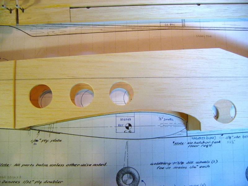

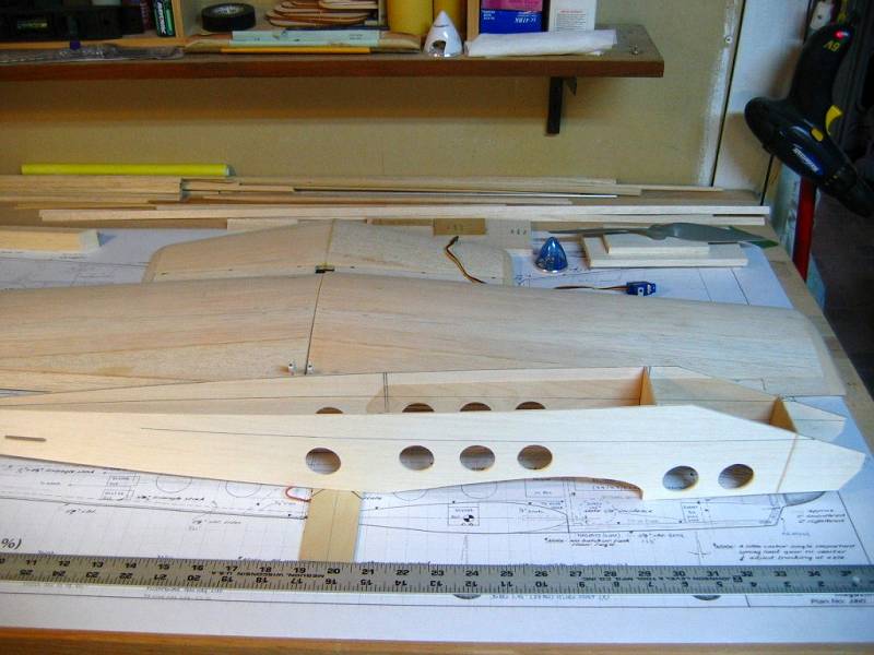

As far as the better news goes... Ifinally started on my 40" span Pico!
Alcarafa (RCU ID) was perhaps the first one to adopt this little model (that I'm aware of) and build one around a Magnum 15 with a Mac's 2.5cc TP. Acording to all comments, he really enjoyed this little rocket. Ibelieve two or three were built and flown by fellow modelers of his club. Rafa did an excellent job on the Pico, but he made some changes in the tail section (much like Mark did) making his empennage from sheet balsa (he also made a built up balsa wing). While this is perfectly acceptable at these scales, I personally like the idea of keeping to the plans and building a true mini Tipo. So,... that's exactly what I'm doing. Unfortunately, Rafa's Pico met an untimely demise due to a DX7 Tx failure. Iunderstand he's now building another one which will be electric.
Like Mark, I decided to build the Pico around a simple concept. Iwas planning on using three servos, no landing gear, a 28-35-1500 KV motor (AXI has a nice one but I'll be going a cheaper route with Dualsky - CDN$44 quoted this morning) and a 2100 3s lipo on an 8x6 or 9x5 folding prop. Power should be in the 250-300W range . I've since re-considered and may use two servos in the wing center section on torque rods to allow independed flaperon control. I may also install some landing gear blocks in the wing and a 1/2A nose gear mount on the FW in the event Idecide to put some wheels on it (unlikely).
The motor I've chosen is part of a new series of motors being produced by a number of manufacturers (Dualsky, AXI, Hyperion) intended for power gliders and small aerobatic aircraft . Note that this is a long can 28mm OD motor which complements these models perfectly as it allows the use of short standoffs and fits nicely in the nose of the Pico. More common similar powered motors are also available in the 35-30-1500 dimensions (a little heavier) but can't be fit unless the fuse is widened to around 20% from F3 forward. I've widened mine to 10% which brings the forward dimensions to a nice profile for 1.5" spinners.
Attached are a few snaps of my Pico in progress. The foam core wing and stab are finished (have to join the wing and install the servos) and weigh 1 and 5.5 oz respectively (my similar sized Deception wing w/ retracts and belly pan weighs 10 oz ). Rudder was built up per plans and fin assembly has been cut and is ready to be built once the fuse is assembled. The fuse sides have also been cut and I've lightened them where I've used 1/64" ply doublers. I'm in need of a nice piece of light 1/4"for the fuse top and bottom front sections and some tri stock to assemble the fuse. Ihave to bore out my formers as well which are made of 1/8" ply (FW) and 1/16" ply (nose ring, F2 & F3). The wing will be supported by two dowels in the front going into F2 and backed by a piece of 1/2" tri stock and two nylon screws in the back on either side of the torque rods. The canopy will be made removable on the angled front via two small dowles into the nose ring back and held down by magnets on the top 1/4" sheet at the fuse top. Servos will be laid out according to the sketch below.
Ihope you enjoy the pics and happy building!

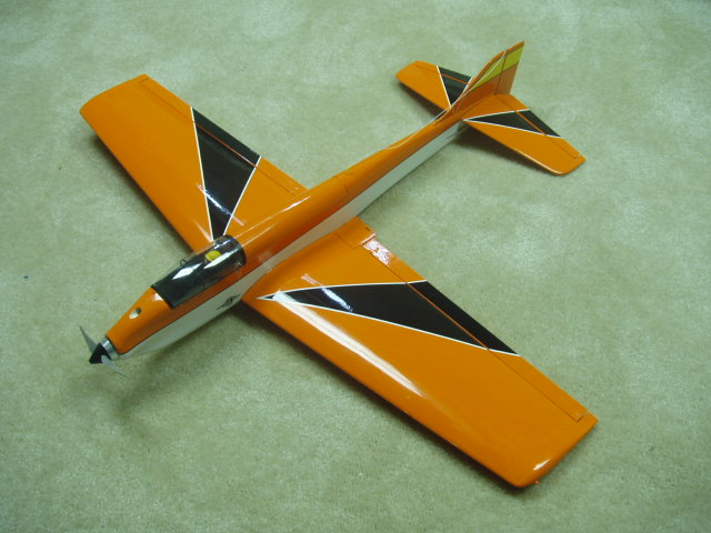

Wow that 1/2 size Curare is sharp. Could possibly make me reconsider on the Tipo. The nose is much more electric motor friendly and I wouldn't have to worry about fues tucks. What to do?? For this size model the glued on wing is the way to go for weight, strength and simplicity. But that's going to require a pretty exotic canopy / hatch for the battery on the Tipo. I was also planning a hand toss model but once I saw those micro air retracts on UH I had to try them. If I can't get them shoe horned in it was only 60 bucks. Plus the problem with no landing gear in the Phx area is you're limited to city parks and school yards (both are varying degrees of illegal depending on the local rules). All the AMA flying fields are dirt/rocks or pavement. Ouch...
Looks like you've got a good start on your Pico! Keep on it. I admire Mark's ability to stay on task... it's inspiring.
EDH

David I knew you would not resist on building a PICO soon and not finish the other projects you where working at !!!!!
Your building looks great and neat, only thing I would ' ve avoid is the lite hole behind TE, unless there is ply up to that area.
You are going to love this lil missile and will sure be amazed how well it flies, please keep posting pics and update comments.
