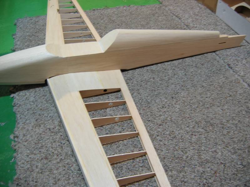

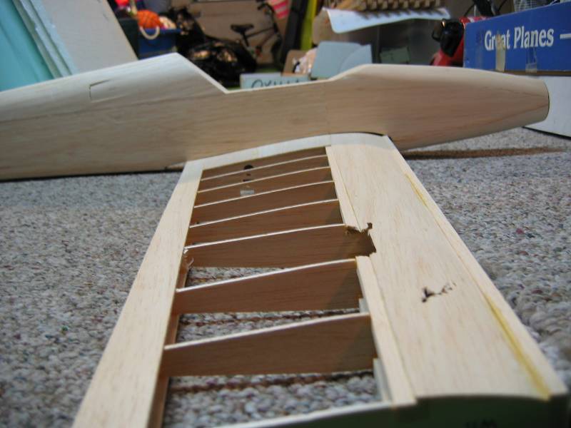

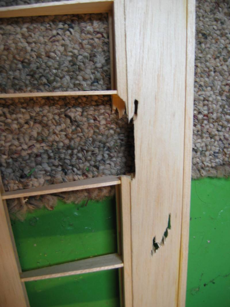

Here are some pics of the frame up, some showing the damage inflicted by King Kong...
Essentially, the right wing panel suffered from broken spars (missing sections) as well as sheeting damage and two snapped ribs (not all easy to see). Also, the fuse turtle deck caved in. The repair unfortunately left the sheeting a little too thin so I'll have to figure something out (including possibly glassing for a paint finish... haven't decided yet).

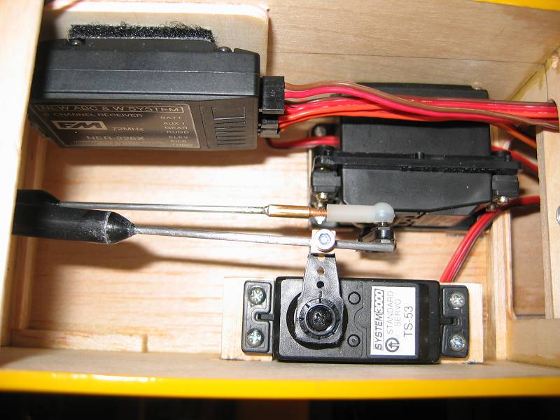

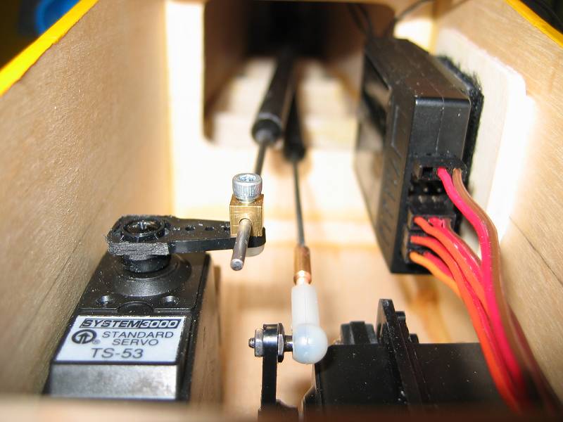

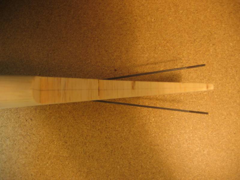

I brought the right wing panel back in shape, did some sheeting work, outboard servo rail/sheet installation, LE and have the wing panels ready for the installation of the TE, wing tips and ailerons.
I discovered that I had made two pushrods back in '97 using threaded steel rods and wood dowels; one of which has the requisite Y at the rear for the split elevators I had settled on back then. Not the lightest linkage by far but I might stick with the Y rod for the elevators as it looks decently made and it saves me from having to rig up another from glass or carbon tube. I always have that option later if desired. The model design is such that I suspect the AUW will be rather low so a little penalty on the rod might not be too serious.
For the rudder, I'll probably not use the equivalent rod I made and instead go with a P-P setup.
Once the TE, tips and ailerons are installed, I'll move onto the wing/spar reinforcement using balsa stick in a zig-zag fashion (stronger than sheet shims) and the cap strips on the ribs. After that I should be to join the panels after a final sand.

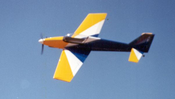

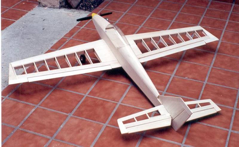

Hello Doxilia, I built a Tsunami 7 years ago and have flown it MANY times, (perhaps hundreds). I love its fast, smooth and precise performance, it's a pleasure tu build and fly.

Very nice indeed Francisco (heck, can I call you Pancho?)!
I see that you modified the wing slightly by using balsa sheet against the spars instead of the stick balsa. The latter is certainly more tedious to apply. What did you use for power? BTW, if you still have it, it'd be great to see your radio layout... just curious.

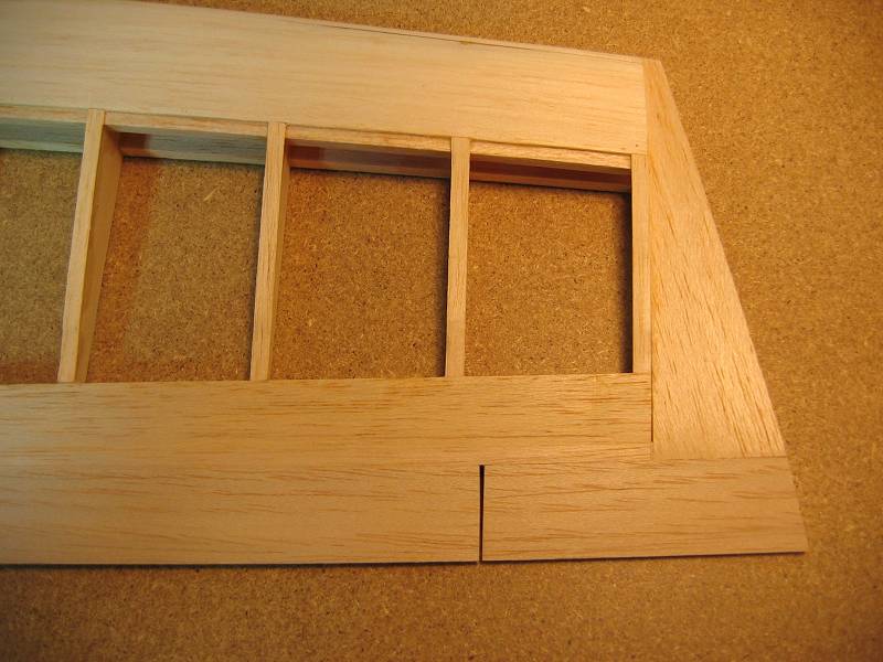

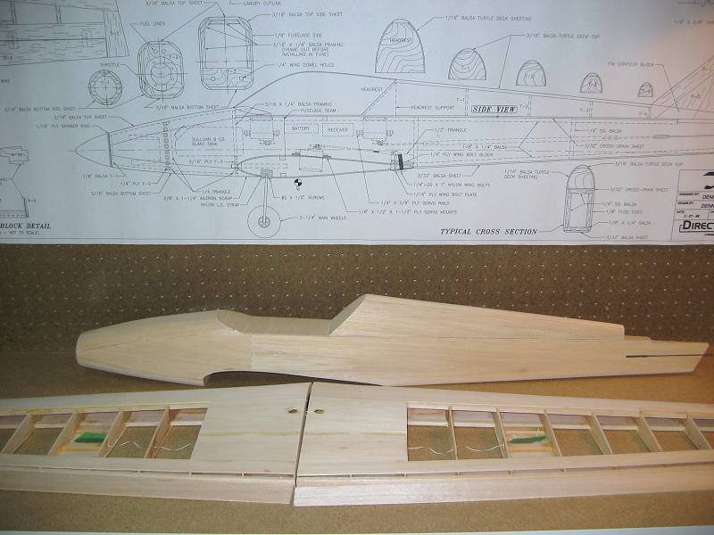

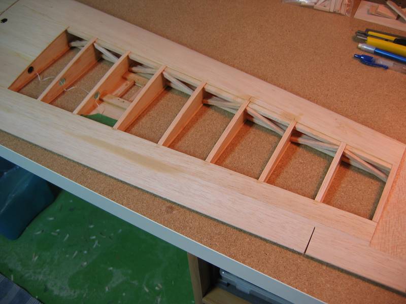

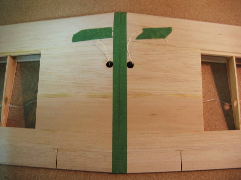

Nothing major to report tonight but I made a little progress on the wing TE and tips. I tack glued the ailerons in place to sand everything to the same airfoil.
My left wing tip is still slightly warped up but I think I'll be able to fix it when covering by applying the bottom, holding the wing TE flat with the spars on the table and reheating the covering. Frankly, I'm amazed the wings are not more warped after all the temperature and humidity changes they have gone through over the years.
The wing panels are not joined yet they're just taped together to check for symmetry. I actually cut the aileron stock to the sections shown on the plans individually and then glued them on individually (this in part because my plans are not on the table where they should be ). In retrospect, I think I might have marked the three aileron sections with the aid of the plans, applied glue to the center and tip sections of the 36" stock and only tack glue to the aileron area. Then centered the whole thing on the TE, sand and cut out the ailerons. This would leave some nicer narrow splits between moving and static sections. It also ensures that everything follows the same airfoil (assuming your ailerons are straight... mine were not quite).
What's left for the wing panels are the shear webs (this should hopefully help to straighten it out too), the top cap strips, servo cutouts and hinging the ailerons. After a final sand, I should be able to join them and proceed to the fuse mounting and wing center section.

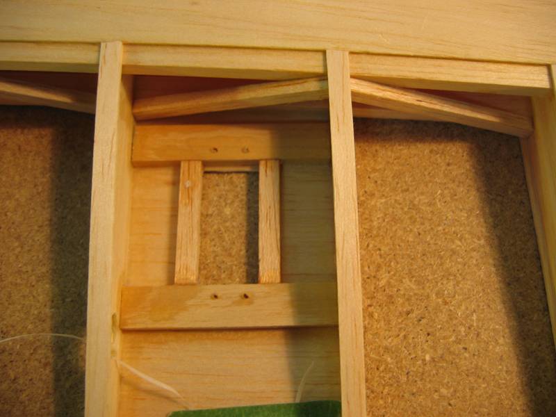

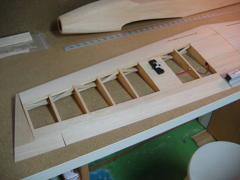

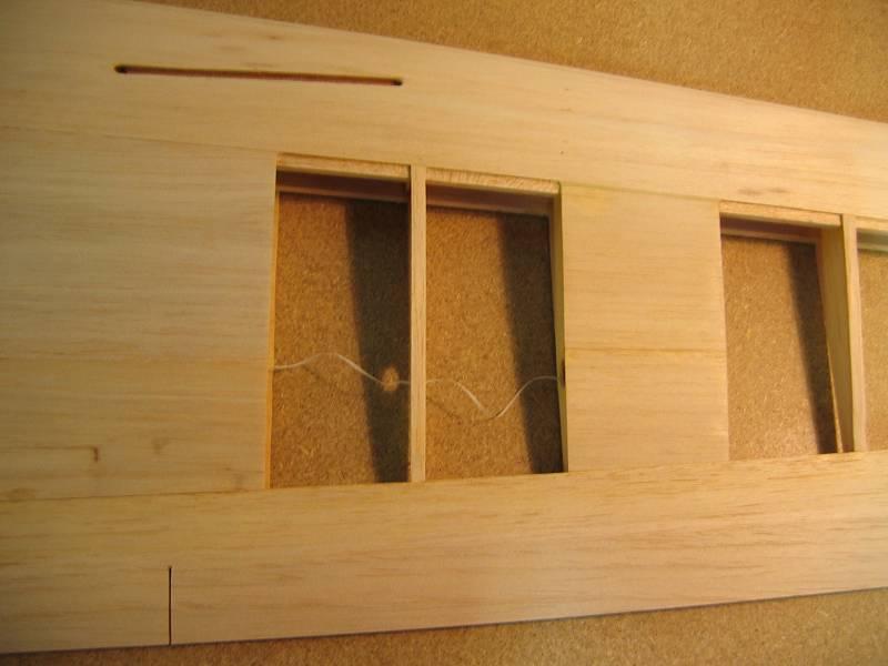

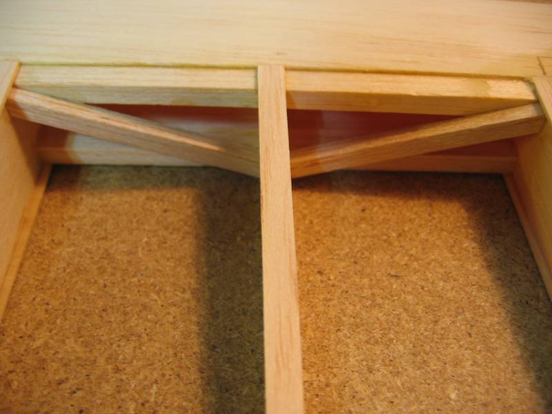

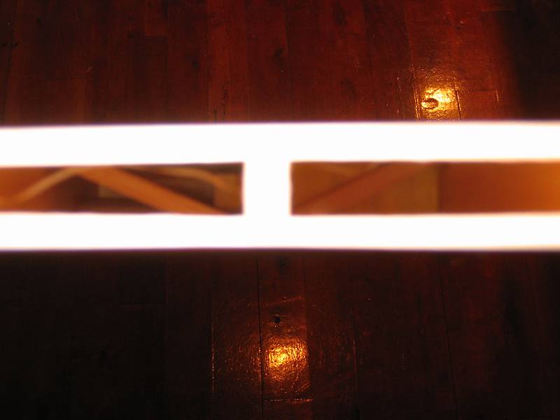

I completed the shear webs and cap strips on the wing panels. The "bridge truss" shear webs are a little more tedious than using sheet balsa as one has to individually sand the angle into each stick end. The instructions claim this yields a stronger wing which may well be so (I buy it). The aileron servo bays are also complete. Hinging and beveling the ailerons is next and a final LE sand with the spiffy new LE/TE sander I got.
There's a tip section of aileron stock which I'm going to have to fix as it's about 1/16" high compared to the rest. I thought about leaving it but that sounds like a plane always wanting to roll when neutral. This is the disadvantage of not finishing a wing structure while everything is of the same "elasticity". Both my TE stock and my aileron stock were also somewhat warped. If unhappy with the wing, I may end up building another in foam with retracts (but that will be after she flies!).

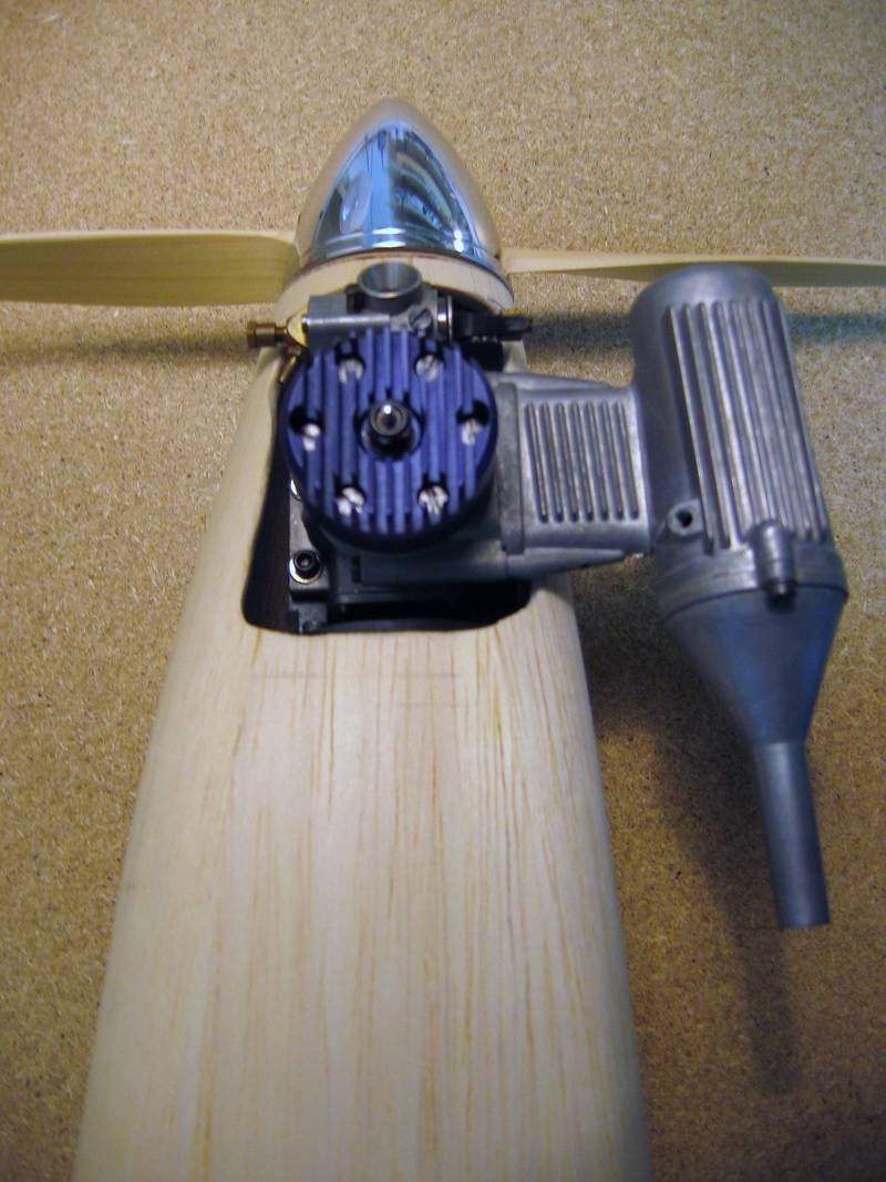

I also went to work on the engine installation. Since my two Dremels (well, one is a $16 version which replaced my 25 year old original - lasted one month) have locked up (can't remove the chuck) [:@] I went the old fashioned way of sand paper on a dowel. I ended up opening up the fuse a little more than I would have liked as I had to pass the engine mount. The ST S40 carb is also somewhat larger than many so required opening up the nose to allow it to fit and for proper throttle movement. Something to consider if starting a build would be to fuel proof (paint) the FW prior to final nose sheeting and leaving the mount installed. This would allow one to only open as necessary to pass the engine. Final fuel proofing of the bay would however also involve painting the mount.
I thought of giving a "homebrew" method of soft mounting the engine a go. I'm using hard rubber washers behind nylon washers in between the mount and the FW. I'm uncertain about how well the rubber washers will hold up under pressure and fuel presence and concerned that the engine may "loosen up" if they disintegrate. On the other hand, the structure of this aircraft is such that vibration will wreak havoc on it. I may end up cutting a rubber ring the diameter of the mount for a more positive "vibration gap".
Next chapter... hopefully a joined wing and on to the fuse mounting.

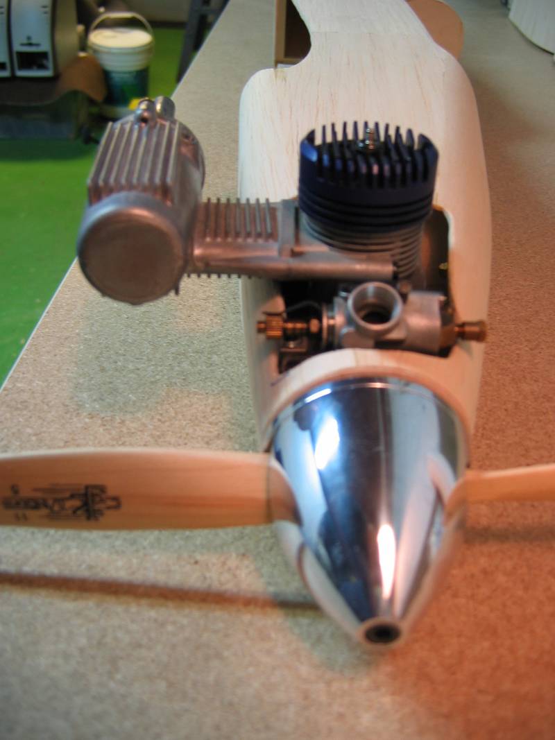

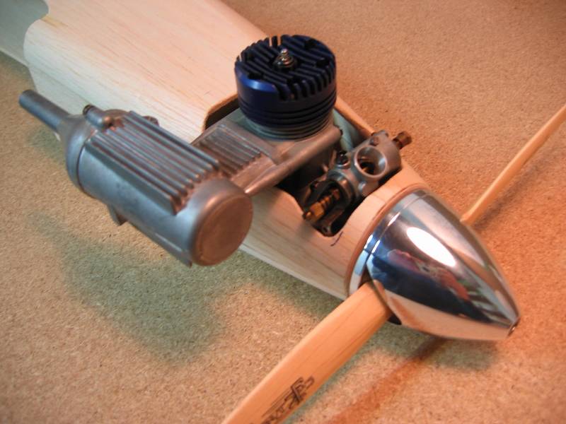

And here's the engine installed...
Not crazy about that muffler so I may end up getting another or perhaps end up changing the engine altogether if the plane needs a little more "kick".

Hi David, my GMS 47 is a very powerfull engine, according to my friend's tach it turns a MAS 11x6 at 13,000 [X(], the tach is a bit old, dunno how accurate it is, but sure is a real powerhouse.
well that engine is a real find then!
At $70 (ABC BB [8D]) it's turning 1200 rpm more than the AX at $130 [X(]. The specs on the GMS claim about .15 less HP than the AX... you might want to check that tach. If it's right, I may end up with one of them puppies in my Tsunami too!
How reliable and user friendly is it? Where are they made? I assume Eastern Europe or Asia...
