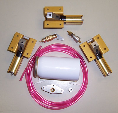

Robart's pneumatic equivalent are here:
http://www.robart.com/retracts/2-5lbPneu.aspx
No details yet.

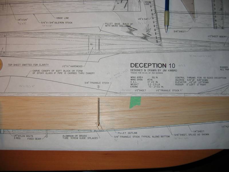

After being unable to get back on the Deception for some real building, I'm back on it.
1/8" fuse sides cut. Wings and stabs need completing so that I can make my fuse cutouts. I'm kind of cutting and kitting at the moment so that I can move along a little faster with the build. The 2 ply 1/8" laminated FW is cut as are the spinner ring, F2, F3 and the tank floor. The tank opening in F2 remains to be done. I'll use 2 dowels to mount the wing at the LE and 1 screw to hold down at the TE.
More to come...

Robart has made the mini air retracts available,and the price looks good as well.
Still have yet to get my 602`s from spring air but maybe tomorrow, i will get the weight and post them soon as i get them in hand.
Going to try those robarts on my ursa major 25, so i will be able to see if there is a weight difference.
-Jason

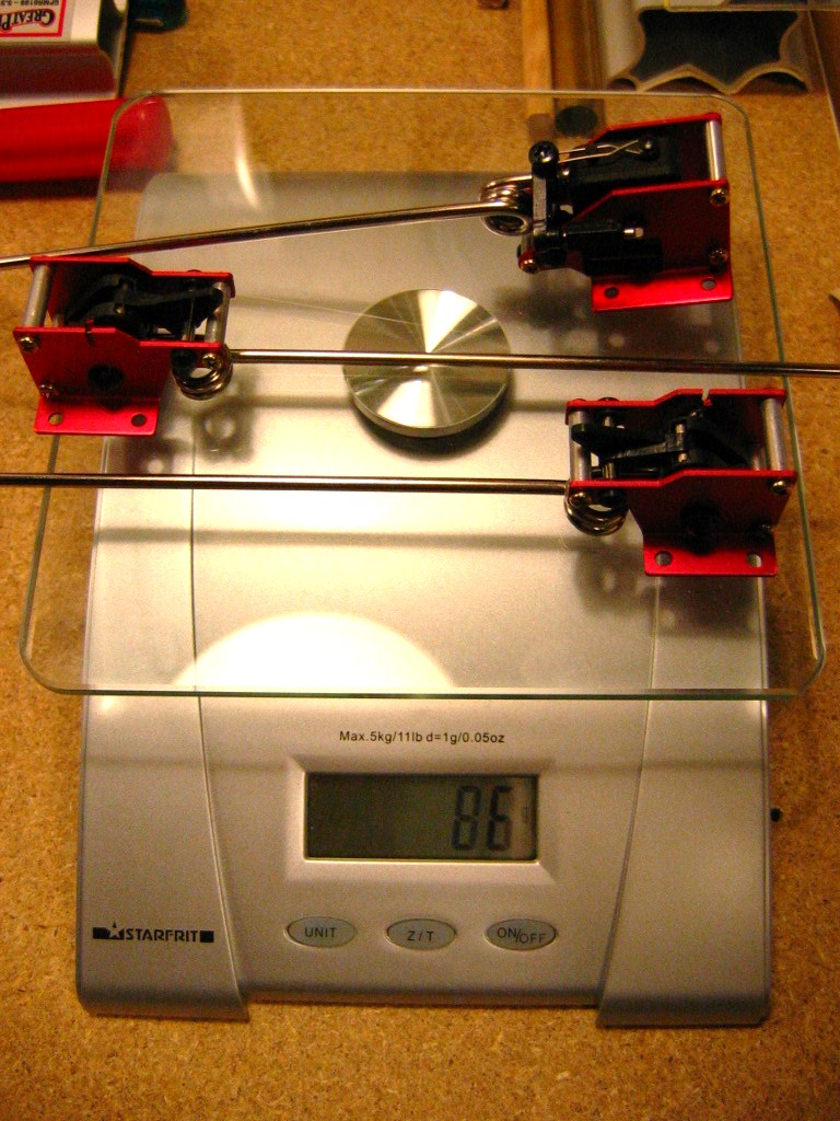

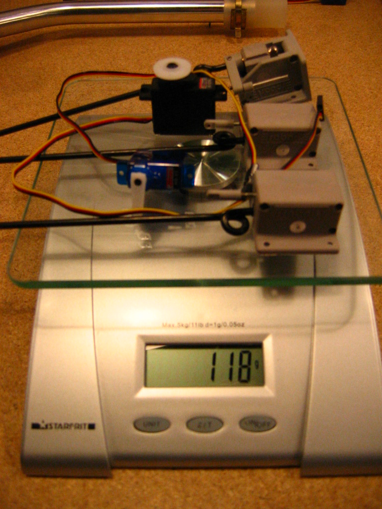

I had to compare those gears and weights...
I checked the MK SS gear - they do use 3mm struts. Wheels designed for 1/8" struts should also work but the MK wheels are so nice. I'd use them on a glow model and would stick to Dave Brown Lectra Lite's for electric models.
The aluminum MK's are 5g lighter than the plastic Robart's! Maybe just a slice of ham but every little bit counts. 20 size mains only are in the 54g range. 10 size Hobbico mains are 32g (1.1 oz). I think that the full retract setup for the 10's could end up in the 4 oz range with wheels, collars, linkage and servo's (1 oz for two).
Here are some pics. 20 sized MK gear is anodized red; Robart gear is gray. 10 sized Hobbico gear is blue. I'm missing the 10 sized Robart nose gear.
Robart specs pneumatic 20's at 125g (4.4 oz) - gear only - so mechanicals are definitely lighter even using two servo's. We're just missing the pneumatic Spring Air 20 sized weights.

By the way,
as a point of interest I ended up making my fuse 18.5% wider from F1 to F3. This is substantial bringing the FW to 2" and adding roughly 1/8" to each side of all three formers (1/4" total). Having a 2" FW allows a 4 oz Sullivan slant tank to be used in conjunction with Robart retract nose gear (#124 | 20g or 0.7 oz). The exact former sizes are (width x height):
[ul][*] F1 = 51 x 66 mm (FW)[*] F2 = 59 x 81 mm[*] F3 = 48 x 58 mm
[/ul]
In the absence of retract nose gear, the fuse can be built per scaled plans using a 4 oz Sullivan round tank (45mm OD) flush against F2 and the battery (250-400 mAh) can be installed underneath the tank leaving a little more room in the radio compartment. A tank floor wouldn't be needed in this case - only a circular opening in F2. Even so, I'd consider widening about 10% on the D10 and likewise on the T10 although there is a long dissection of fuse scaling toward the bottom of the scaled Tipo plans thread - a long post on non-linear assymetric scaling (that sounds kinda fancy doesn't it... [8D]).
