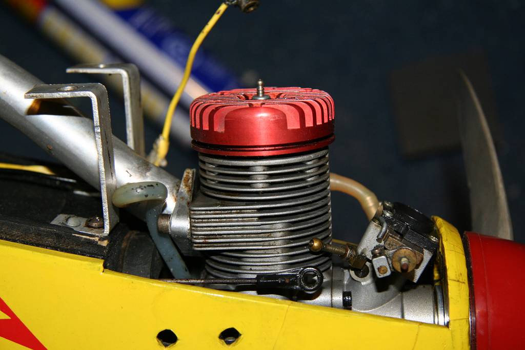

i have a Webra .61 rear exhaust with a red head and Dynamix carb. anyone know about this version and what the actual model is ? is it considered a Webra Speed or competition model.

Here are pics of the red head - not that clear as motor is still in the plane ( a loaded dice II pattern plane ) whci ipciked up recently at a swap meet and am also learning about.

That engine strikes me as a red head long stroke but that's just a "picture guess". It would make sense on a Loaded Dice III.
The old Webra web site is archived and linked here somewhere. A little digging should find it and you should be able to identify the specs on your beast.

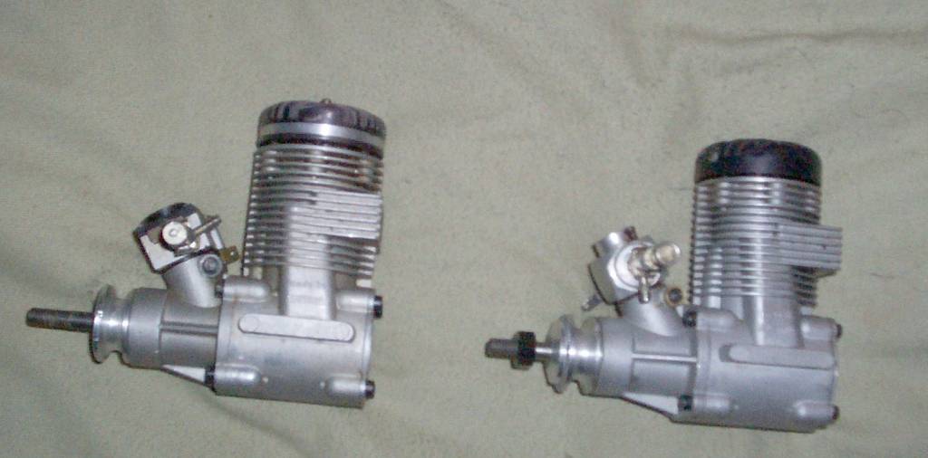

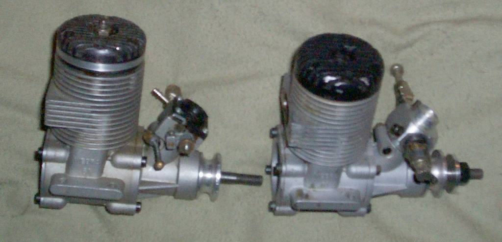

Here are a couple of pictures I found of the older RE 61's. The one with the silver ring around the head is the long stroke while the blackhead is the short stroke.
David.
