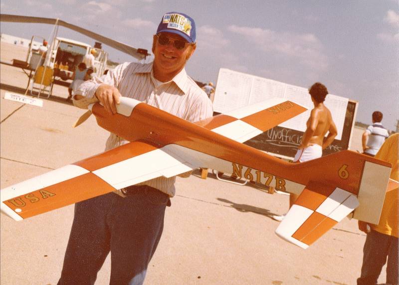

The image I posted is from a original fiberglass WK Hobbies Tiporare. I have tried the above different anhedrals mentioned..... on both glass fuses and wood built.... and the gain was very little. Both with pipe, without pipe, etc.... I'm not saying that there is not any gain to changing the angle.... but there has been many tiporares that were built with the 4 3/8" and have been great fliers..... with pipes and without. In my opinion, the time would be better spent on matching the fuse sides (the reverse curve that goes from nose to tail on each side) and building the plane as straight as you can. Those two reverse curves on each side of the fuse will have more of an effect on the plane flying habits then stab anhedral. WK was the first to produce the production Tipo with Mr Hanson's OK.

Thanks for the info and photos, now I really want one of these. I have a Curare about 75% complete, I started construction on it in winter of 1978 I quit the hobby by spring. I saw Dave at the 79 Nats (the first year I did not fly or enter any contest) and took a picture of him with what I think is a Tipo so these are the first photos of the Illusion I have seen. These photos are very provocative, lots of subtle changes along with very obvious changes. Im going to finish my Curare and work hard at getting the ingredients to build an Illusion.
RE: Tiporare questions
Ron, that's a good photo. Have you submitted it to Trenton RC Flyers yet? http://trentonrcflyers.com/pattern/patternt.htm
David, the rules state that it must have been produced before 1975. If DB actually flew the Illusion before 1975 I might be able to get it accepted by requesting the SPA to add the Illusion to the list. The list does not include the Illusion at this time though so I'll work on the wings till I find out what will be accepted. Thanks.

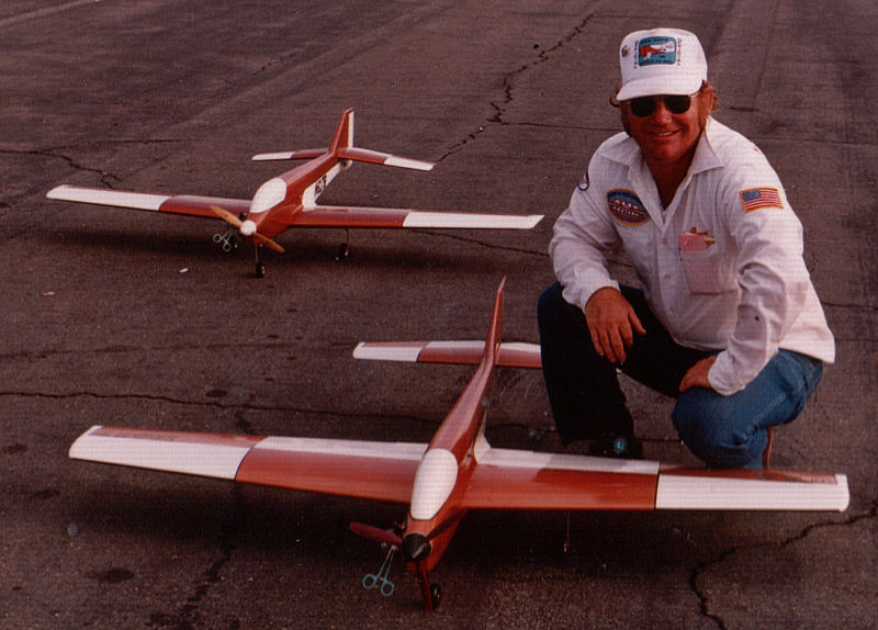

Ron,
glad to be of help and inspiration. And great picture of DB at the 79 nats!
That is definitely a Tipo by virtue of the wing location and also the fact that Hanson's Tipo article wasn't published until 1980. I would have been surprised that the Illusion existed by then. On the other hand, I purchased my Tipo from GP in '82 and I believe they first released the kit in '81 although they presumably were available from WK beforehand (1980 time frame). I would venture that DH and DB were testing the Illusion in the '80-'82 time frame with GP releasing the kit in '82.
