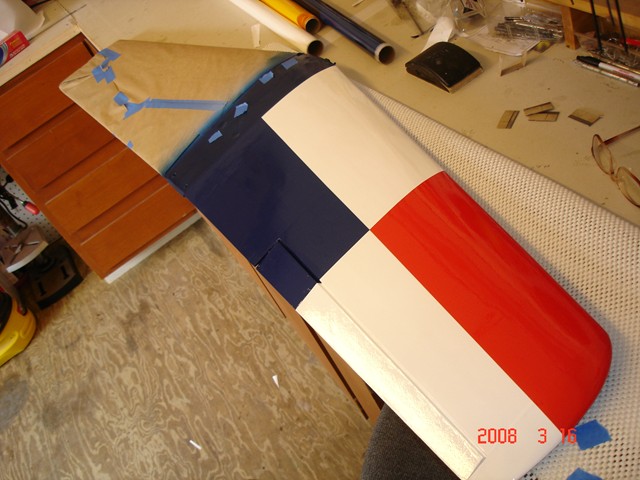

I am in the middle of covering my Banshee and thought I would try something I read about in another forum. That Is using hairspray to seal the wood before covering. I'm using monocoat for the first time in a lot of years because the color(metallic platinum) isn't available in ultracote. I can't get the stuff to seal down to the wood in spots. I wish I would have tested on some scrap. I stopped and covered everything else with a lite coat of balsarite like I always have. I can't decide whether its the monocoat or the hairspray, or both. What do you guys think? Anyway, a heads up.

Hey guys, thanks for all the suggestions. I have all those bases covered that have been mentioned.. I had just covered one panel on the bottom of the wing when this showed up. I've used balsarite for years and thought I'd try this idea. Hairspray is basically laquer if you'd believe it, so I thought it would act like balsarite and seal the wood and give a slight adheseive (sp) effect. I've had a bad attitude towards monocoat so I'm basically blaming it! Although I really can't complain about anything else so far though. After over 35 years you'd think I would have it figured out by now. The biggest thing I'm kicking myself over is not testing the idea on a piece of scrap. If I can't get it to seal down in those spots I'll just strip it off and start over, not the end of the world. Just wanted to give a "heads up' incase anyone else had read the same thread. I've forgottten where it was now.

Ed, glad to hear I'm not the only one to have tried this hair brained idea, (pun intended). I have covered the rest of the wing after a coat of balsarite and I'm having the same problem in spots. It's like the monocote doesn't have a consistant amt of glue on it. I thought the balsarite would cure the problem. I worked on this off and on all day today and am about fed up with it. I'm dreading taking it to the field on a hot sunny day. I expect it to wrinkle up like a prune. Anyway I an done with monocote, again. I will say that the seams dissapear better than with ultracote, assuming because it is a thinner film. I know that others have good luck with this stuff but I'm not happy with it at all. I've been modeling for 35 years or more so I do have some experience. Not that I know it all, maybe I'm doing something wrong.......................anyway, it is what it is.
Thanks for talking to Ed H. about it. He must have had some success. I really don't think the hairspray has anything at all to do with the problem

Ed said that there is a particular brand of hairspray that he and others use. He could not recall the brand name but said it has a pink top. He also said that it improved the adhesion of MonoKote ..... plus ...... Ed said he uses a "LOT" of heat and really works at fusing the Monokote adhesive to the surface and the "lacquer"left there from the hairspray.
Like you, I have not developed the proper application technique ..... and am always disappointed by my results with film covering. I will also say that even the guys who apply it with impressive results have wrinkles appear after their models sit in the sun for a while.

The surface must be smooth, clean and dust free and the iron must be HOT. The iron must be HOT enough to momentarily discolor the Monokote when it passes over it. It helps to 'rub' the MK down with a folded cloth or oven mitt (immediately after the iron) while it is still HOT. Some irons don't get HOT enough. The MK will contour to most shapes, if the iron is HOT enough, by stretching and ironing. Otherwise (wing saddles, etc.) the MK can be 'finger cut' and each 'finger' ironed down over the previous one for concave and beside the next one on convex surfaces. I've had to do this on wing tips before.

Guys, a big thank you to Anuthabubba as he may have saved the day. Following his suggestion I turned my coverite iron way up and went over the wing again. It went nutts with bubbles and wrinkles but finally cooled and shrunk tite. I also as befor rubbed it down with my mit. It now looks good and hopefully will stay that way. I had my iron set to 350. I don't know what the monocote instructions said because as the experienced modeler that I am, promply thru that in the trash, Don't need no freekin inst. I did notice that they had taken the clothing iron off the inst finally. We'll see what this lokis like in the morning but I think anuthabubba has the answer. Maybe my old buddy Ralph knew more than I gave him credit for.
Anyway, hats off to anuthabubba, and thanks. Sugarfox
