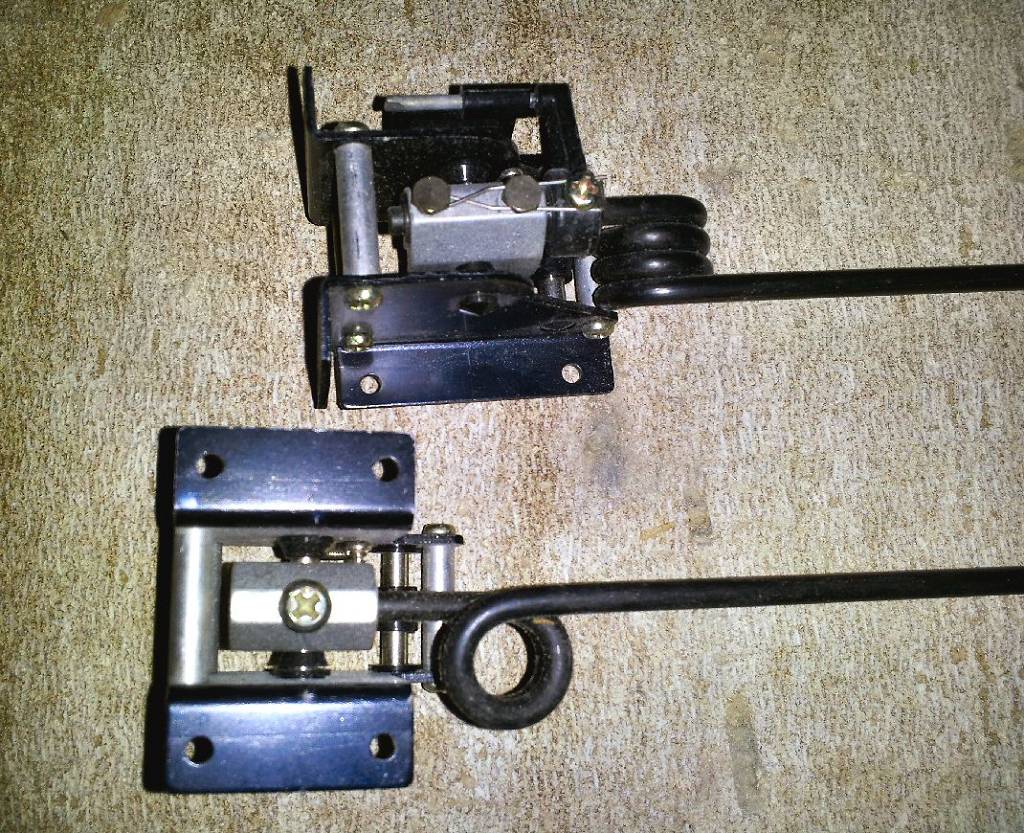

OK here's the retracts:
MK?

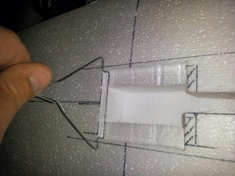

Before putting the M1 on hold, I had made a template for cutting out the retract mounting locations and wheel wells from some 1/32" plywood. I used my Craftsman soldering iron and some "electric fence" wire I had laying around to cut out the foam where needed.
I'm sure some of you are saying to yourself, there's a better/cleaner way, but for me, it's quick and easy.
Next step is to mount the 1/4" plywood retract mounting plate (with dowels) and line the wheel wells with balsa.
There's also an overall shot of it's current state.

Those gear are MK, OK or Supra - all made by the same manufacturer and branded accordingly. I just can't recall what model they are if MK. Let me check... (luckily my wife put a bunch pf RC paperwork in a drawer )
Actually MK's flyer doesn't show an black gear and I believe Supra gear was typically anodized green. Maybe OK, they did make black gear. In any case, nice metal trunion.
David.

They look like Royal Retracts.

Thanks for the clarification Jeff - I knew someone would recognize them.
Granted, probably still made in Japan by the same manufacturer and just branded by Royal.

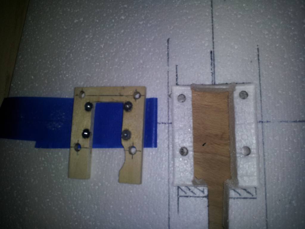

Reatract mounting plates are done and installed. I set up the mounting plates for the "Royal" retracts I had on hand. I discovered that one of the retracts were broken so I was in search for a replacement. F3AUnlimited has MK retracts in stock so I ordered a set of mains from them. Other than the <caugh> <gasp> $100 for the set, I'm very happy with my purchase from F3AUnlimited. I ordered some MK "lightweight" wheels and the MK offset linkage for the retract servo as well.
The retract mounting plates are made from 1/4 ply. The dowels are 1/4 inch dia by 1" long. Holes in the foam for the dowels were made by heating up a 3/16 drill bit.
Next step will be to install the wheel wells and retract pushrods (to check for clearance).
