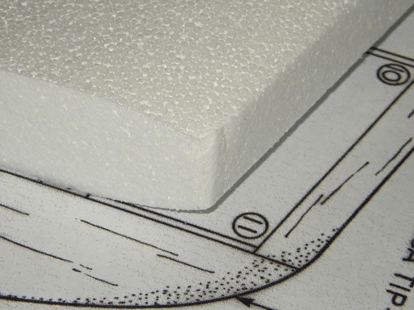

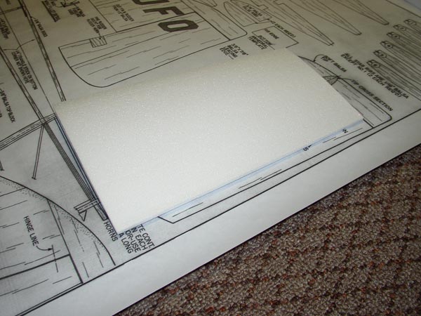

The foam cores arrived today! Overall they look pretty good. UPS managed to squash the box a little on one end which resulted in the leading edge of one of the wing tips to be compressed a bit. I don't think this will be an issue, worst case I might have to fill a small cavity after the sheeting and leading edge are applied.
I checked the cores against the plans and the airfoil shape for the wing and the stab are right on, both at the root and tip. The plan form of the stab is right on, the wing however is off a little. The sweep cut into the cores will put the wing tip about 1/2" further back than the plans show. You can see the difference in one of the attached photos. I don't think this will be a problem. Any thoughts?
Looks like this build will officially begin this weekend!

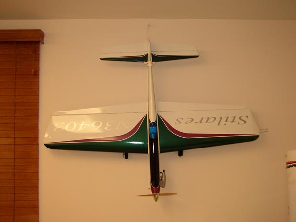

RG,
I built a Dirty Birdy from RCM plans 2 years ago. I do not know if there is a size difference between the UFO and Dirty Birdy. I powered my D.B with an OS55AX. I could not be happier with the airplane/engine combination. The AX55 has more power than the .60's used in the 70's. The vertical performance is excelent, but not unlimited. The UFO may be larger but if it is the same as the D.B. the .55AX is not a bad choice.
Jim

David,
I think Jim might be referring to engines like the ST G60 and similar - true 70's engines. I tend to think of Rossi's, OPS's and YS's as 80's engines even though companies like Rossi have been around a long time - especially in the speed event.
A DB or UFO built to 7 lbs or under should perform quite nicely on a 55AX.
Jim,
There's is not too much difference in size between the DB and UFO. The latter has a swept wing and stab and a larger fin & rudder. The actual fuse is ever so slightly different but hard to detect at first glance. The wing construction changed slightly to a more modern building approach. I'm not sure if the airfoil of the wing also changed but I believe the chord aspect ratio changed slightly. The stab has a reduced airfoil so it is thinner and more in line with the Japanese designs of the time.

I'm sure some of you have lost some sleep wondering what kind of builder this RG guy is! So I thought I'd post a couple of photos of the last airplane that I scratch built about 12 years ago. It's not RC but it's the same type of construction, foam wing, wood everything else. It's not perfect, but it's light, straight and flies well. If this UFO project turns out that way I think I'll be happy!
RG

RG
That is an outstanding U control model. I only flew Cox u control planes and 2 Lil' Satans, but I've always admired planes built like yours. I loooove the UFO and Dirty Birdy and I am just waiting to watch your work unfold. If I can get my other projects finished I will begin my UFO scratch build. Keep up the good work.
Gene
