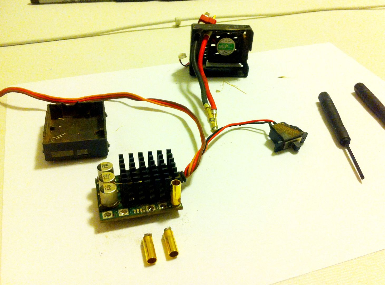

so the controller is made to run 2 7.4v batteries, i had 2 5300 65C packs. i then went ahead and installed a 14.8v 5500 60C and i ran the car for good 30-40 minutes till the battery died. I then let the battery cool off and charged it up. next day i tried to run the car and it would only twitch, i then tried again later and saw a little spark at one of the speed controller connectors, any ideas as to why this happened and if in fat i did fry the controller, what should i look for in a new one in order to run my 14.8v safely and not burn it out.

well there is my problem, 2 of the connectors broke of, who knows why or how

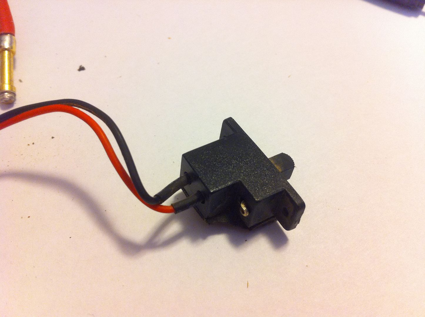

Huum,,,
Looks like the switch melted too,, you running that car in tall grass???
You make just have over heated it and the solder joints melted,, I'm surprised that doesn't have thermal shut off.
you going to try to fix it or send the pics to HPI?

I'd rather solder on short leads, than solder those connectors back on. Also seems like they would always be asking to break off. I wouldn't be surprised if they were cold joints to begin with. I would imagine mechanical shock caused them to fail, as they would have to be very poor solder connections to fail by melting, but who knows.

The switch makes me think over heating, but that could have happened if the battery shorted too,, Lucky the whole thing didn't go up in a lipferno

well nothing melted, thats just the sticky foam ripped off that was holding the switch in place. im debating if i should try to solder back or maybe even just take to my local RC place and let them do it, not sure yet, prob cost me $5-$10

LOl, Well then Bill might have hit it,, just the vibration or it's a defect,, either way I'd ask HPI to replace it if it broke or it burned up under the normal rated use

I did that to an esc last week, combination of heat and landing over and over on the lid on a track (oops) and im sure a suck solder job from the factory. My neighbor soldered them back on the board and it works fine. Had him do it because he has a much nicer digital temp selection iron and way better skillz for getting onto pcbs. Runs fine is the point

local RC shop soldered them back for me for $5, he said they had been done back from the factory
