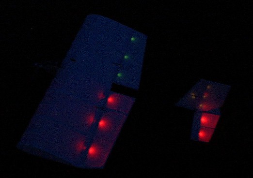

mine has coloured LED's in every section, covered in white Easycote. in the day it looks normal, flick on the lights at night and it gives a diffused effect. some clear planes can get a bit dotty. i needed more in the main wing sections as one at the back isn't enough, and nothing shows through the leading edge at all. the surfaces however are perfect.

The LED's aren't they a directional light? Would a bright bulb be better?

hence why i used sidefiring LED's under the white film to diffuse.
standard LED's are not really bright enough, they also have narrow beams, the ultra brights are good for sopt lights, forward facing on the tips, facing the ground etc, you can also point them along the wing from the fuz to light up the outside of the wing.
the "grain of wheat" bulbs work better in clear planes.
like i said above, my wing needed more than just one LED at the rear, i should of used at least 4 per segment and of a brighter output.
