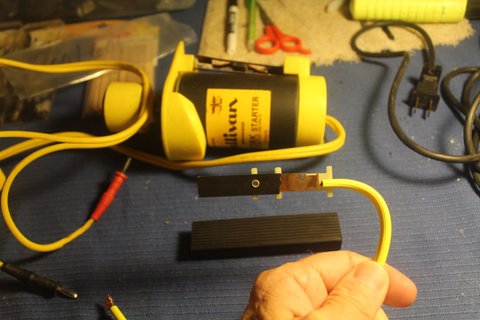

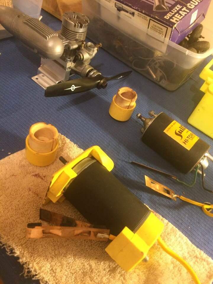

I am right in the middle of re-building a couple of 40 yr old Sullivan Starter Switches. These two motors have very little wear on them but the years have taken a toll on the switches. I am in the process of finding some rubber I can use to make the switches work properly. At the moment I am looking at hollow weather-stripping. I am sure Sullivan sold millions of these starters so I thought I would post a little information that may prove helpful to others that own some very old Sullivan Starters with switches that have degraded over the decades. (yes I am an old school nitro guy and no I do not care if nitro is dead or there is little interest. I go my own direction)
Well here they are. Two of the Sullivan's that were SO popular back-in-the day
These pads are not good and longer. They have degraded over time. No more compression and no more return
Side view of squish-pads. Compression pads would be a more sophisticated call-out for a bill-of-materials.
The over-all dimension, outer face to outer face, is very close to .250". The conductor thickness is approximately .020"
The sleeve appears to be a hollow core rectangular weather seal. Over-all dimensions 0.5" x 1.0"

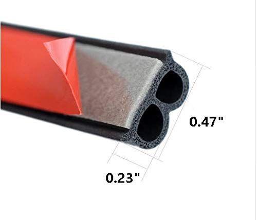

Default Sullivan Hi-Tork Switch re-build

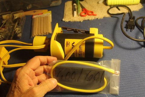

Here is the product I will be using to replace the "compression pads". My concern is that it will compress too easily. I am also concerned that it will not have enough "return strength" to break the electrical circuit.
Here is the new compression pad material I purchased off Amazon
Here is a newly designed switch I found in England. They have not responded yet
I reached out to Sullivan Products but they have not responded yet

Yes and thank you. The Sullivan design from back in the day was excellent (except for some aging concerns with the compression pads). One of your co-workers has contacted me and I will be placing an order for the "deflected metal" type switch. I like it better than the compressible foam. I am sure some old die-hards like myself will be contacting you. Replacing switches is certainly not a great amount of business for Sullivan but the product is fantastic.

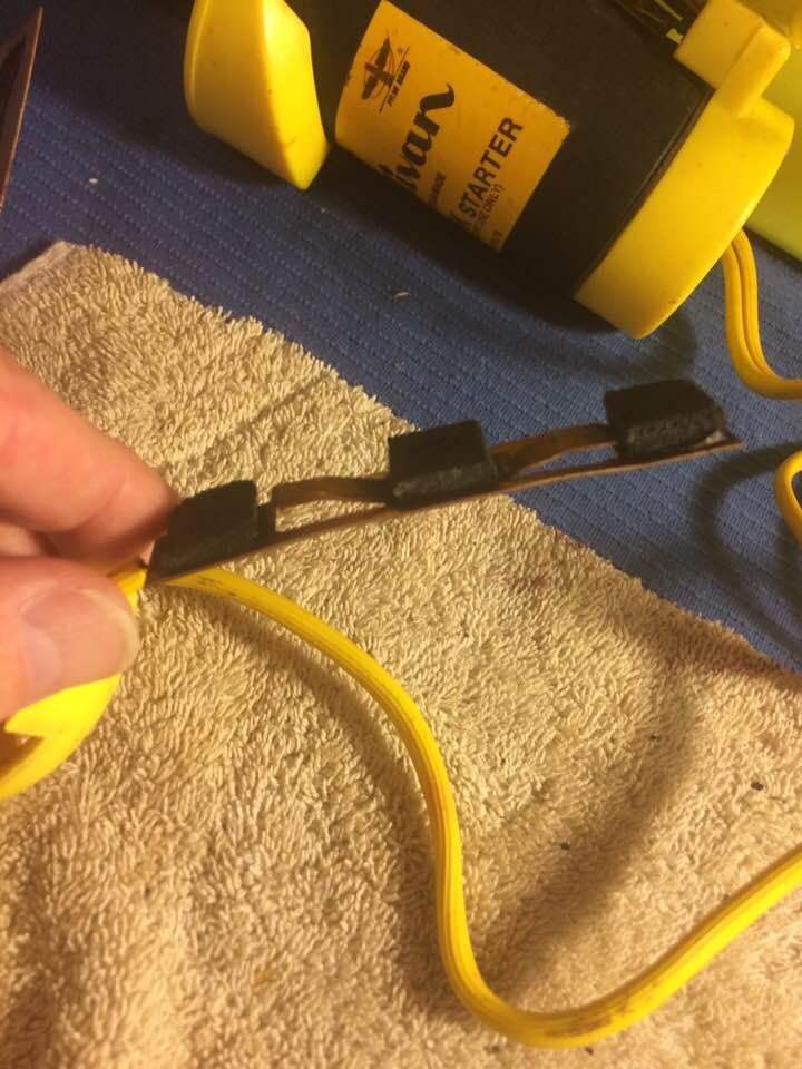

08-24-19........YEA! Sullivan switch assembly arrived today. From a design perspective it looks GREAT!

Very happy to receive some replacement Sullivan Switches. They look
great from a design perspective!

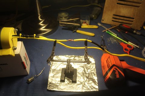

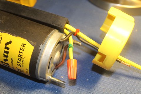

I wired-in this switch they sent me. The starter works GREAT! From a design perspective it feels solid as a rock. I am VERY happy with this switch!

A blow-up photo
