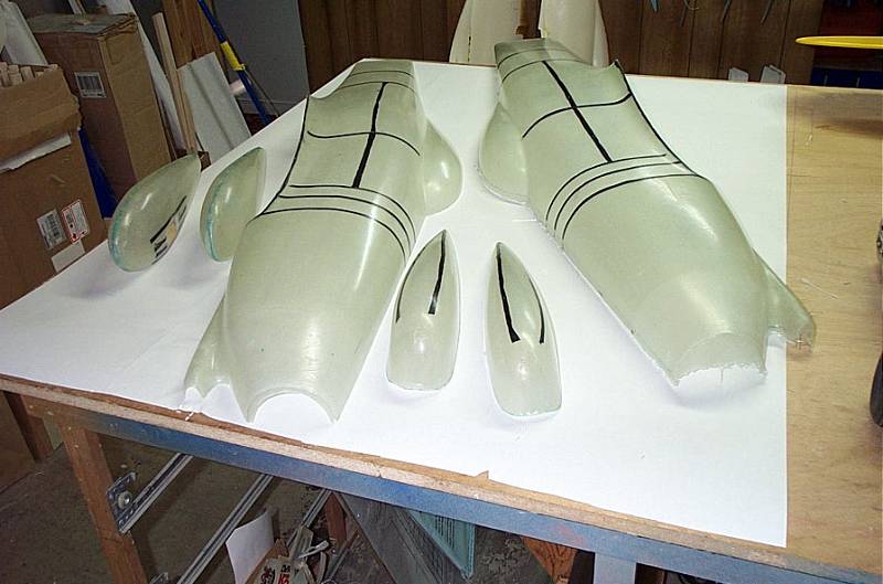

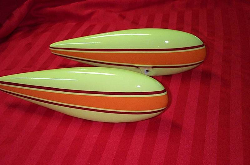

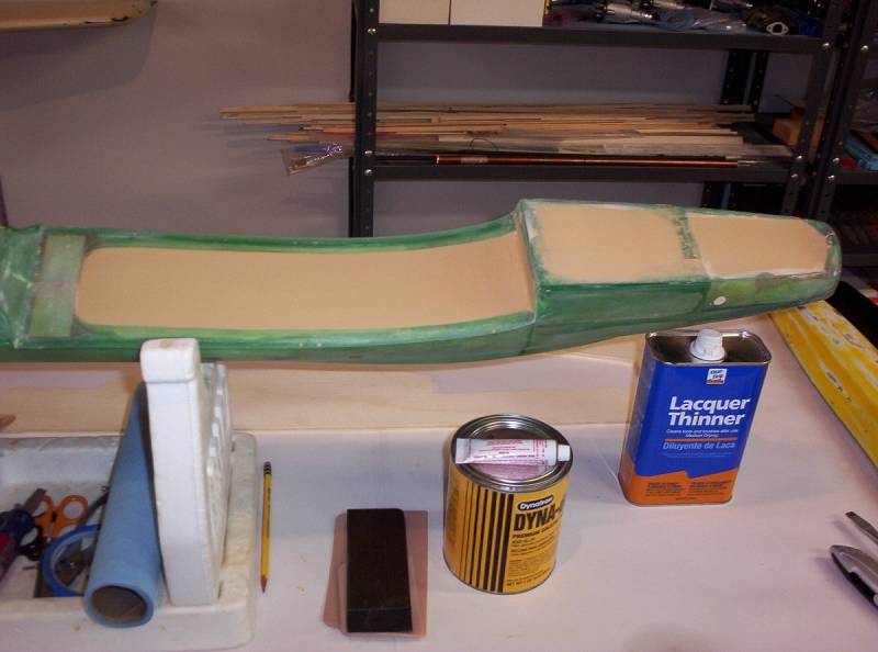

Start with wheelpants. they are fairly small and the dollar investment is low. After that move on to simple cowlings and then more complex cowlings. If you have success with tose items than you are ready for fuselages. Make a fuselage plug from a popular kit. You might be able to sell some and recupe your loses to date.
I never use heat. All my work is done in my house and is a room temperature cure.
The foregoing is a generalisation and subject to many other suggestions.
The one thing I advocate and will not argue about is always use high quality epoxy resin and never use polyester.
The picture shows the progression, Wheel p[ants, cowlings, fuselage sides.
The other picture shows the finished wheelpants.
Good Luck.

RE: A few newbie type questions
Thanks Ed,
I was puzzling over what to try first, be it a hobby related item or not. I was eyeing my recycling bin in the house for a good candidate. I have a set of wheel pants for my 1/4 scale Skymaster. They are large, but maybe that's what I need to help me get some good practice. I even thought of using a Dubro fuel tank as a victim, errr I mean candidiate.

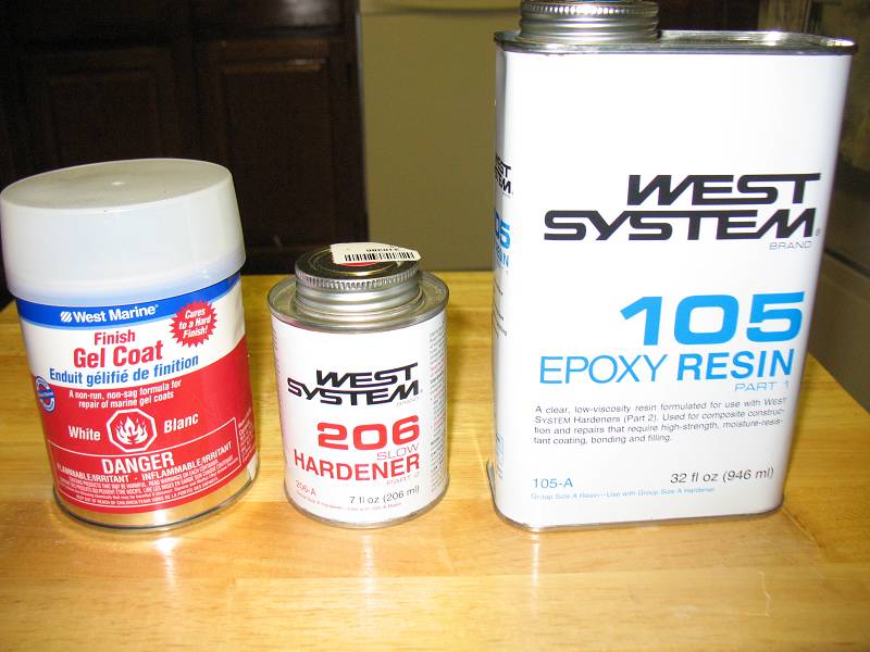

By the way, here's what I picked up over the weekend from a local West Marine dealer. I couldn't find "Tooling Resin" only their "105, General Purpose Resin". I picked up some gel coat too. If I remember correctly from past posts, the gel coat is for use when doing the layups for a finished product. It is not for use when making the mold, as a type of Tooling Resin. Is that correct?

I have never used that West Systems "Gelcoat" you have in your photo but it appears to be a polyester product...I would not use that with Epoxy...
Typically with epoxy you want to use an epoxy "Surface Coat"...

You are going to have an easier time finding all the things you need at online suppliers...the drawback being the wait time for shipment...but the prices and availability will be much easier.
The West System Epoxy is what I use for making parts - but the extra strength is not really needed for a mold and is considerably more expensive than a polyester tooling resin. Second the nomination for the gelcoat - it's not recommended to use with epoxy resins.
You can use a standard gelcoat but a "tooling" gel coat is designed for making molds (tools). Then use a laminating polyester resin to build up the structure around the gelcoated plug. Chances are that the gel coat you purchased at West Marine has a wax additive to allow it to cure in open air (the wax floats to the surface and seals the gel coat off). Gel coat will not cure when in contact with air (which is fixed when you are making a mold by constructing the resin and fiberglass around the gel coated plug sealing off the gelcoat and making a great bond). To be sure, check the can of that gel coat to see if it is "air inhibited" - if it is, then it does NOT have the wax. if it has wax, it could affect the result of your mold surface.

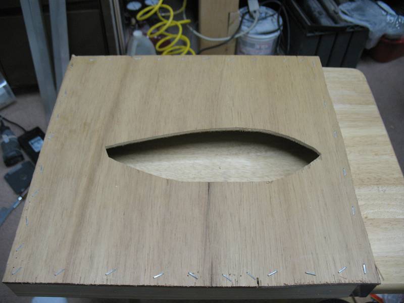

Oh, forgot to ask, what's the best way to block off the opening for the wheel so that I can begin making the mould?
Do not take chances with mold release wax. I use only wax that is specifically meant for mold releasing. I will not take a chance with any other product.

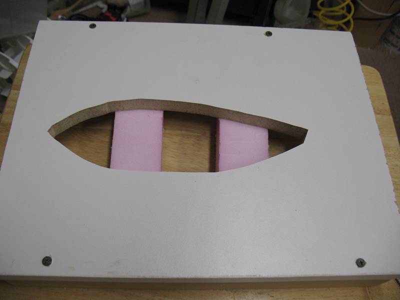

Another little idea you could consider for filling the hole...Scrap balsa sheet to fit the opening...Tack with CA as required...Fill and finish with bondo or whatever material you choose:

I would not bother to seal the hole. I would just stick some masking tape inside trhe pant around the edge. When applying the gelcoat go up to the tape. The hole will be cut out anyway.

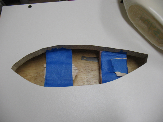

I do not use PVA on the plug I just cannot seem to maintain the high gloss finish for the mold. I use PVA for the first layup in the mold. I can always fix the finish on the first part.
As I said before I never use Polyester. I use only epoxy resin. PVA and quality release waxes are not affected by different resins. So far for me anyway.
The picture shows what I meant for the wheel hole. Just a small part is shown I think you will get the idea. The parting board can bridge the hole. It just saves having to fill the hole. If the hole is filled that surface has to be decent to allow a good release.
Ed S
P.S. Keep asking questions. You will save yourself a lot of heartache.
ORIGINAL: Ed Smith
Ed S
Ed S
Thanks for the photo, but sorry I'm having a brain fart and still can't figure out how the parting board goes. Here's what I decided to do. I put clear packing tape over the wheel opening. I then cut out my first ever parting board and added some wood to build a box-like structure. I use some plywood, but realized after I cut it, that using it was a mistake. It would not give me a nice smooth surface without a fair amount of work to close the grain and make it nice and smooth. So I cut out my second one from white laminated shelf board. Melamine I believe it's called. I then epoxied some pink foam to support the pant. My Dremel mighty-mite made short of the foam. As it turns out it workes a little too good. I needed to build up some more supprt, but some tape and thin balsa had me back to where I needed to be. I think I found a local source for Formula Five, and if so, I'll pick up some this weekend. Until then, looks like I'm on hold.
-Jorden

Jordan,
You are making a career out of it. All the parting board has to be is a flat surface around the centre of the plug. It is used only for the first mold half and then discarded. Support for the plug is not needed. The board must be a tight fit on the plug with no gaps. If there are any unfilled gaps around the seam the gelcoat will leak through and the result will be one miserable joint line.
So fit the parting board to the plug. Then tape the half hole above the board in the manner I show. There will now be an "Edge" all around the plug for the gelcoat to stop at.
The method I advocate takes about fifteen seconds.
Ed S
Ed S

I assumed that the parting board also should have a smooth surface suitable for waxing/PVA since it will be removed from the first mold half. Is that not correct? The plywood surface was very course and I didn't think it would wax up too well. I would have to fill in the grain to get it smooth enough to wax well without all of the ridges. Although, the ridges could act as a way to lock in the second half of the mold. Hmmmm.
-Jorden
