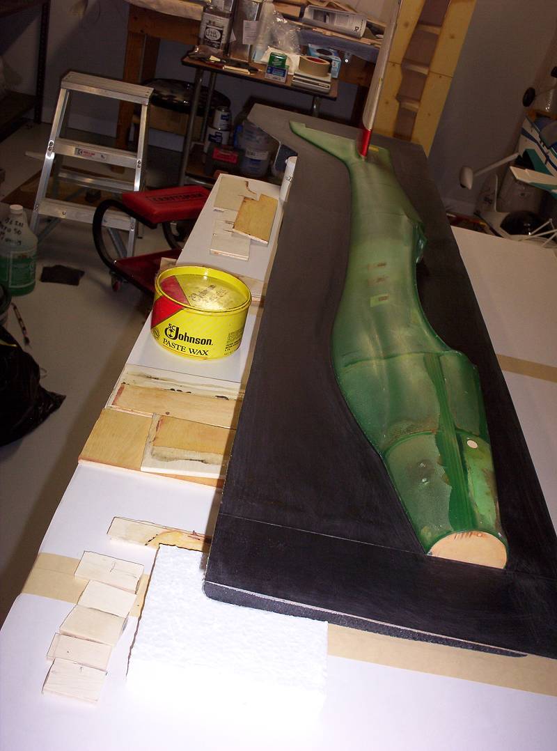

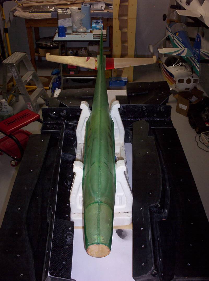

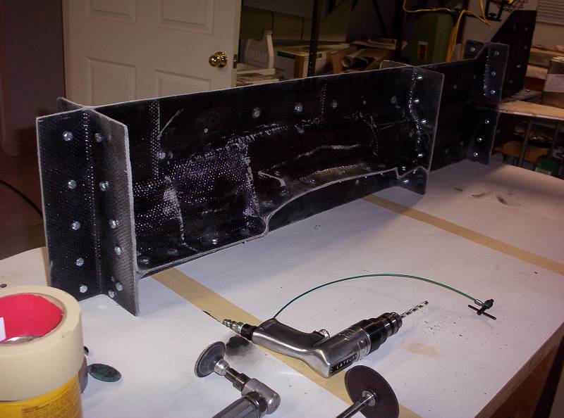

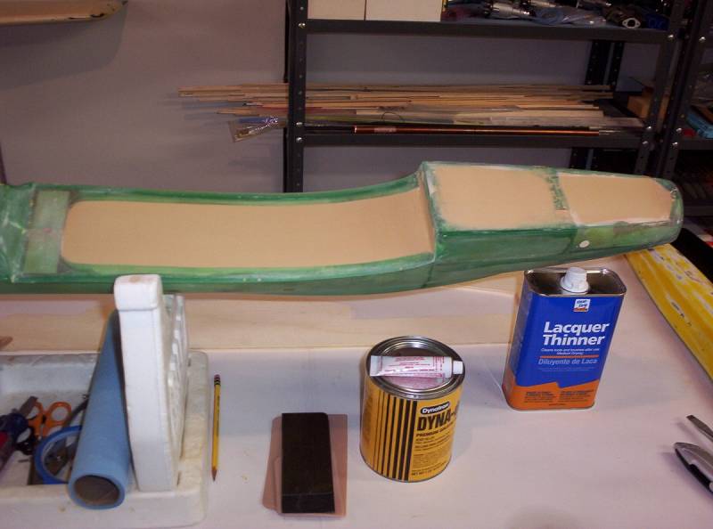

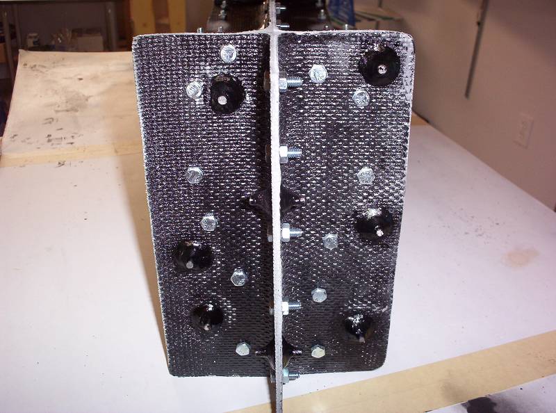

I'm splashing a Classic Pattern Aircraft called Atlanta...I thought I'd do a little thread in case some of you would like to follow along?? Who knows I may even learn a thing or two before it's all over!!
This is a "Dream" Aircraft of mine so I'm kinda hoping she'll be able to survive the process?? We'll see...I understand the risks and have accepted the fact that I may damage or destroy this fuselage in this process...I hope not though..
The fuse is really very rigid from the factory...This is nice because it saved me allot of work stiffening it up in order to splash...You hear me use the phrase "Splash" rather than "Mold"...My plan of attack is to first make a semi lightweight fiberglass transfer (aka: Splash) off this fuse...Then I will use the splash to make a "Master Model" or "Plug"...Finally I will make the actual Tools (Molds) off that Master...
Since I've elected to use fiberglass for my "splash" instead of plaster or something else...The process won't really be that much different than making a mold...However...I do have a few little hurdles to overcome which may be kinda interesting??
I'll start by posting a few pictures of the Airplane and then setting up the split line (parting line)...This is probably a little overkill...But I have more plans for this set-up and I'm hoping to re-use it if possible...I also wanted the fuse to "Stay Put"...It seems to be working out pretty well so far...Hopefully she'll be still through out the splash...
As you all know...There are several different "ways to get there" ...I normally like to choose the hard way...
Have Fun...
Chuck

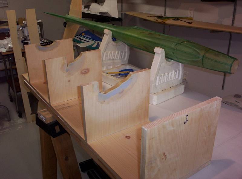

stupid question; why make two plugs? Why not finish this plug and make the final mold off it instead of investing in an entire second process?

ORIGINAL: TeamSeacats
Not a stupid question at all!! But my explanation probably won't make any sense to ya'...
I want to do the best I can to keep this Aircraft original...My "intent" is to not damage it during this process in hopes that it will fly again...I'm going through some extra pains that will hopefully help preserve the Aircraft...We shall see??
Second...I don't want to remove the Horizontal from the Aircraft (In hopes it will fly again..he he) and I didn't want to have to re-work or patch the final tooling in that area...Also..In order to try to reduce some stress on the fuse while I de-mold...I'm going to break it up in a few sections...Then I will make the final molds as one piece...I know that doesn't make too much sense to most of you all...But I'm weird...
Then there are some areas I want to re-work from a fit and finish standpoint...Having a "Master Model" will allow me to do that without altering the Aircraft from it's factory state...
I guess in *My* mind I'm looking at the model you see in the pics as "My Airplane" and not a "Plug"...
See..Told you it wouldn't make any sense...

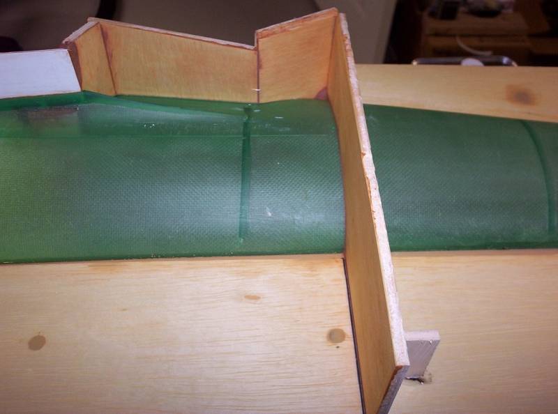

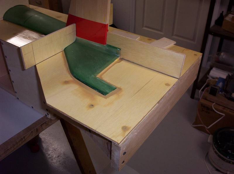

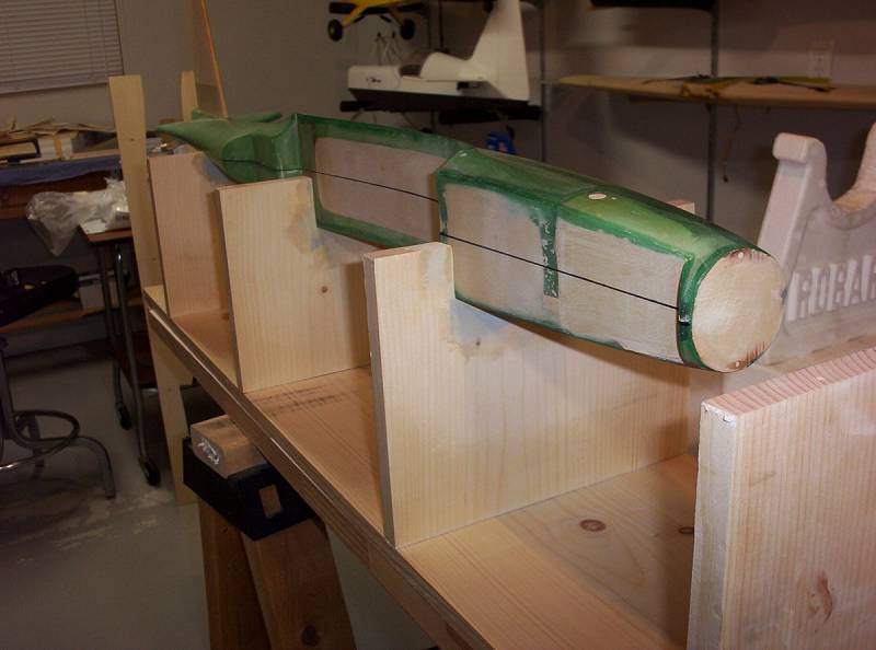

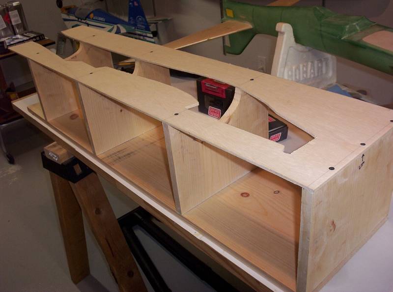

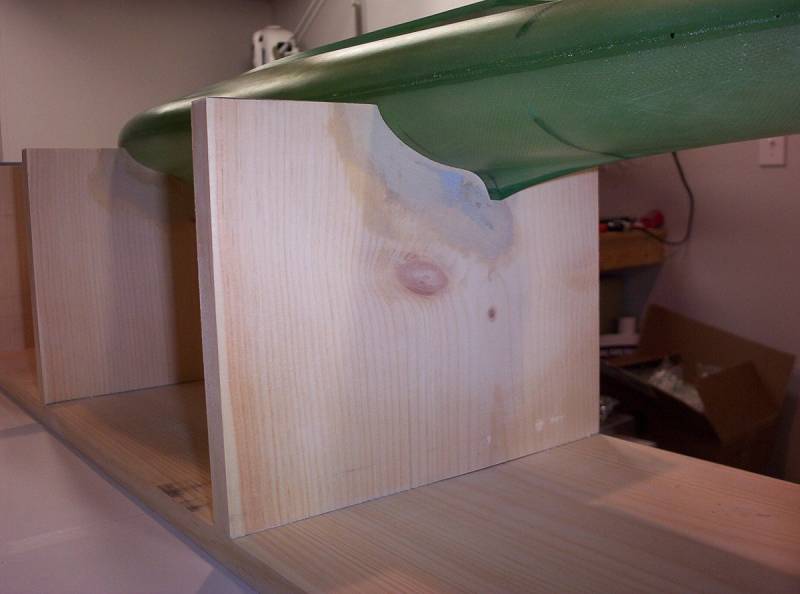

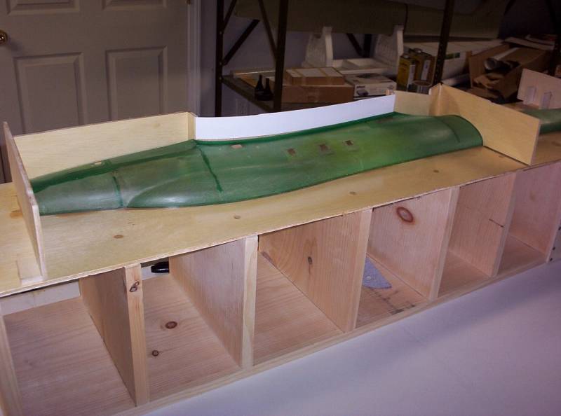

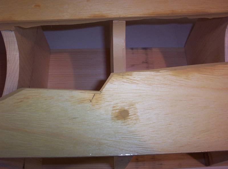

I know allot of you fellows are experienced mold makers so I don't want to go into too many minor details...But for the fellows who are just getting started I thought you may like to see this??
When the split line was first established my board was just rough cut to outline the fuse...Now I have used bondo to seal the gap between the rough cut and the fuselage for a nice mate which will require very little if any clay work prior to laying up...The way "I got there" was to first wax the fuse a few times...Then I used teflon tape wrapped around the fuse to give me a little relief (not so tight) and to ensure the bondo wouldn't stick to the fuse...
I'm also in the process of using sanding sealer on my wood so that is why it may look shiny and rough in a few pics...I also use sanding sealer over the bondo work I did on the fuse...All that will be sanded smooth with 220g paper before the final prep...(choosing a different material for your parting board will save you allot of finishing work that I'm having to do...Plywood isn't the ultimate!! I already had it on hand and didn't wanna go buy something else...Created myself some extra work...he he...But it'll be OK!! )
I'm going to be splitting this splash into a few pieces...I have some back-draft in the wing saddle area...And I'm going to split the aft portion of the fuse because of some detail and a little less "stress" while pulling the mold off the part later...Hopefully I'll be able to show that in a later today or tomorrow...
Anyhow here are some pics of the split line...Hopefully they make some sense??

Well Dang..This is all I have got so far but here is a little update:
So as I''m *hoping* to save my original Atlanta I''m breaking the splash up into pieces...A couple of reasons are to reduce the stress while de-molding and because of a couple of back draft areas that concerned me...All in all I''m trying to be as gentle as I can at this point...Just means allot more work (which I knew going in)...
These pictures may not make allot of sense right now?? It''s like a puzzle and will make a little more sense as time goes on...

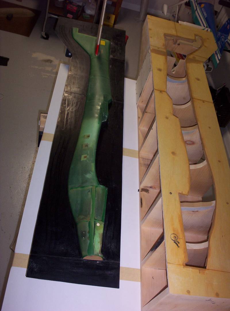

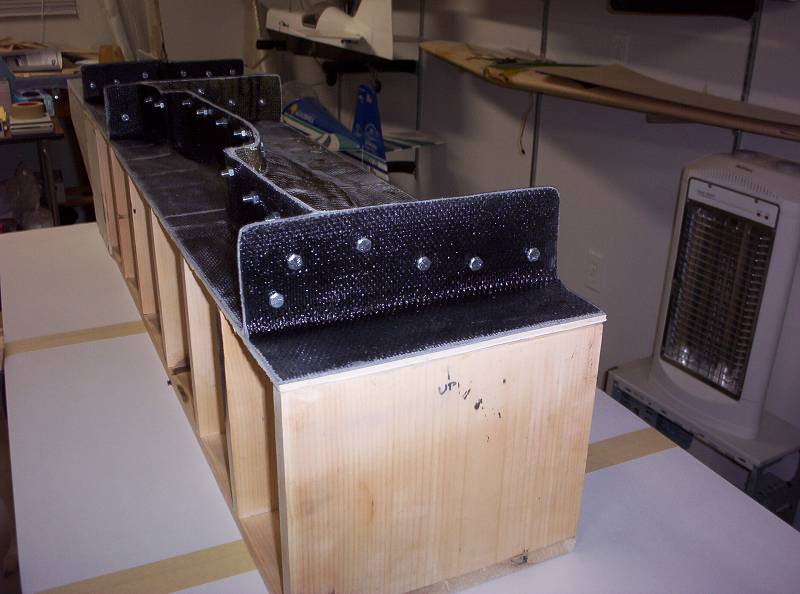

Yippie!! Now SSDD...
Yeah!! Damage to Aircraft = ZERO!!
I'm Very Happy...
Stage one complete...
