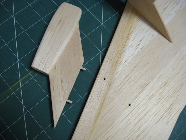

Thanks for continued interest in this thread.
The reason for my opening post is I want to try to complete a modeler's project he gave me before he died. Its a profile Lockheed C-141 Starlifter and may be using Jim Mayfield's design idea. I'm not a trained engineer, so I'm trying to gain as much information as possible to tackle the task. My primary interest is R/C, however, I dabble in C/L on occasion. C/L somehow falls into the progression of interest in aviation for my makeup. Maybe he abandoned it because he thought it wouldn't work well but I want to give it a go. Like someone I know once said - "I know just enough to get me into trouble" so here I am and I appreciate all the help I can get...
I've started work on it. Located fake engine nacelles to the best of my ability and pinned same to bolster attachment to wing. Followed preliminary wing cut-out noted in fuse to locate wing for (intended?) angle of incidence. Engine to be located between fuse and nacelle #3 - thrust-line normal to LE Like Jim Mayfield's Charger. Thinking vectored thrust here - more line tension than forward motion... Cat included in pic as means of size reference. To be .049 powered. Not sure if elevator should be inboard or outboard - shown inboard here.

Very nice work!
Looks like 35" to a bit over 40" total span... Close?
4 0.049s will certainly haul a model that size! I presume you intend to mount them on the pods? Possibly sidewinder with heads outboard?
I'd definitely consider good bracing for the pod mountings as well as the engine mounts. Beveled strip about 1/2" on the horizontal and vertical faces should do and it may be under the wing and pretty well hidden by the pods - so not distract in appearance.
Possibly also support the joints from fuse to wing, wing to pods, and fuse to stab & elevator. Lightweight fibreglas or carbon veil work well. Epoxy, scraped to barely damp works well on f/glas. An ordinary playing card, swept gently like trailing a wide broom, shouldn't pull f/glas fibers.
CF is a bit more touchy. Fibers pull out easily. If you still have any clear dope for finishing, a few light coats, thinned half and half, is good prep Let clear dope cure overnight, then sand gently with about 220 grit paper to knock down any grain fuzz. Wipe sanding dust off for the next coat. Careful to not go through to the bare wood when sanding.
Second coat may need only 300+ grit to knock down any fuzz. By this point, f/glas can be laid on the critical areas with that card squeegee method. CF is best attached with either very thinned clear, or straight thinner brushed gently through it to soften the dope surface and adhere it to the wood. When that's dried at least a few hours, a coat of slight less thinned dope will adhere it solidly. A brushed coat of a thinned surface sealer, then careful sanding with fine sandpaper should give a smooth, grain hidden surface for the colors and markings you choose.
As to the geometry of the wing... A bit complicated for here. The idea turns out to be finding the "centroid" of the wing. Fear not! That just means the point at the middle of the area. It can be calculated. It can be found graphically by adding lines to the top view of the wing. Or it can be found by cutting a piece of, say cardboard, to the shape of the wing and finding where that balances lengthwise and spanwise. More later: dinner bell has chimed

I'm really slow; its in my nature.
Knocked out the foam glider at scale of 1:1 because it was a no-brainer minus the cosmetic nacelles...
Added nose weight (a single 1/4" fender washer after removing one of two) to get a decent FF glide in the backyard. It seems like it would be really "tail heavy" for C/L. What little I know about model airplane design has me figuring about 50% MAC for FF, 30% MAC for R/C, and maybe 15~20% for C/L. Does this sound like good rule-of-thumb? Advice welcomed.
First pic of MAC layout not necessarily to scale (1/2 span is 15 3/4"); last pic shows where leadouts would be with CG as is for C/L (note - as trimmed for free-flight).
What I'd like to know is if I should move the CG way forward for actual control line flight.
