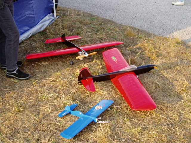

Below is a picture of the three Brodak ARF prototypes. The picture is stolen from a thread at the SSW CL Forum:
[link=http://www.clstunt.com/htdocs/dcforum/DCForumID1/7600.html]A couple more KOI pics[/link]
The picture shows three planes. the Profile Cardinal at the rear, the Oriental in the center and the Baby Clown in front. Specifications for the three planes (as kits) are:
[link=http://www.brodak.com/shop_productdetail.php?ProductID=CLP-47&catagory=172&maincatagory=2]Brodak Cardinal[/link]
[link=http://www.brodak.com/shop_productdetail.php?ProductID=CLB-2-9&catagory=176&maincatagory=2]Oriental[/link]
[link=http://www.brodak.com/shop_productdetail.php?ProductID=CLP-11&catagory=181&maincatagory=2]Baby Clown[/link]
Prices are not available as of this time, but the estimate for the ARF Oriental is $110±.
That should get your juices flowing!
