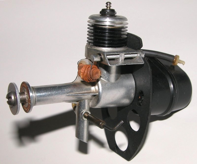

Here are some small Anderson Spitfire engines:
First are three .065 "Royal Spitfire engines. Next is a close up of the lower right one. Then a Spitfire .049. Finally a Spitzy .045 in a "Little Bipe"...the reverse pitch prop is just for show.
George
George

I was really into that 2-screw style of .049 that started with the Atwood Wasp. It was a quick way to mount everything. Very neat
When the Anderson Spitfire .049 came out it had the light blue muff, like the one George showed. Later on Anderson made them with natural muffs and I saw a couple with dark blue, almost black muffs.
With people doing their own anodise now I wasn't sure if the dark blue was factory or not.
My biggest complaint on the Spitfire is the prop shaft was very short. Mounting a prop with the prop washer was difficult with thicker props. A Grish Tornado was thinner and worked fine. Forget using a spinner on the Spitfire.

Well Here's some Atwoods and a Holland Hornet...all 2-holers.
Photo1: From lower left, Atwood .051 (with wounded muff), upper left Atwood .049, ur Shriek .049, lr Holland Hornet .049, center Atwood .049 similar to Shriek except 1/4x32 plug.
Photo2: Note there are no size markings stamped in the circle...perhaps so they could use same case for both.
George
George

RE: Small Spitfire Engines
John,
That is a pneumatic chamber..it connects to a black hose that had a line running back to the control handle where the pilot had a bulb he squeezed to operate the throttle.
I doubt the weight of the hose on the lines would have been worth the minor change in RPM.
It was real tricky looking but I doubt if it was really practical.
