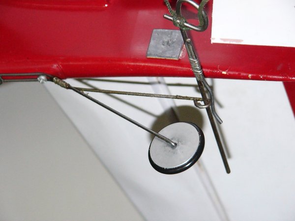

Anyone have suggestions or plans for building a launcing device so a person could fly C/L
when there flying buddys are not able to be there and hold aircraft?
I fly 1/2A and .35-.40 size planes on grass circle. I dont think fabricating a devise for the
larger planes will be that much of a hassel because of them being able to roll out on grass,
my problem is the 1/2A;s. Any suggestions?

This is the tail hook and release pin I use on my 60 size stunters (I don't dare show the bit that goes in the ground because it's so crude you'd laugh at me ). I like to have the tail hook as close to the UC mount as possible to handle the thrust load. For me the critical part is that bent clip which stops the pin from vibrating out.
