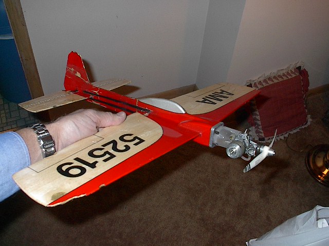

The Stunt Chimp is the same as the Carl Goldberg Stunt Man 23. I built one as a kid . This is the plane I learned to fly CL with. About 5 years ago I built about 15 of them with our church boys group. We used the Norvel .061 with the Norvel tank mount. We used Spiderwire,however .008 braided wire is better but requires more careful handling.they fly pretty well. I think it is an excellent plan to use to learn to fly CL. Here is a picture of one that has been crashed about 100 times. several people learned to fly on this one. My son my wife at least 3 teenagers.

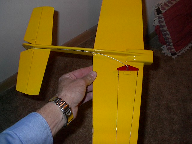

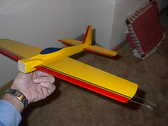

Here are a couple of pictures of a new prestine Stunt Chimp.

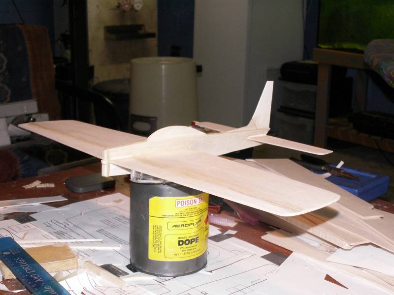

I just finished one of these myself, built from the plans on the Aeromaniacs site. Power is a Black Widow which has been doctored with a #5 TD.051 piston/liner and #1702 high compression head. Prop will either be an APC 6x2 or 5.7x3.
Mine came out a touch heavy, at just over 8oz. I'm considering sticking a Norvel .061 in it and flying it on longer lines just to see what happens :-)
I haven't flown it yet. I took it out the other day, but my battery died after a couple of flights with another model, so it came home still a virgin.
This was my first new model in nearly 20 years, and a fine, easy to follow plan, to re-awaken my very rusty construction skills.
