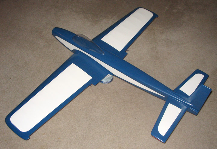

I have a model I've sprayed with Brodak dope. I want to add lettering to the wing such as my AMA number, etc.
How do you c/l master painters mask off for painting letters? I could use use decals, but are they dope proof?
Here's what I was thinking:
Print out the letters on printer paper.
Cut them out with a #11 blade.
Tape the "stencil" onto the wing.
Go around the edges of the paper cutouts with 1/8" Scotch plastic tape.
I'm sure there's a better method.
Thanks. Here's a pic of the plane:

Curious. What did you use to mask the white/blue on your plane? Wouldn't that work for masking letters as well? An old wing covered with the same products would be handy as a test surface. Also, I've had pretty good luck with vinyl electrical tape for masking. Keep your font simple, like Aerial Bold.
