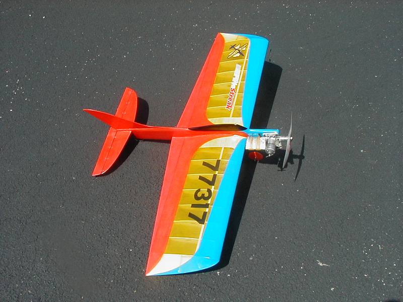

Here is a photo of my Flite Streak, with Rivers Silver Arrow diesel. It now has ST G20-23 glow. Covered in silk, with the red on the wing being red tissue, blue is Aerogloss Curtis blue.

Jim, how do you get that look of what appears to be a clear yellow? Is it just clear dope? I like how you can see the ribs.
Also how easy or hard, is the colored tissue paper to work with?
RE: flite streak
Well, I cheated a little on the colors. On the red parts: red silk on fuselage and tail, red tissue on wing, I poured a little, few drops, red Aerogloss Stearman red, without mixing it up, into Sig Litecoat clear. I brushed this on like it was clear dope. There is enough texture on the silk and tissue that you can't see the brush strokes. I have some yellow dye in butyrate dope that a friend gave me. It was dye sold for use on polyspan. Put some of this into Sig Litecoat and sprayed the red and yellow (yellow silk) parts of the airplane. Then masked off the blue and black areas and painted them with brush. Didn't get any bleed through of the yellow. The numbers are cut from black art tissue.
I put a couple of coats of very thin clear on the wing before sticking the red tissue and black numbers down with thinner.

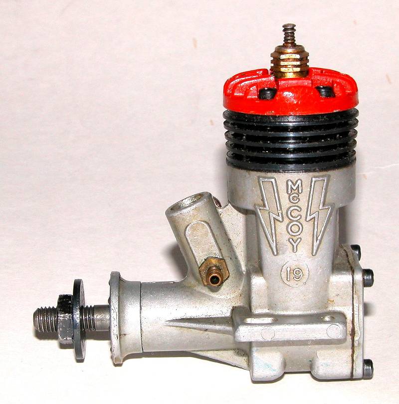

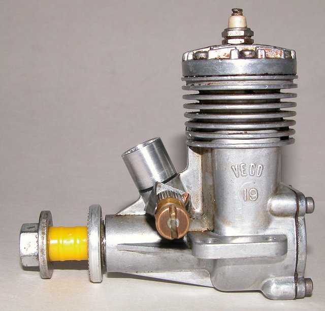

Jim,
That's a beauty.
Got me thinking 'bout getting another F/S Jr. for one of my old .19's.
Maybe I'll try this Veco .19 this time. Also have a McCoy Stunt .19 and a Testors-McCoy .19 Lightning Bolt case.

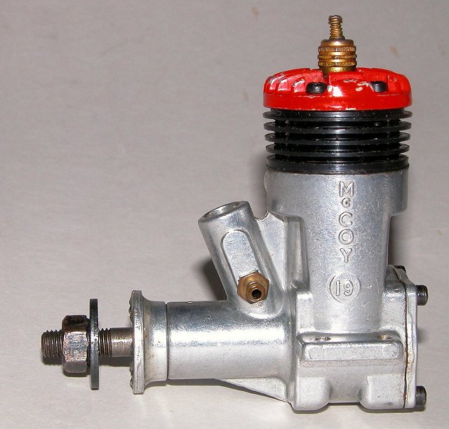

Lou,
My McCoy Stunt .19 has a lapped piston with the window type sleeve.
Picked this one about ten years ago and haven't run it yet. It has plenty of compression and seems very tight so it probably has very little running time on it.
I had a .19 and a .29 like this back in the '50's and they ran pretty well but were not quite up to the performance of the K&B greenheads.
