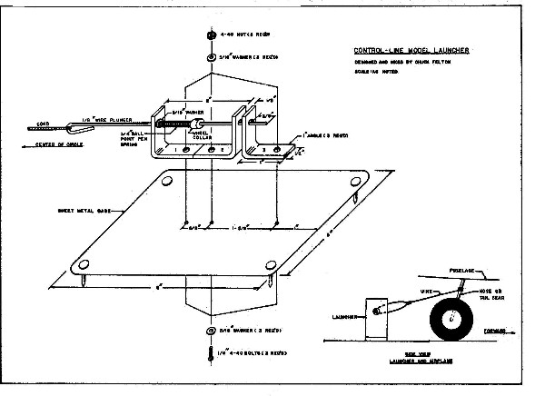

Use a launch stooge. Look here, http://www.clcombat.info/stooge.html That will show you some different types mainly for combat models.
Also look here, http://rulecombat.com/ same deal, it's for combat models.
My favorite type is pictured below. I have used this with a Hyper Viper the only change I made was to bend the Viper's tail skid into a loop at the end to engage the launcher.

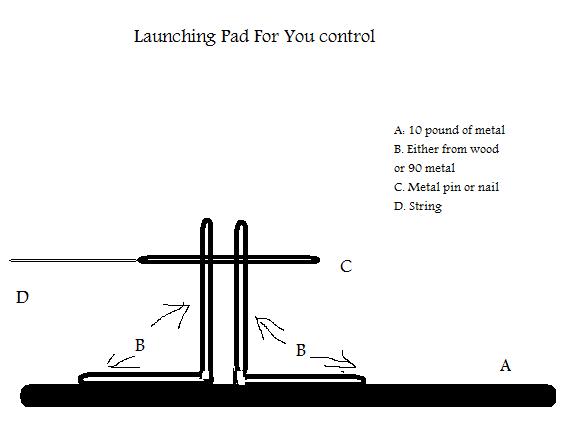

yea post some not just for me but for the people that also going through that. I made a drawing that should work what do you think fairly simple
but i don't know if i can use a lighter base since i usually use my bike instead of car.

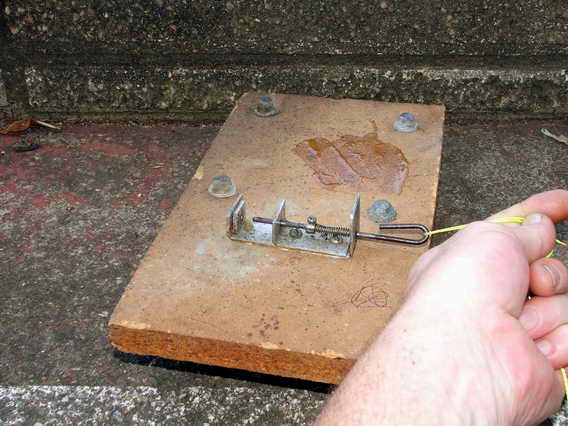

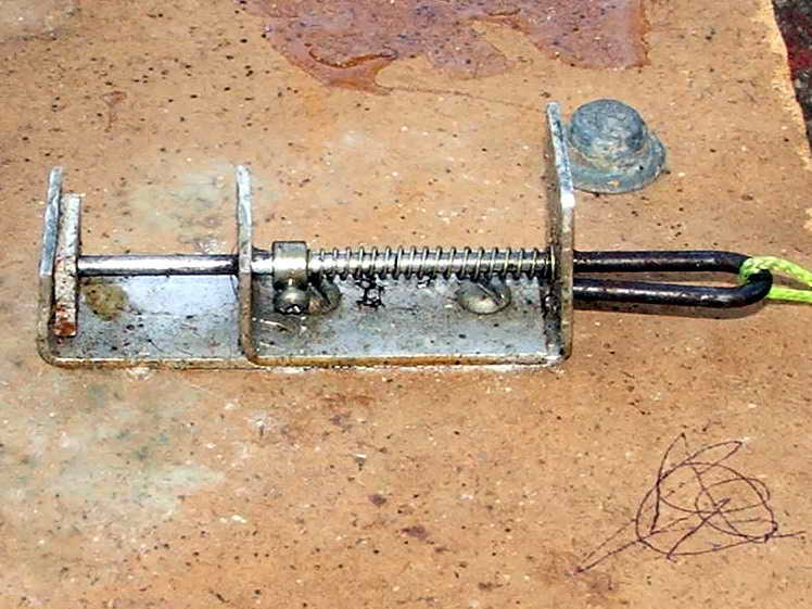

OK,
here is my launcher, crappy but functional. The base is chipboard and the four knobs are the heads of old roofing nails which go through the board and spike into the ground.

how about if ur on a black top, how r u going to use that thing if u cant use nail through cement

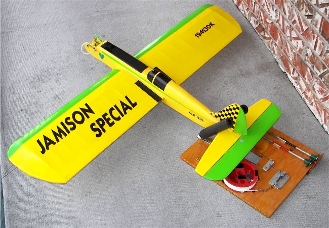

When I moved to another state and got permission to use an unused ramp area at an airport, I searched the concrete until I found a seam that had a couple of holes in the fill asphalt (asphalt seam filler in the concrete). I drilled a couple of holes in my stooge that suited the holes in the seam and was good to go without needing a weight.
Modelers can fix anything.

I've got one stooge that uses the stab release method. Works O K as long as you don't try launching into a heavy headwind. I had the wind switch around on me one day and I didn't move the stooge. The wind was really blowing hard right at the nose and ended up backing the model up to the point it was free of the stooge or more likely just blew the nose up to where the angle was steep enough that the model was able to take off over the top of the padded restraints. Either way I had just picked up the handle and looked back at the model and it was pointed skyward about 4 feet in the air over the stooge! I quickly backed up finished the flight. I went home after that due to the high wind though.

And the model is nice too. But I'd suggest a prop with a bit more pitch.

Nice workmanship on the stooge.
Thanks. I can't take credit for the plane though. I bought it already built. The little block of wood with the two nails sticking out is to poke in the ground next to the left tire so you don't inadvertently pull the nose of the model toward the pilot.
