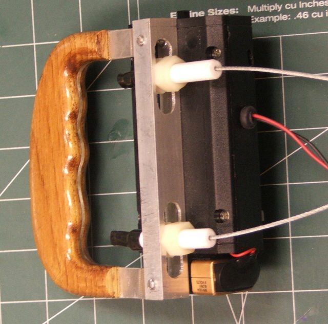

RE: C/L scale handle
Here are a couple of shots of the handle I made to house Clancy's encoder. The top slide is for throttle, and the center round knob is a 5 position switch for the cooper bomb rack.
Steve
Steve,
Yours looks similar to mine, just prettier. Just looking for insulators to replace the
normal line handle wire with fixed connectors. Will try to post a picture when it is finished.
Jerry
