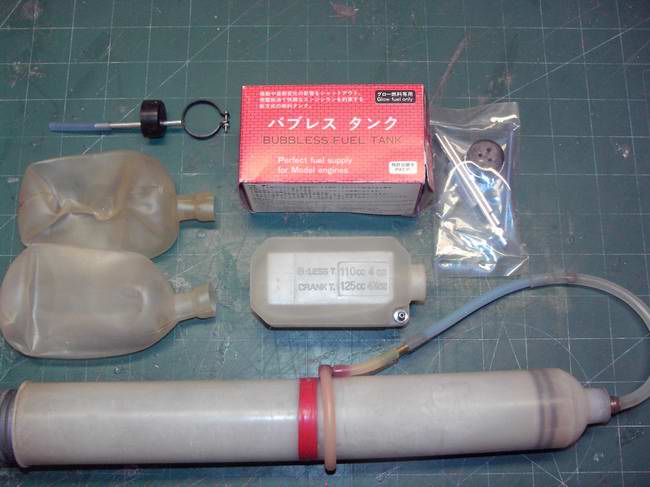

I get constant attitude from controlline traditionalist whenever I suggest a modern Tetra or Jett bubbless tank for controlline but you cannot find a better more uniform and reliable fuel delivery system and with no fine tuning required. Think about that 'no fine tuning of the tank'.
Try it once and you will never go back to conventional controlline suction systems.
RE: Tank location?
It is not an expanded bladder providing high pressure such as used with some combat types but it does provide muffler pressure if muffler pressure is avalible in a far more effective way than the common RC muffler pressure/suction systems and far better that the common controlline suction systems.
It uses a hard outter shell that look a lot like a common RC tank with an inner bladder. There is no clunk only a single fuel line to the inside of the bladder in the middle. Muffler pressure is routed to a nipple that applies pressure between the hard shell and the inner bladder. Therefore no combustion gasses can ever reach the fuel and no air can be introduced even from just fueling when done right. This makes bubbles impossible from a full tank to the very last drop. You will not get a more uniform delivery for the duration of the run with any other unregulated system.
Additional hugh advantages are they will perform easily aft as far as the CG and tank position or orientation is not critical at all.

Here is a link to Tetra bubbless tanks at Central Hobbies, avaliable from three to fourteen ounce.
Not cheap but I will use nothing else in any controlliner with muffler or pipe pressure avaliable or any of my pylon ships and on occassion some problamatical sport RC applications.
Be carefull and assure you are buying bubbless types if you do because they also sell numerous conventional clunk type tetra tanks also.
Jim reversing the plumbing on genuine Tetra bubbless and placing the fuel between the bladder and hardshell certainly may work however makes no sense at all. At best it will be slightly less efficient with the poorly placed pressure port in the hardshell now becoming the feed line.
That silly idea is best filed away with ideas folks just cannot resist in attempts to fix imaginary faults or problems that just don,t exist.
