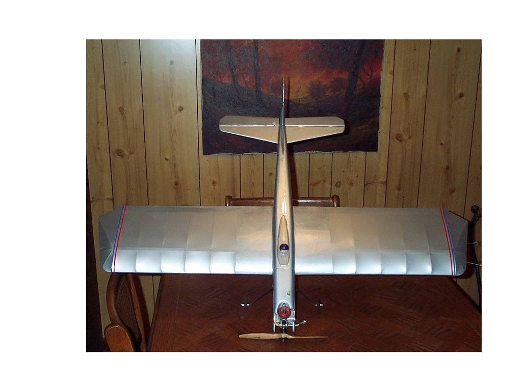

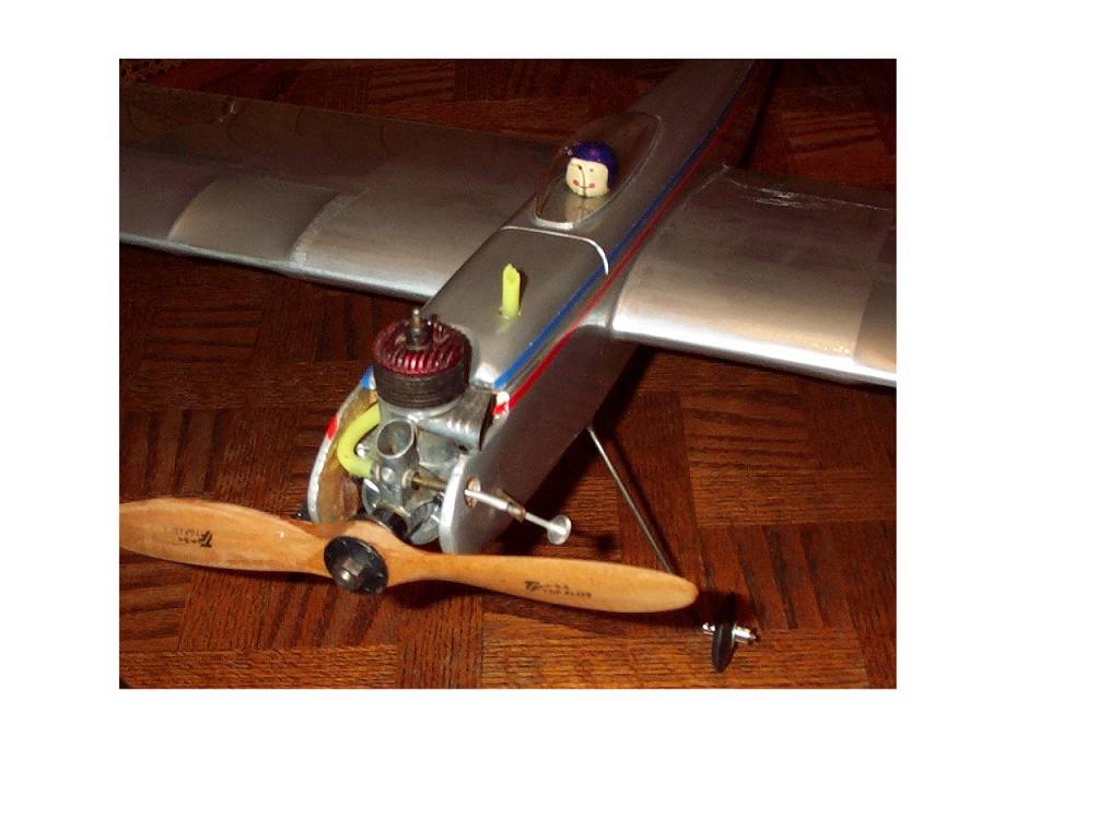

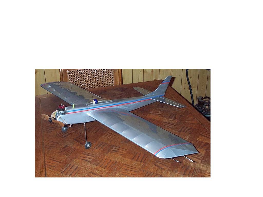

There were 2 different Tom Toms. not sure when the design change was made before or after Dumas acquired Veco.?
If it is the one in the pictures below then I can help. When building this one I traced the parts onto the back of the iso plans.
Will have copies made soon and have someone on another site waiting for a set.
Let me know.

That's IT!
I want one!

You just like the pilot fiigure!

The pilot is some kind of doll head from one of the places in town(Michals? Hobby Lobby? Academy??????)
The helmet area was done with felt tip pen. came with 5-6 in a package for couple of dollars.

Thats the later version. The earlier version is decidedly different. Turtle deck, canopy and generally a more interesting model.
Larry Richards kitted that version and it was an excellent kit. Sadly he's retired from the kit business.

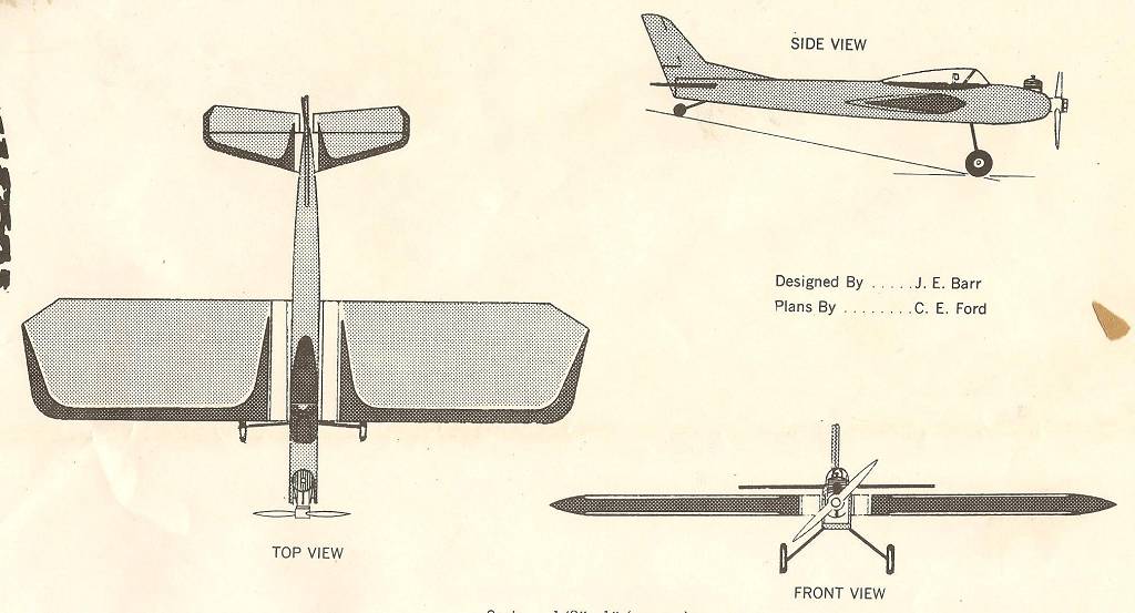

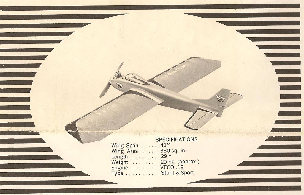

Hi All
Took plans to town then forgot about them!
Absent minded.
Lets see if I can make this work.
Some one make a test run and make sure size is not distorted from electronic transmissions.
When the vertical dashed lines are lined up fuselage length on tracing is 26 and 1/2 inches long
The push rod length on the original plans is 16 and 3/8 inches long C.to C.
This will probably take several post.
Save to my pictures.
Open with windows picture and fax Viewer and print from there seems to give me best results on the sizing.

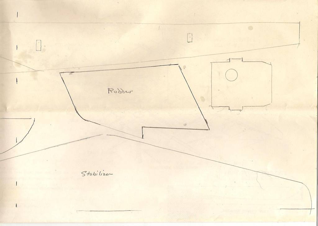

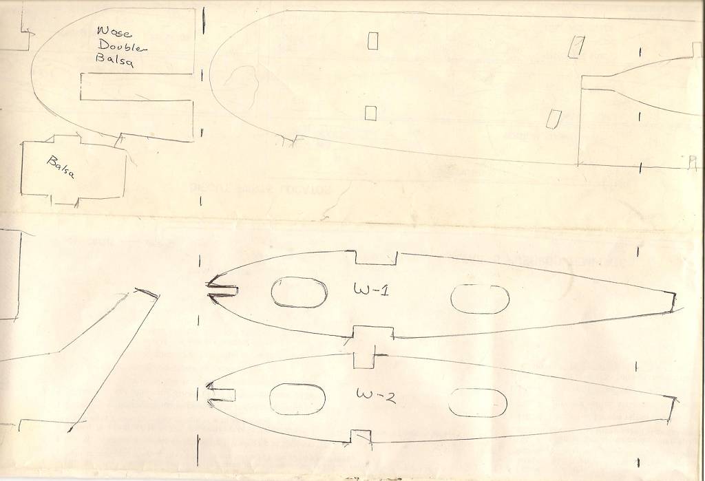

Tracings
The crude die cutting, stuffing drawings into small scanner and probably done in a rapid hurry they need some checking.

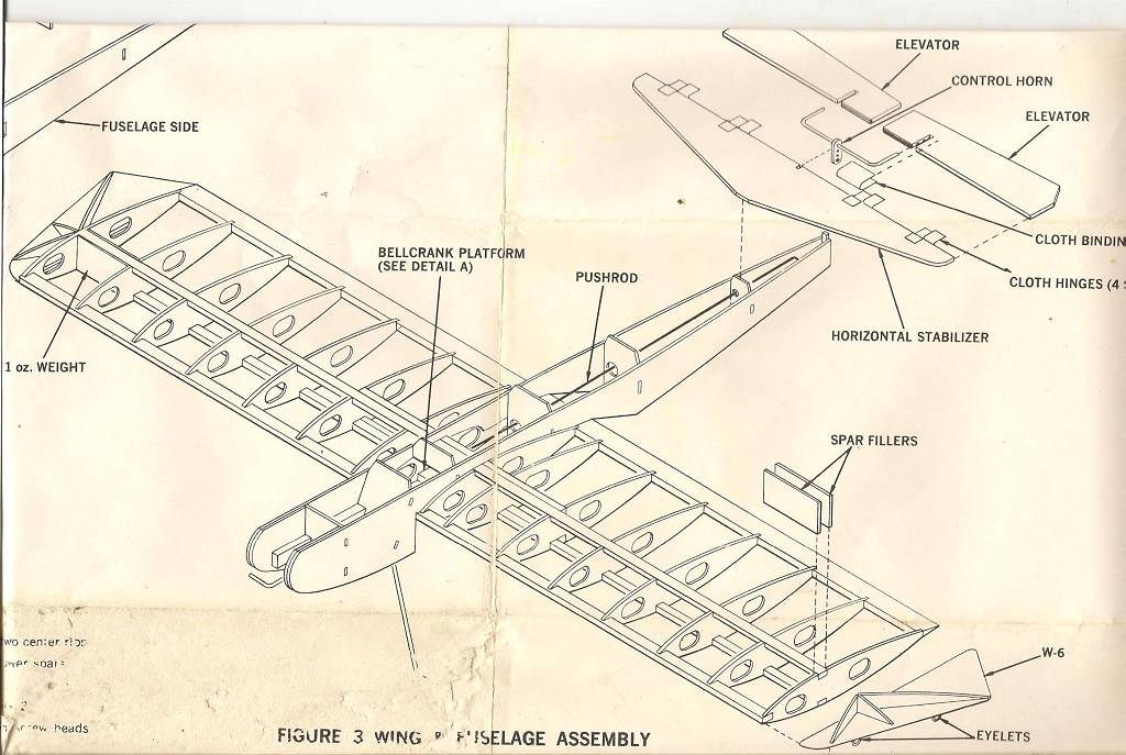

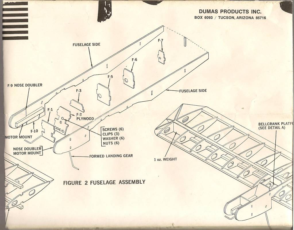

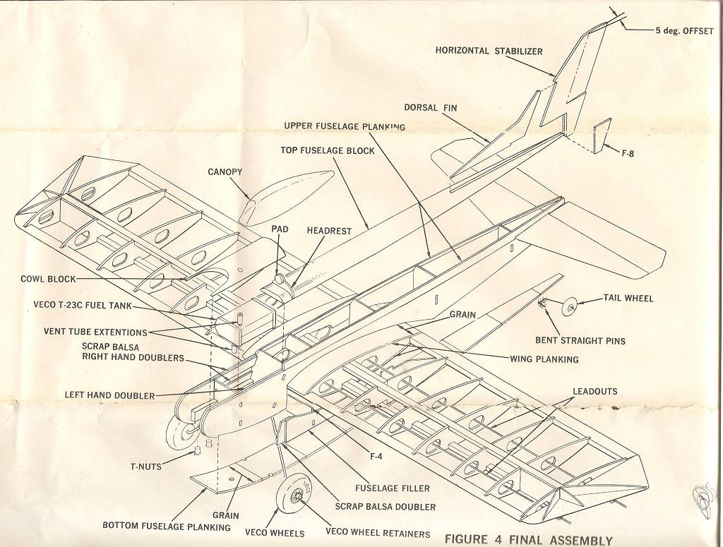

Iso-
The 2 inner W-1 ribs should not be glued to spar,L.E. and T.E. until after main fuselage is installed on to wing.
The length of spars L.E. and T.E. is 36 inches.
The rib spacing BETWEEN ribs is 2 and 1/2 inches.( not for center ribs)

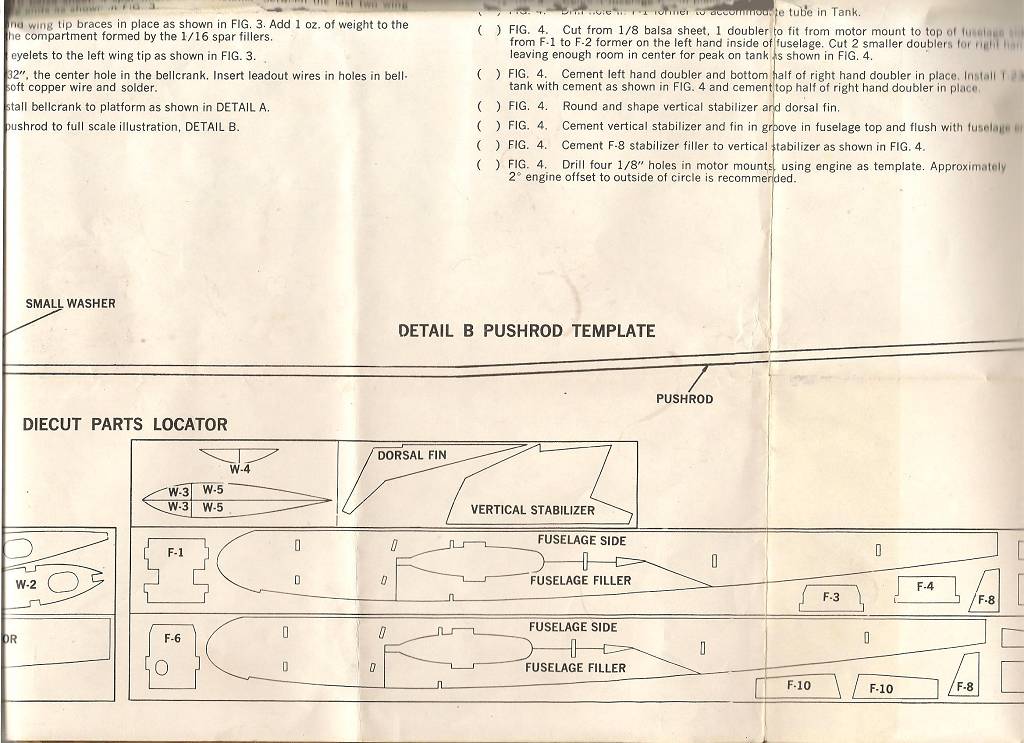

More
These are not full size parts but can be used to make corrections like adding to the bottom rear of the rudder.
Parts bill
Pushrod

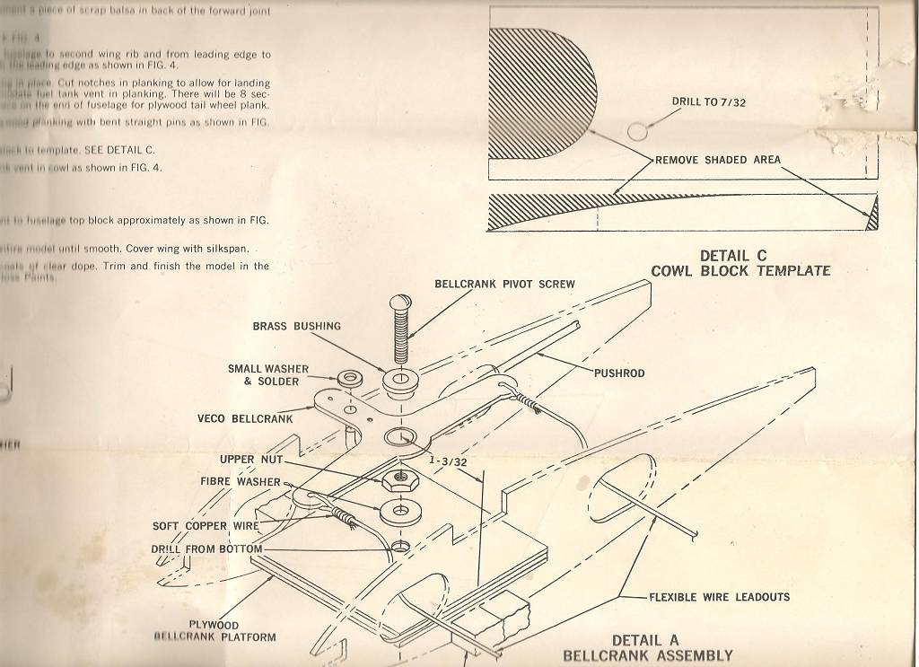

Bellcrank and cowl block

give us a rib lengthit will help. The thing looks a bit small when I print.../

7 and 11/16 inches on tracing of rib W1.
This is from C/L at T.E. to the longest point at L.E.
Note that the T.E. portion of rib is not square. This is correct but may need changing for currently available wood.
