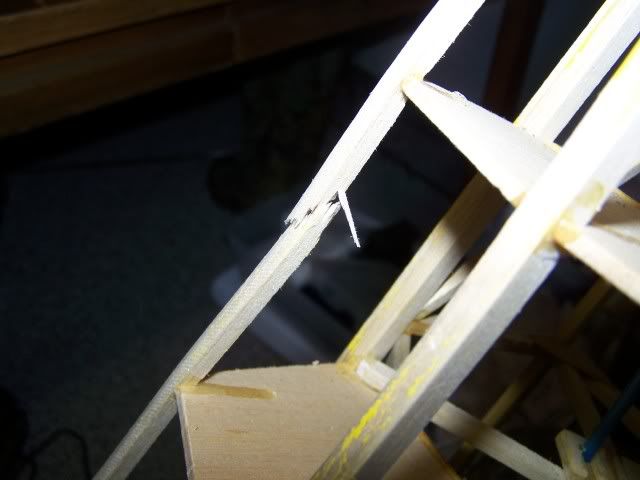

Just picked up this plane from a club member for free, it's a kit and he built it along time ago. The wings broke free at the fusalage other then that no damage. I will post on this thread of the rebulid and questions I have. I plan to recover the whole plane and paint it with normandy colors. I've never done this before so I will have lots of questions.

Questions; I'm stripping the wings and finding dents and cracks. Do I CA the cracks and use filler? And what is a good sand-a-boul filler?

You could Ca the cracks but alittle PVA on them would be better and allow athin film of pva to spread over the crack so it gives it alittle extra strength and grab. As for the dents, try some wet toiletpaper and place it over the dent and try get the wood damp and leave it for 12 hours or so and keep wetting the paper till the dents lift up, you may also need to sand the area afterwards to level it all up, that should help raise the minor dents however any serious dents will need inspecting to see if they are going to structualy impare the model. but yes get the wood in the dent to absorb alittle water and it will bring it right back out, takes time but far better then adding weight on with fillers. hope this helps
incedently if you cut out the shear web where the damaged sheeting is it may be possible to put a thin sheet of balsa behind the cracks in the sheet to reinforce that area and that should work a treat.

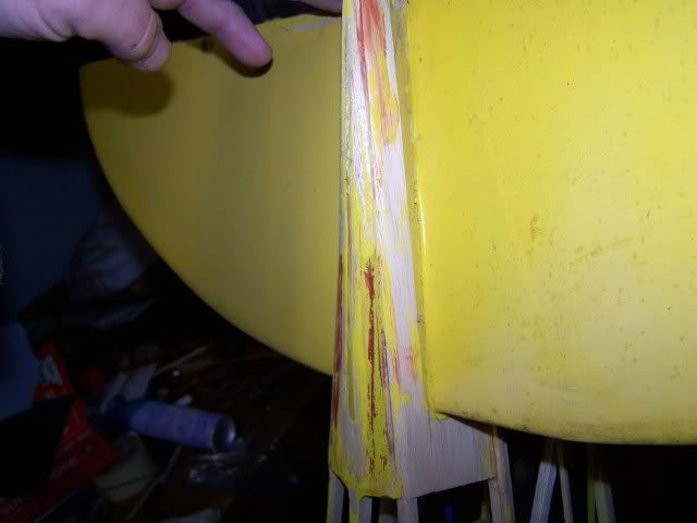

Took the tail apart last night. It was weak and moved around w/the covering on. Found some repair needs and reinforcing to do. The rudder stab came right off and the elevator will come off w/a little work, the top half w/broke away already. Here’s some more picks. Question; what’s a good light wt filler. I’ve used hobbylite filler. I would think there’s better out there that’s EZ’er to work with. Also, on the planes I have it shows how to make shock absorbing landing gear using aluminum tubing. I was thinking of using carbon fiber and JB welding the metal ends. Here’s some more pictures.

It looks like all clean fixes for you... it will be a different plane when you get through with it.
And, if you come across some epoxy joints that need to be unglued, try using a heat gun to soften the epoxy and you might get lucky with separating the pieces.
IMHO, for filler, I use what I find in the home center. I started out using hobby filler but, after someone suggested it, I did not find any difference in weight or sandability when using the stuff from the paint section of HD or Lowes. Just use the good stuff.

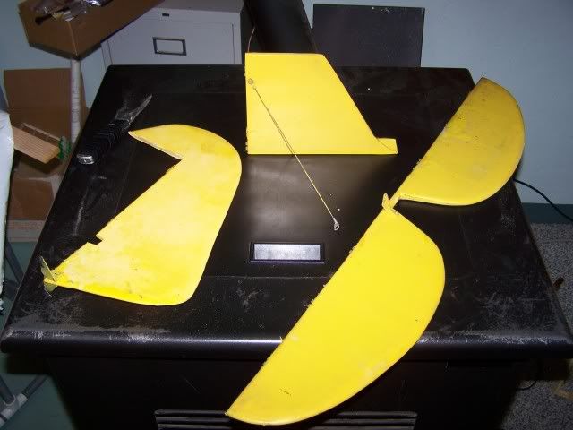

Finished removing the old covering on the tail feathers. The wood on all the hinge services are in ruff shape. Looks like someone replaced the old hinges once before. Unless someone has a better idea I will replace all the hinge wood. Here’s more pict.s

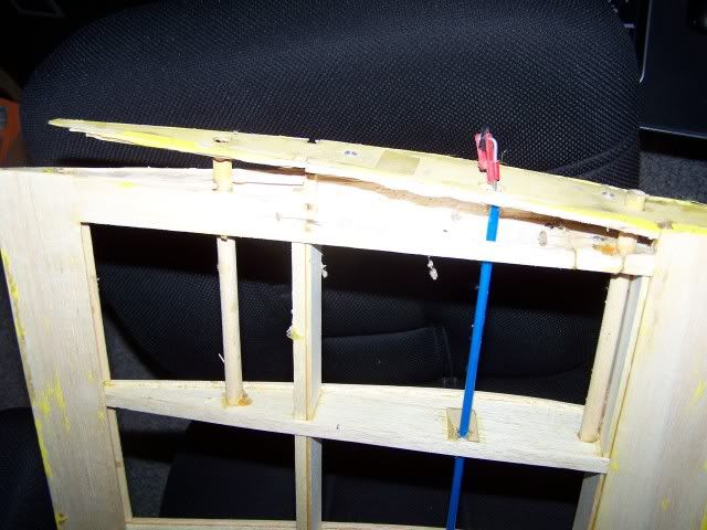

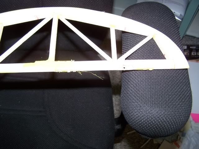

I have all the covering off and working on the wings where they attach to the fuselage. Reinforced the wings and fuse. Starting on the tail fathers next, here are some pictures.

Looking at your newest pictures, you don't say how thick it is, but that much balsa added to the fuse makes for a lot of added weight. Did you consider just replacing or reinforcing the weak stringers in the fuse? The portion of the fuse from behind the wing to the tail feathers doesn't really have much stress on it. Also, if the plane was balanced properly prior to your refurbishing, you'll need to add a lot of weight in the nose to counterbalance all the wood you're adding to the tail. I'm sure that the end result will be that the plane doesn't fly nearly as well as it could.

Very thinn balsa. All the glue joints were old and lose. Not much wt. at all.
