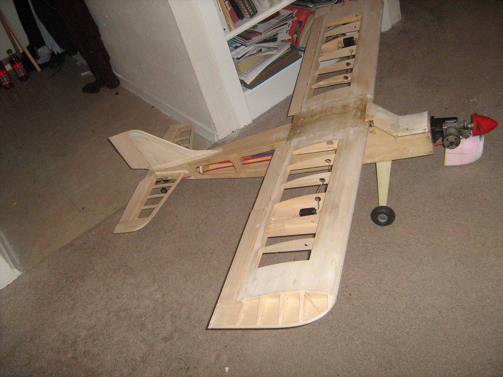

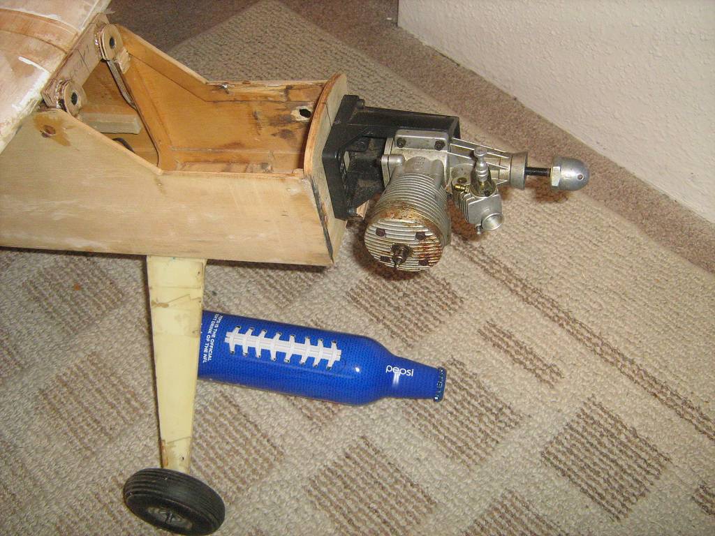

This may not technically be a crash and rebuild, but it sure is a rebuild of a very beat up plane from flying and many moves.

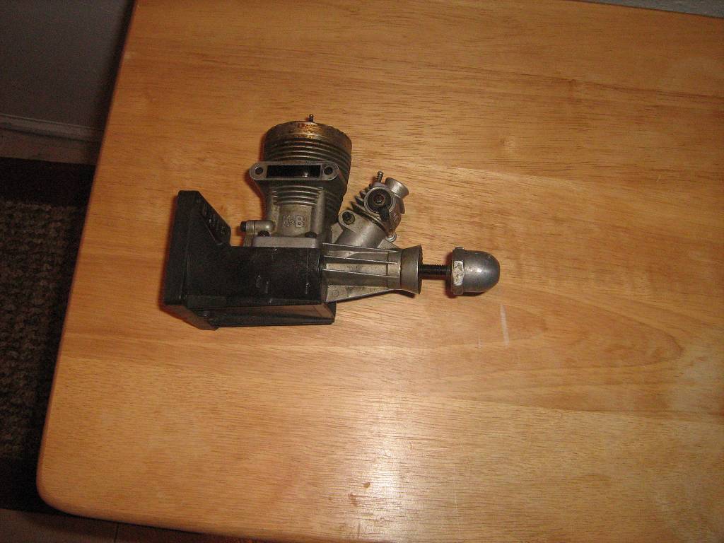

I have been working off and on, on this airplane since about February of this year. I got it second hand about 15 years ago. I t was a cheap ARF, unknown name. Tri geared. Original power was a .45. It flew ok other than it was very unstable in yaw on landing approach, unless you kept the approach hot and a low AOA. Tried extending the vertical stab up about 1.5”, it helped but did not completely solve the problem. I put a small sub fin on the bottom. The stabilized it nicely, but I kept striking it on landings and braking it off. I flew it on floats a few times. Didn’t break the sub fin.
Power this time will be a K&B Sportster .65, just because that is what I have available. Power this time will be a K&B Sportster .65, just because that is what I have available. Muffler will be the Aluminum Long neck Pepsi bottle.

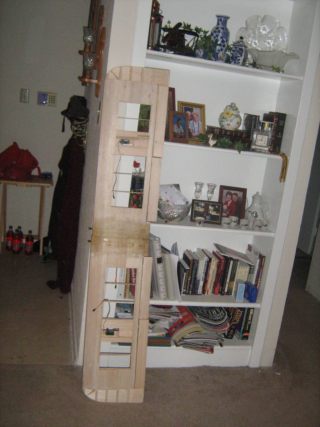

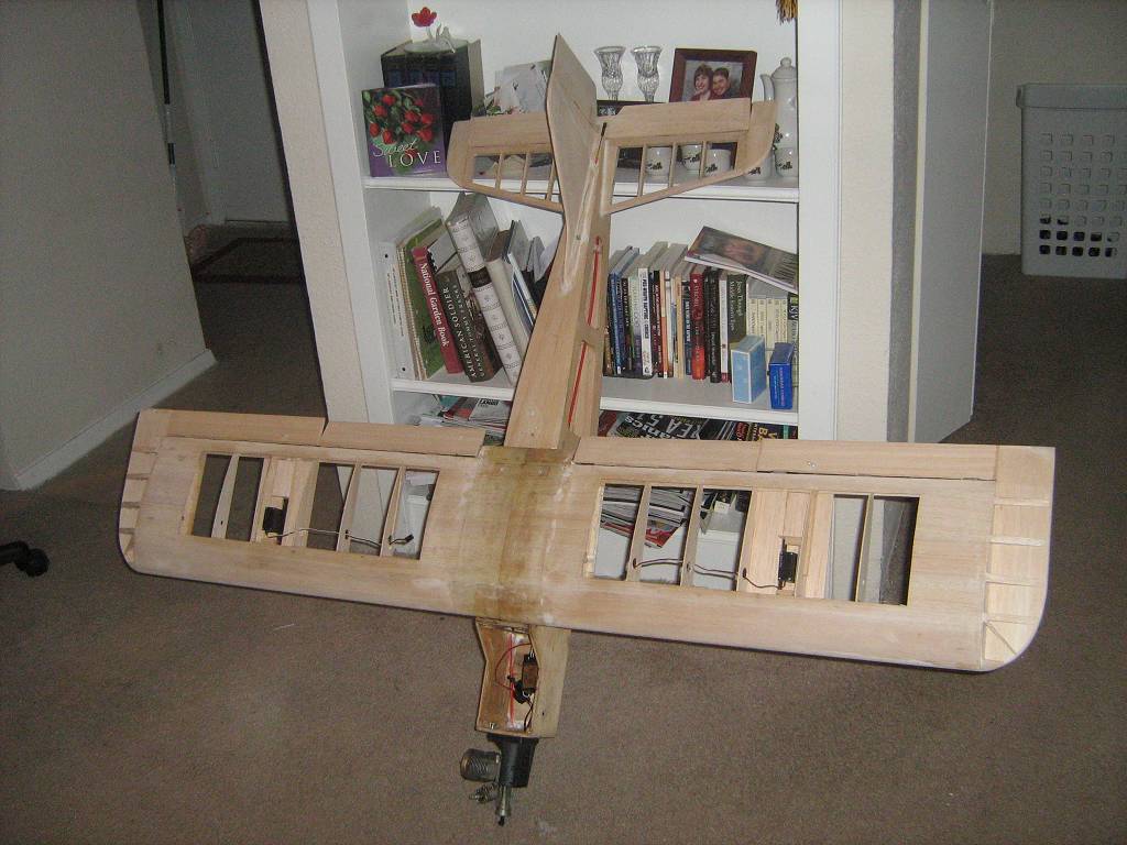

I started by completely stripping all covering. Had to use dope thinner to get all the film glue off. It sure was not MonoKote. The covering’s glue was very sticky and had the pigment in it. It was a bugger to get it all off.
I removed all the control surfaces, as I intended to replace them with larger ones anyway. I also intended to install flaps.
After clean up I enlarged the vertical both wider and taller, and a bigger rudder.
New elevator, bigger.

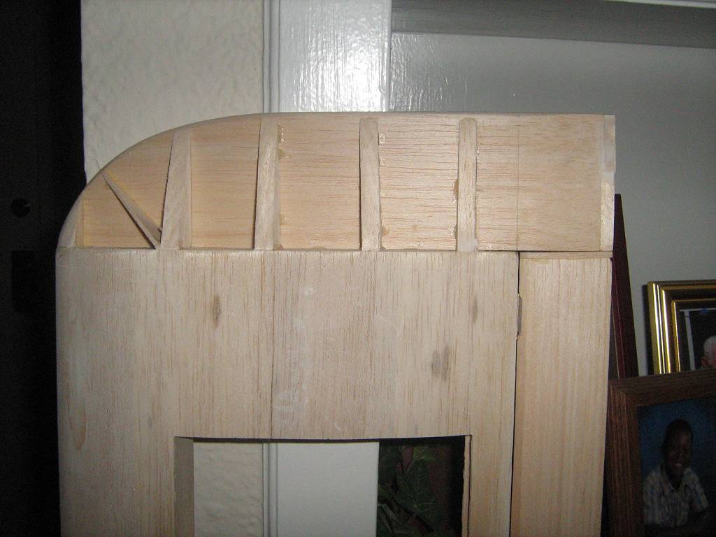

Made wider ailerons but only the last halve of the span. Flaps inboard of them.
It should be rather quick on the controls. But that is what expo is for.
New wingtips, the original were plastic and badly cracked.
The wingspan is now 54. 12” inch chord. 648sq” of wing.

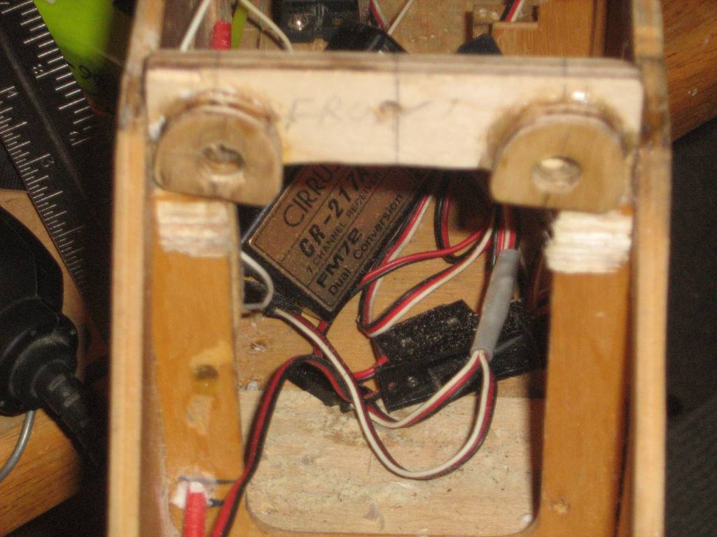

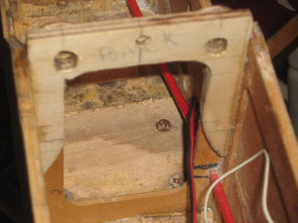

The wing was originally rubber banded on. I sawed the mount dowels flush. Add an extra layer of ply wood, extending below and forward of the ¼ 20 nylon wing bolt anchors. I felt I needed to distribute the loads somewhat. I also installed two pieces of arrow shaft in the front of the wing. Made sure I carried them all the back to main spar. I glued a piece of ply with 2 holes drilled for the arrow shafts to front of the spar doubler. I did the same thing at the Leading edge. This ply doubler was cut to the height of the L.E. and extended to the last rib that had center sheeting. I added a piece of 1/8” carbon plate as reinforcing washers for the holes the arrow shaft were to go thru in this doulbler as principally it was inteneded to carry the loads of the hold down dowels (arrow shafts).
I also raised and reinforced the first bulkhead in front of the wing. Were the hold down dowels go thru it, that has an additional thickness of ply add to it.

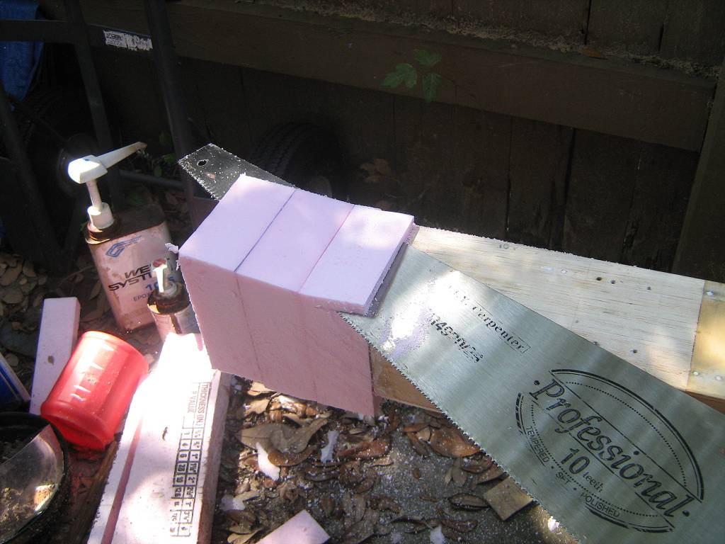

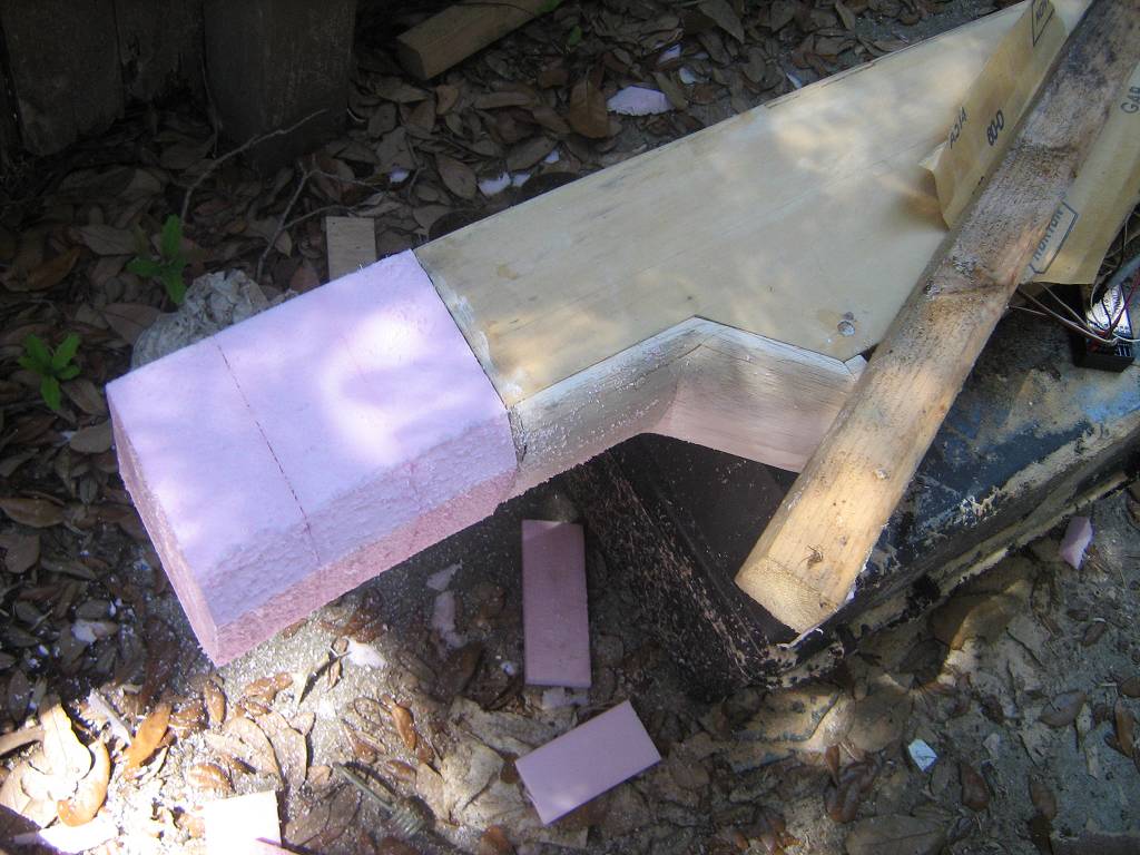

I made a mold for a fiber glass engine cowl. 3 pieces of 2” thick pink foam laminated together. I was certain that making the mold would be a super simple and fast really job. I was wrong. Bad approach to the job. I originally traced the fire wall onto the mold blank and drew center lines. Then I started carving and sanding to a pleasing shape. But when I stuck it back on the fire wall I then realized I had goofed big time. Ended up with a bad case of droopy snout. The down thrust built into firewall threw every ting off. Versus starting all it over, I added shim material to the bottom till my center lines were back on the money and that it would center around the prop shaft. Then I did some reshaping.
Next time I will just use screws to hold the mold blank to the firewall and shape it while it’s attached.
There is about 3° down thrust and 2° right thrust on the engine now.

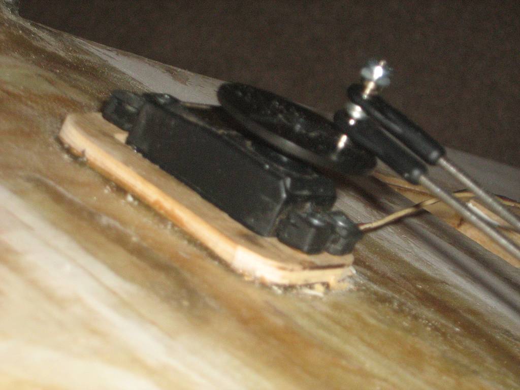

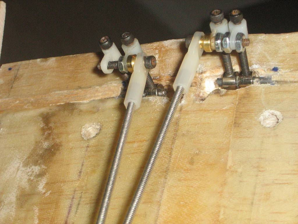

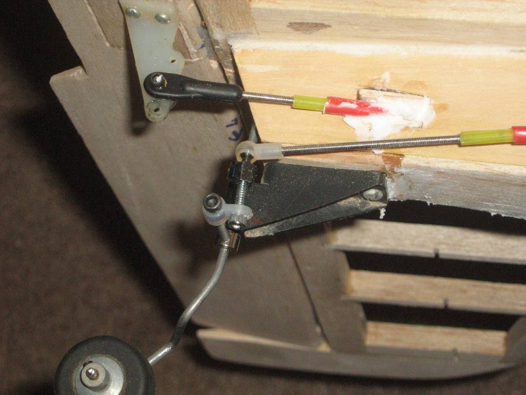

I am using swivel links on the controls, both ends. They really help to reduce any slop or play in the controls. The very little bit I do have is all in the servos. In the past I used snap links or and z bends. Even when it started off pretty tight, the holes in the control horns or servo arms would enlarge over time. I don’t think that can happen now.
Using swivel links similar to these
http://www3.towerhobbies.com/cgi-bin...?&I=LXFPW7&P=0
The flaps drove me nuts for a long time. I am using 1 servo to drive both halves, and just stacked 2 swivel links atop each other. 4 40 all thread is what I am using in between.
The flap torque rods are 4 40. To ovoid have to bend and align the unthreaded end, I have the threaded end going into the flap, and put a well collar on the other with a 4 40 Socket Head Cap Screws as the horn with STRIP AILERON HORN CONNECTORS threaded onto the bolts. The swivel links then bolted to those. No play, well a little bit in the servo.
Just a snap ball link on tail wheel.
Much to my dismay and surprise the STRIP AILERON HORN CONNECTORS would twist slightly when moving, changing the flap deflection just a little. So I added a second collar / bolt and STRIP AILERON HORN CONNECTOR, and just passed the swivel connector bolt thru both. That solved that. Not very elegant, but I will come back and revisit them.
Might even take some bar stock and make my own collars that are drill and tapped for 2 bolts and 2 set screws. Then replace the STRIP AILERON HORN CONNECTOR with a pair of brass barrel nuts with a brass tap soldered to it (pehaps silver solder?).

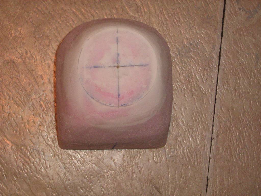

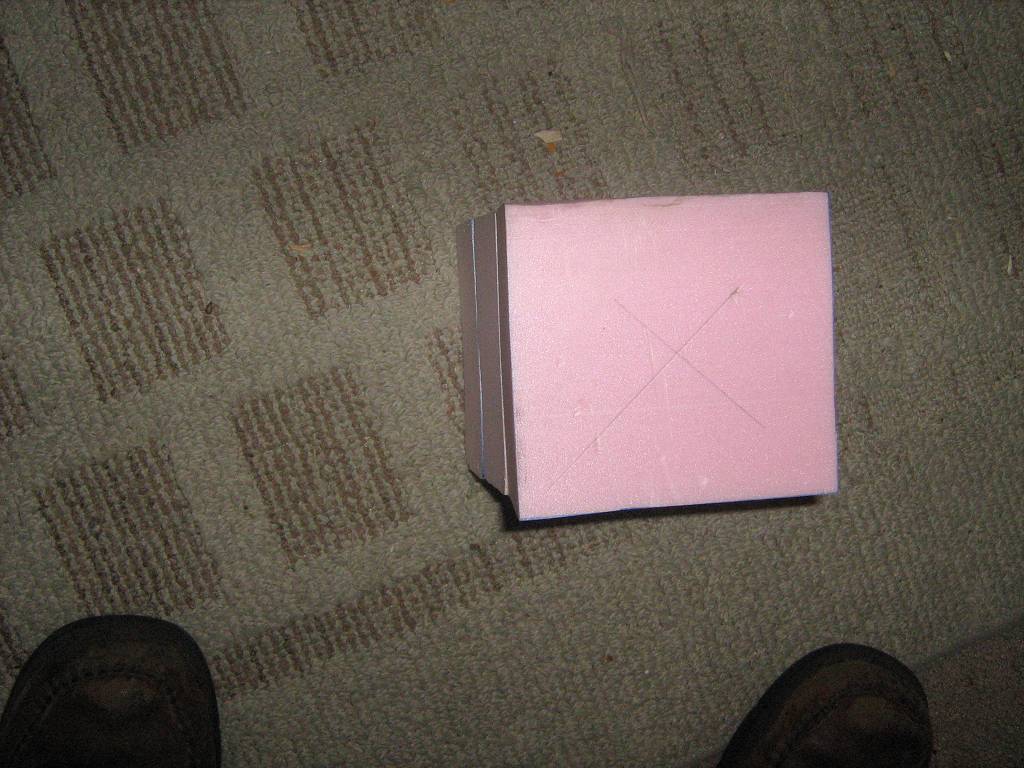

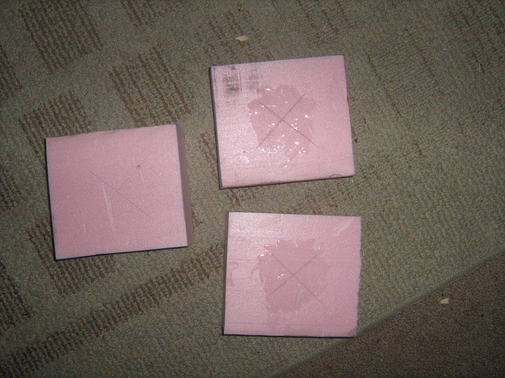

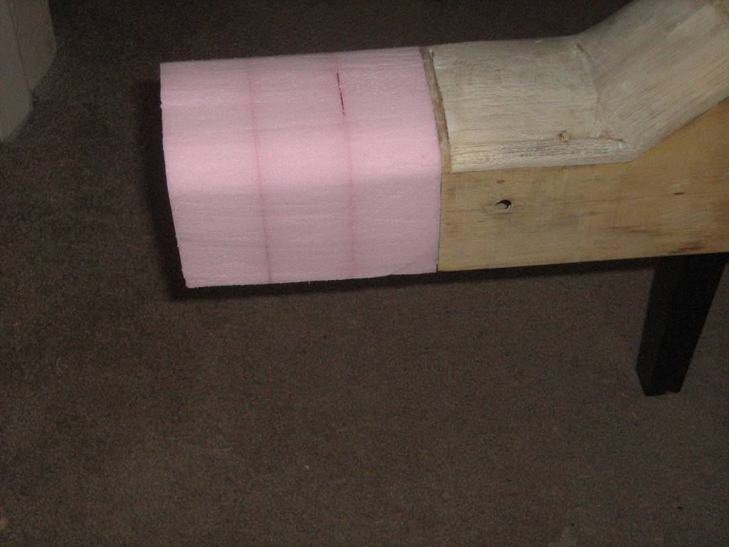

Remounted the cowl mold, and saw that it had some fit issues (sub size) that I just was not going to be able to readily fix, also I was not happy with the front and how it it would mate up with the spinner.
So the first has to be considered a learning experience.
Just cut 3 more foam blocks and epoxied them together. I only put epoxy in the very middle so as not to have a hard glue line that would be all but impossible to smooth and shape.
I will screw it on from the back using sheet rock screws through the motor mount bolt holes. Then sand the sides, bottom, and top to match the nose of the plane with a sanding block. Then transfer my alignment lines. From those marks and lines I can transfer the angle of the engine and length to the front of my new mold This time I will make a hard ply spinner ring and glue it on. I have to be sure and subtract the width of the ply ring from the mold.
Then with the mold screwed to the firewall I can start shaping it.

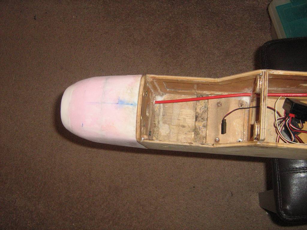

OK New foam block ready to start rough shaping
Had a bad scare when I went to take the last picture. Camera would not power on. So after checking batteries and card I took a good look under the battery/card cover. Did not look right. Did not see a metal battery connection tap on the inside of the cover. Some looking and I found it on the floor, very slightly bent by my shoe I'm sure. Put it back in and a course it it not stay on its on.[&o] So I built up a little bead of super glue across the plastic pins that go through the middle of it (using a tooth pick to apply) and then set it with kicker also applied with a tooth pick. HOT DOG, IT WORKS. I will keep an eye on it in case it needs a more secure repair.

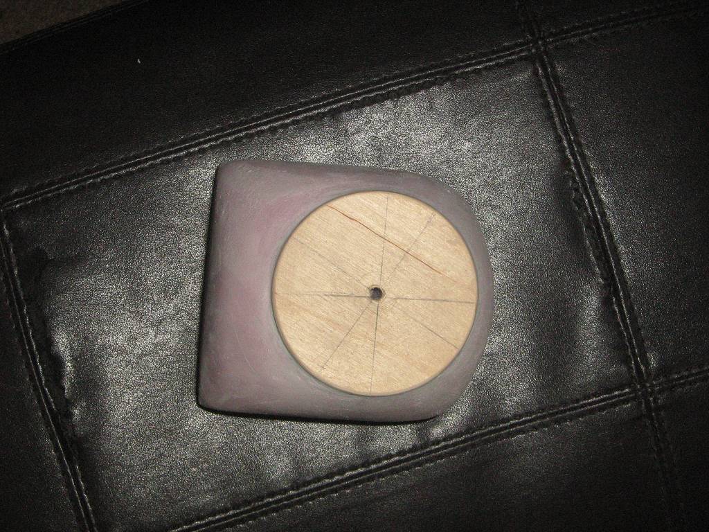

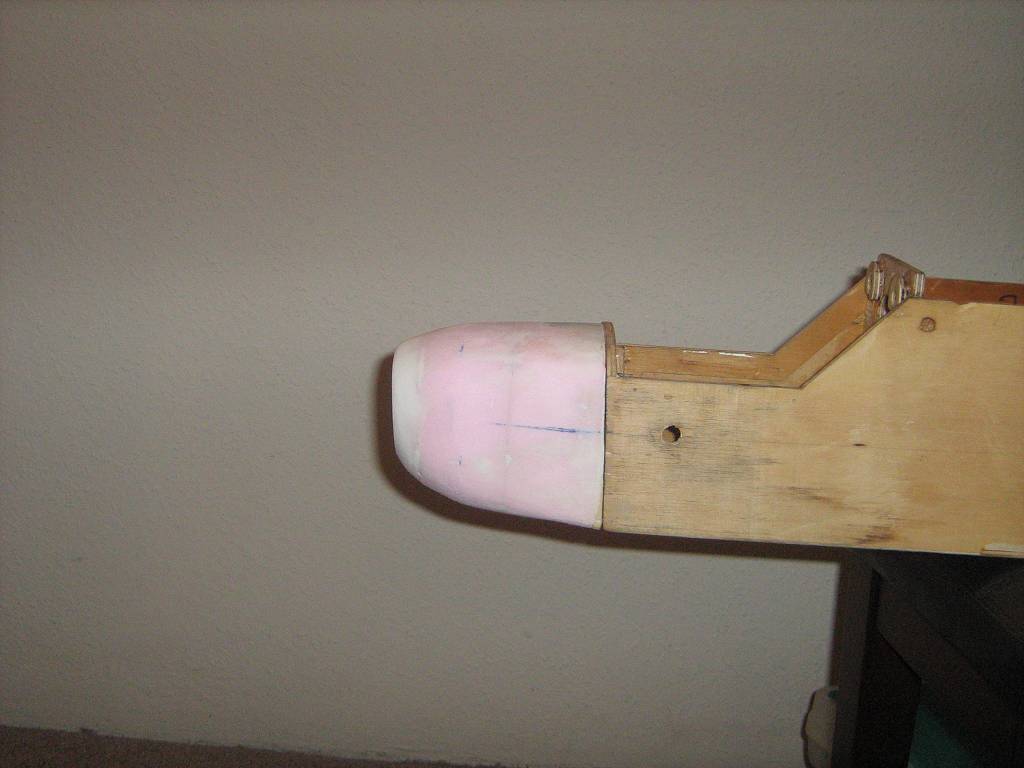

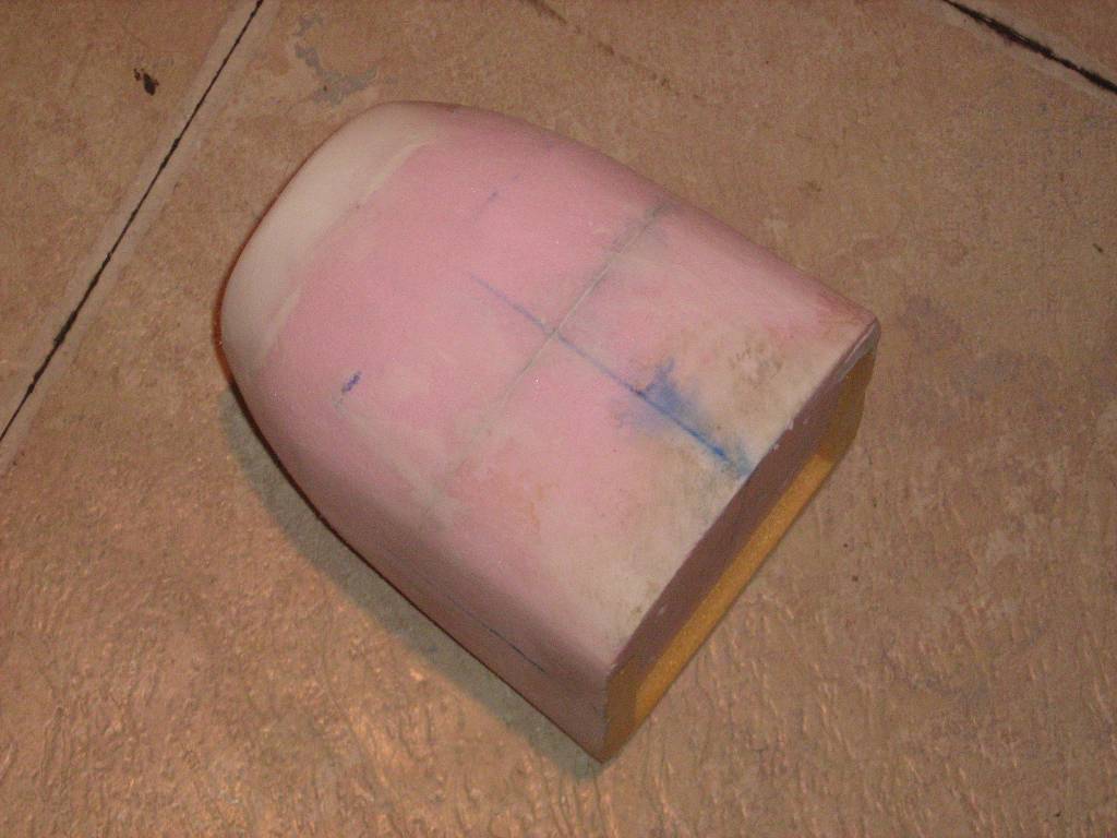

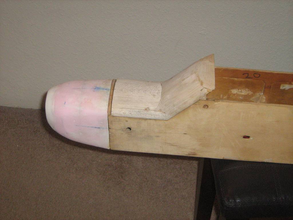

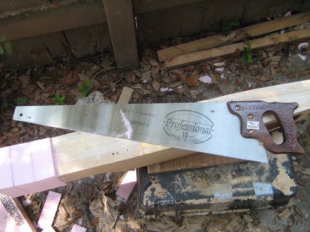

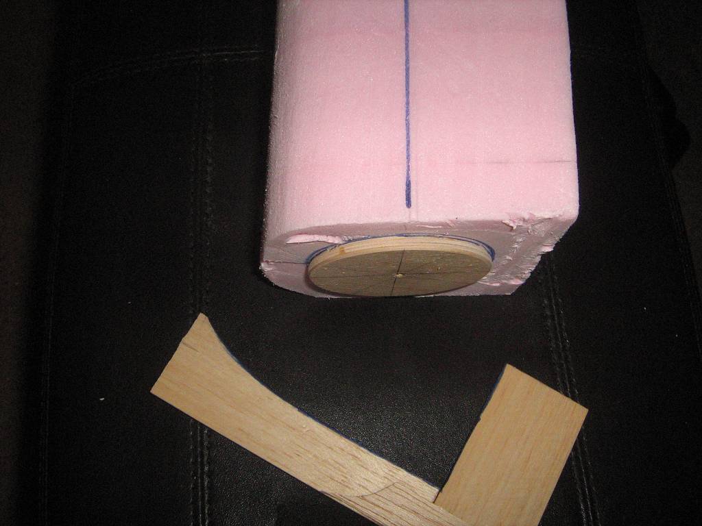

I used a hand saw to rough cut the mold to match the fuse. I just laid the saw flat and used minimal pressure, kind of just let it guide itself. I was dripping with sweat. It is hot and humid here, but if I did not want the wife to kill me I had to do that task outside. I had no proplem with the saw tracking, no grain in foam.
I cut both sides, , bottom and top. Gave it a rough sanding then transferred my alignment marks and lines.
I made a 1/4" ply disc that will be right behind the spinner. The engine down thrust is built into the firewall, so all I had to do was measure the length to the spinner, then transfer that to the cowl mold. Keeping the same distance top and bottom, that way the front will align to the spinner. I did have to angle the front for 2° right thrust.
I will cut out the spinner ring after I have classed the mold.
I have applied light spackling compound to the mold to smooth it out and fill imperfections.
A little more very light sanding and spackling, then it will be ready to seal with white glue.
