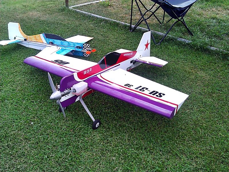

kinda crashed my nitro profile plane the other day hovering and the battery slid forward into the on/off switch and did a nasty job on the balsa...i have the balsa fixed up good but cant for the life of me get the new monocote to stick....i have tried using alcohol to clean off the nitro so it would stick and nada....any info or help with this would be awesome before my blood pressure spikes....again lol

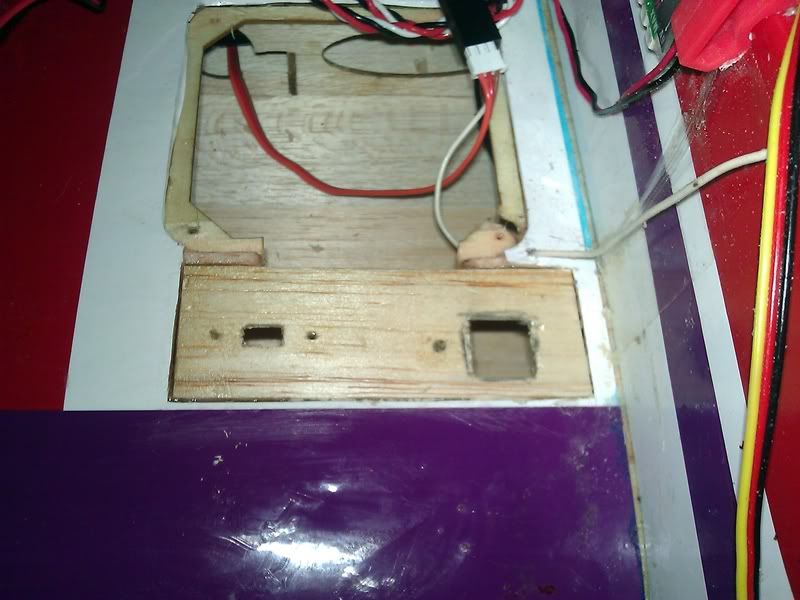

im using a iron and yes i pealed the back off the monocote im about to CA it if it doesnt work soon
here is a picture of the patch that i put in

Hi, what you need is get off all the grease form your wood. I've had use thinner (lacquer or polyurethane) and alcohol alternatelly to sock the wood. Use a cotton or a cloth to apply and rub it to clean the wood, like washing it. let it sock and absorb the solvent, this will dilute the grease.
Then, use some paper towels to dry the wood and put towels over the wood. after that, using your iron at the hottest setting put it over the towels. this will warm up your wood but the towels will absorb the grease. Change towels repeatedly until they don't absorb any more grease.
You can repeat the process if needed. after this you can use the balsarite. Let us know if it worked for you. In extreme cases the wood is no longer good and you have to change the piece... Hope its not the case. good luck!

i'll give it a try, the piece for my switch and charging port is new balsa, but had been handled alot. im guessing the grease and oils on my skin on my hands are screwing with it...i have probably cut 4 or 5 pieces of monocote to cover this spot just in the past hour or so before getting on here to ask for help lol

Try the next:
- clean your desk and put away everything you use to build: tools, glue, dust, etc.
- clean your plane with a cloth using windex. Personally I use a mix with windex and a grease cleaner. It will leave your plane with no grease or dust.
- use the cleaner for the desk too.
- wash several times your hands before and during the process.
- after all, wash your hands again and start cutting and applying the covering

this is how the plane usually looks

OK.....here's a quick and fast solution to your problem. Take rag and some alcohol, wipe down ALL the surrounding covering.
Cut a piece of the new Monocote, at least one inch bigger that the entire patch area. Using your Monocote iron, set on about 2-2 1/2,
attach your patch to the newly cleaned area....DON'T BOTHER STICKING IT TO THE BARE WOOD....YOU HAVE TOO MUCH SUPER GLUE ON IT!
When you have the patch completely sealed on the existing monocote, take your heat gun, and shrink the wrinkles out of the Monocote...shrink it to the wood parts!!! IT'S JUST THAT EASY!!!!

I think RCManiac119 hit on the problem. It looks as though you have soaked the piece of wood with CA. You will have great difficulty sticking monocote to CA.

The most common problem when preparing an area to cover is to touch it with your skin. Don't ever use your hand to wipe an area clean. The oils from your skin will prevent the covering from sticking properly.
I use a compressor and nozzle to blow all dust off from any area that is ready to cover. This is followed by a wipe with clean paper towel wet with acetone. Don't smoke or have any source of fire when using acetone or you will have an exciting event!
Even poor adhesive Moneycote will stick well if this is done.
I also wipe any areas where overlapping covering needs to be applied before the next piece goes on with some acetone. The covering will stick to the other layer so well that it is almost impossible to pull it back off.
The secret for good adhesion is to be dust free and no oils.
