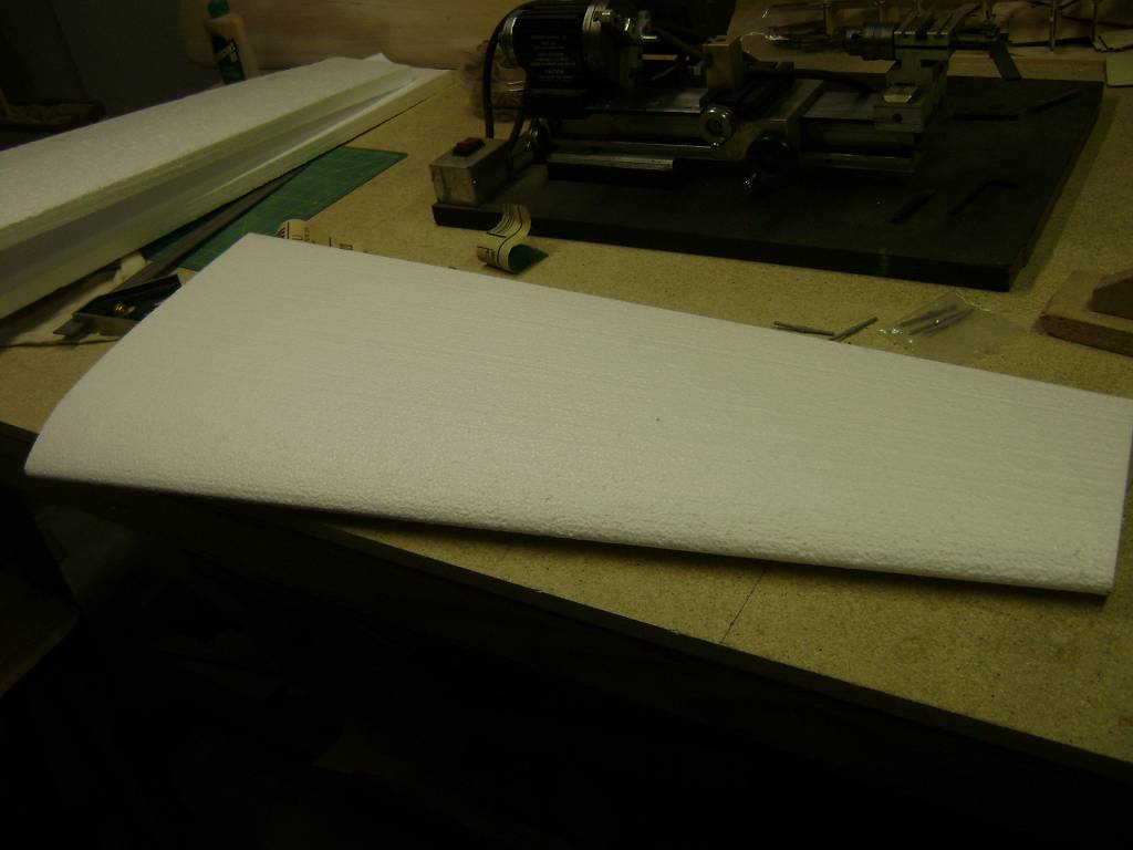

I always assumed that a foam core sheeted wing would weigh (SIGNIFICANTLY) more than a built up wing.
Well, I am very close to finishing a sheeted foam core wing for my CAP. I only have one of the original wing panels from the CAP so I stripped it of all its plastic covering. It weighed 256 grams on my balance beam scale. The new wing is complete except for hinges which will be four Robart hinge points. The new wing is also one inch longer and 1/4 inch wider as I wanted just a tad more wing area. To the point... The new wing weighs 240 grams. A difference of 16 grams. Now technically it is lighter than the old wing, the the difference is so close that a different selection of wood could have just a easily swung the scale the other direction. The new wing will get glass cloth and epoxy and be painted. Done right this will be just as light as ****coat.
The ailerons were cut from the wing and balsa edges added. They are rather thick at a 1/2 inch and this looked like the easiest and lightest way to do it. I still need to shape the leading edge of the ailerons so I suppose another gram or two may come off. I'm very happy with the result. This set of wings was a lot of work as I had to reconstruct my foam cutting rig which got tossed out sometime in the last 10 years or so. The new rig is much better so no big loss
I think I see the light at the end of the tunnel on this build.... I mean rebuild, er scratch build.... WHATEVER

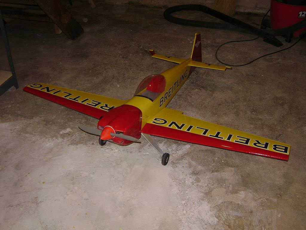

Well, the old girl finally has some cloths on. I still need to wet sand and clear coat, install the servo tray and all that stuff. I was going to wait till the last second to install the radio gear but I'm moving forward right away. It will be close enough that a battery move will give me the final balance point. Here are the photos of the final paint.

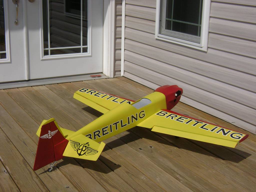

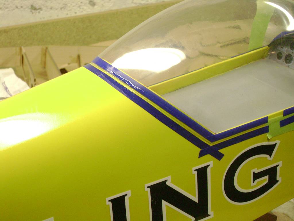

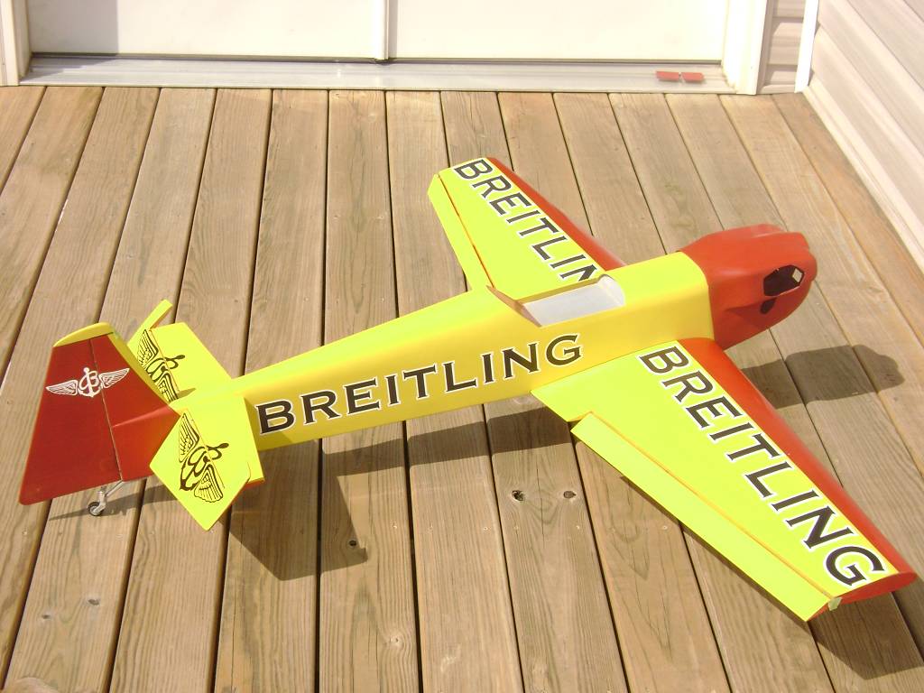

It's almost and ARF now I need to spray on a clear coat to seal the graphics and fuel proof the paint. Then it's on to hinging and and the rest of the fun stuff. I almost forgot I have to drill a hole or two in the fire wall for fuel lines and throttle cable.
Of coarse I'm a bit prejudice..... But I think the graphics transformed the Cap from "just another another plane" into something a bit special. It really stands out without being "gaudy". But then again, what do I know

I shot the clear on the CAP today. I took it to my work place as it was warm in the shop unlike my garage. The high temp the last time I looked was 55 degrees. I almost brought it home and was in the process of loading when I thought I was being very stupid[&:]. It had only been 45 minutes since the spray gun had shot the last drop. While the paint felt "dry" I could tell it was still a bit soft. Thankfully, my better judgment took over and it stayed where it was. I live about 15 miles from my work and was thinking I could save a trip. I'll go grab it tomorrow morning. I just need to paint the top of the dash black, then the canopy and "instrument panel" can be installed. One week to go before the mall static show. I think I'll get it done by then......... Well maybe
I'll post pics after the canopy is on.
Ken
PS. It's always amazing what a good clear over the base color does. The colors really "pop".

Here are some photos of the finished plane. All the control surfaces are hinged and the paint is done. A couple of photos of how I glue my canopy on to get a clean glue line. I mask about 1/32 off the edge of the canopy itself and about 1/16 off the edge of the canopy on the fuse. I used Goop and spread a thin line with my finger. Let it dry for a nimute and then pull the tape. I do the front and back first, then the sides. I small stick holds a trouble spot that didn't want to lay tight on the fuse. I still need to make up the pus rods for the control surfaces and mount the servo tray. All easy stuff!
The Callie Graphics look great in my opinion, and really set off the plane. A big thanks goes out to Calli for the the work and more so her patients while working with me on this project.
Our club is having it's annual mall static show this weekend. It's "done enough" to display.
Ken
