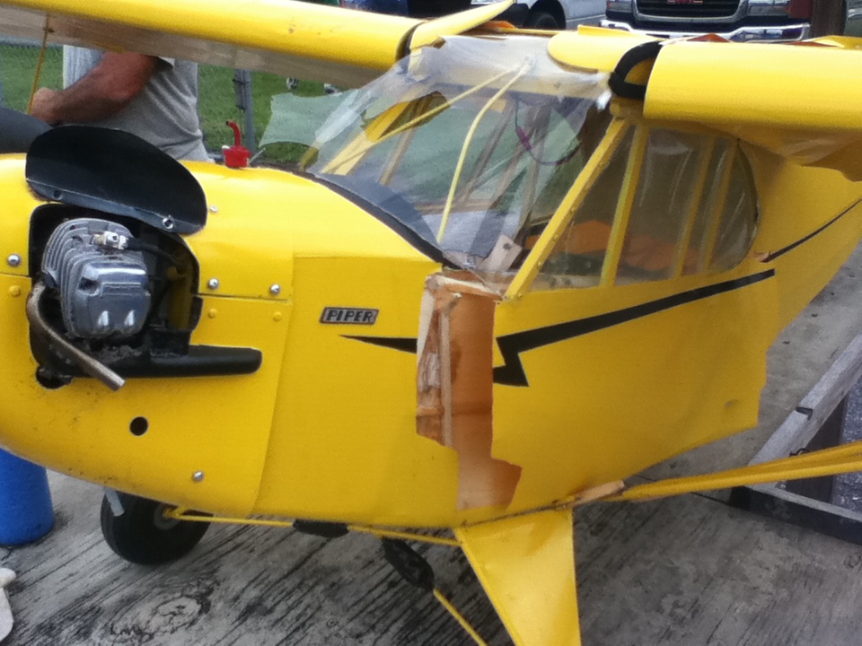

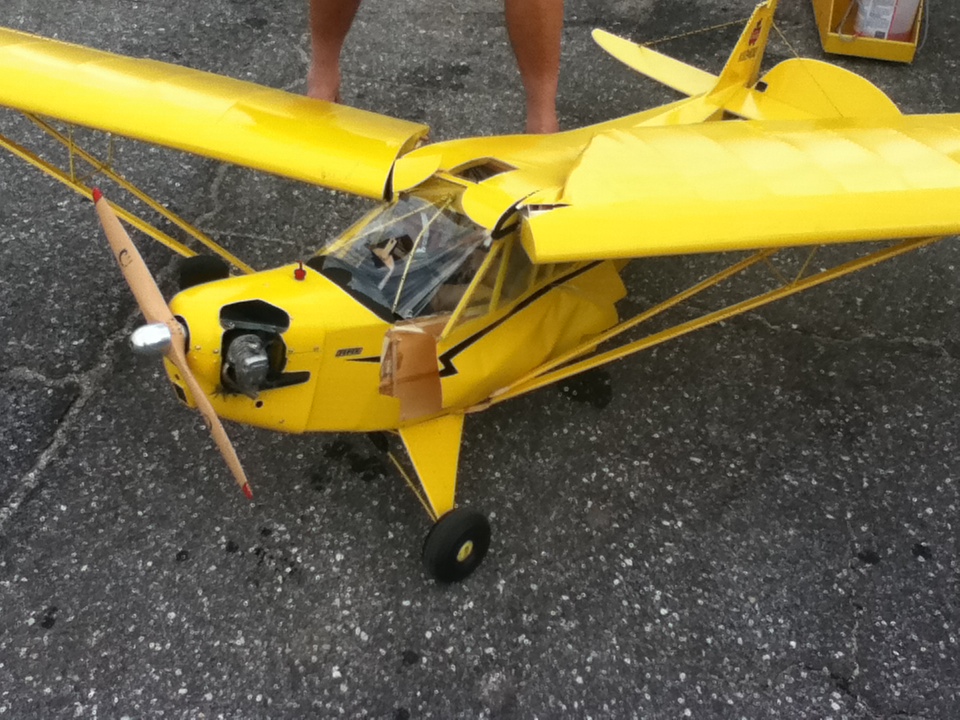

Yeah, I know. What do you mean "after recent rebuild"?
I have this quarter scale Balsa USA Cub that was sitting cozy on my bench after a crash about five years ago (big bench). I got tired of moving things around so I decided to finish it along with the constant prodding of a club member. I got tired of listening to him yabber about it. Five flights after finishing it, I was concentrating on the plane and not on its surroundings during an approach and I clipped a tree with the outer 12 inches of the left wing. Spun that sucker around and made a sickening sound coming down. Luckily, the engine survived (twin O.S. 1.60) with no damage. The fuse broke in half at its weakest point (the cabin) and the inboard bays of the wing halves took a beating, bending the aluminum root tongues. I decided to get right on it so that it wouldn't sit another five years.
Bob

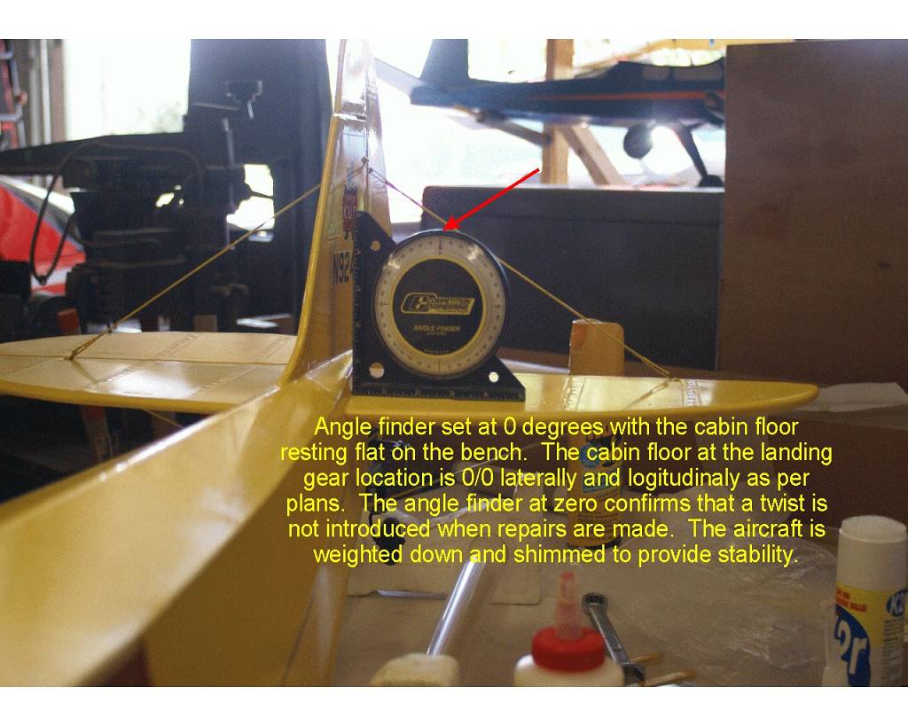

I decided to document the repair as long as one of our young new club members had his phone to snap a few of the sad pictures on the day it happened. At least I was able to show him the down side of the hobby and with luck, a way to turn it around. The first two pictures show the damage and its concentration at the cabin area. The last picture is the guy I'm blaming for this whole fiasco.

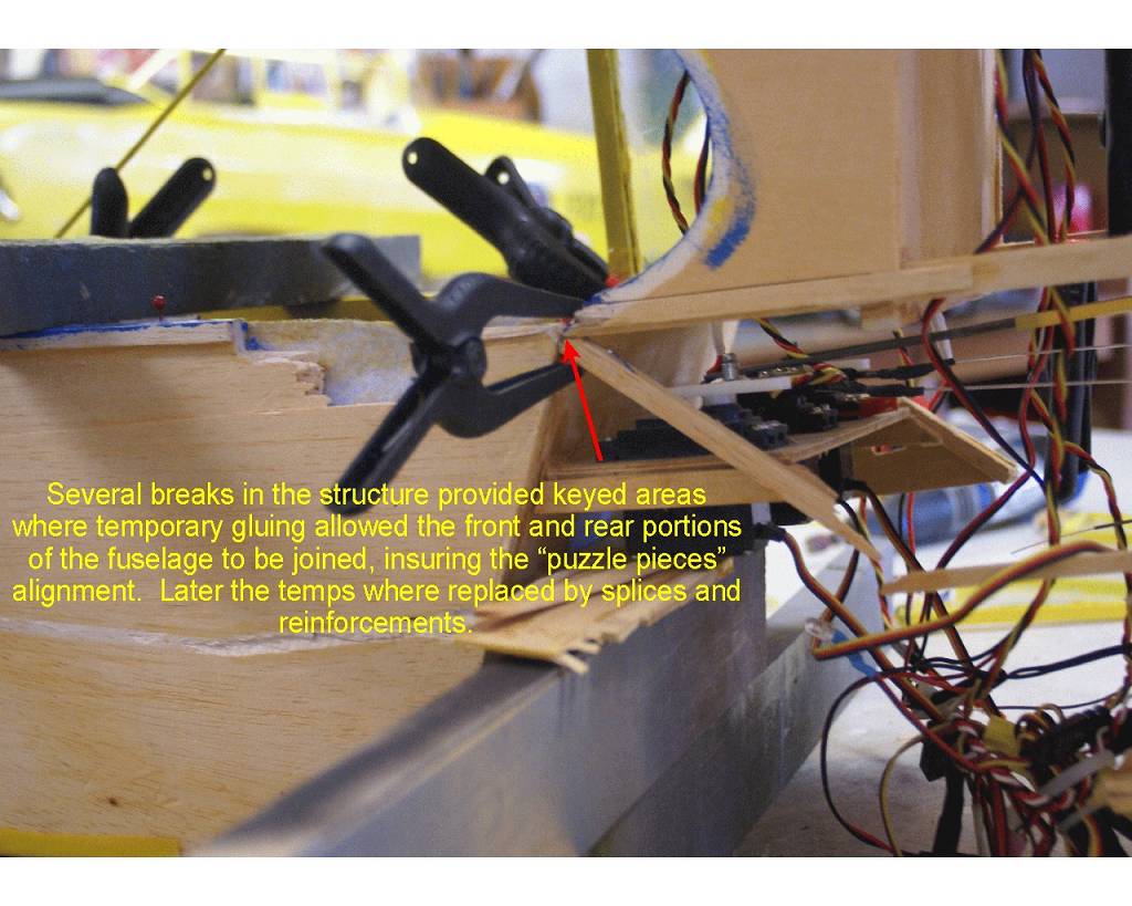

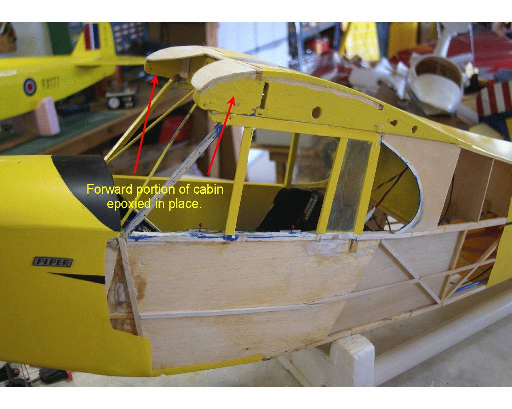

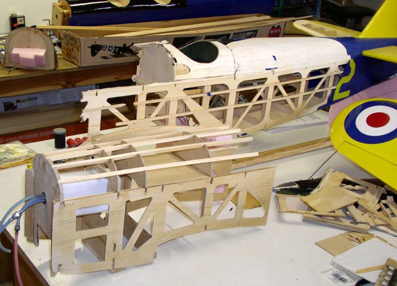

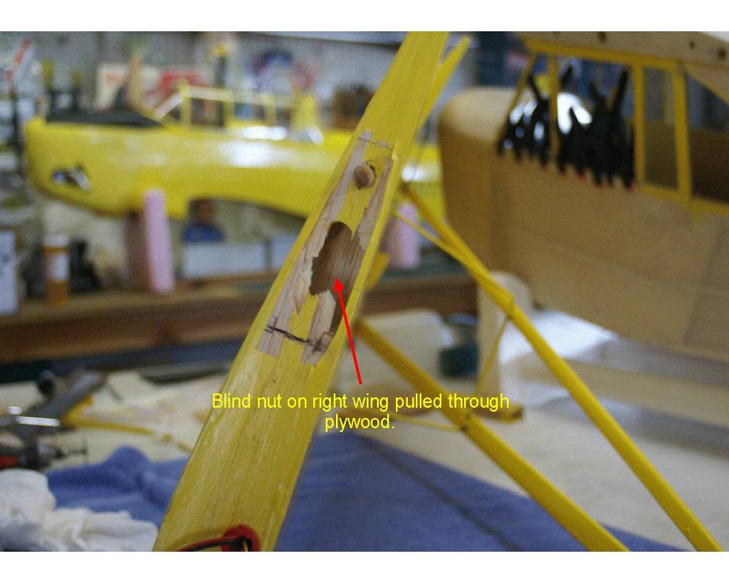

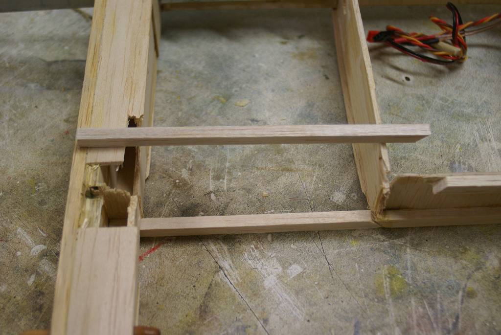

The next two pics show the beginning of the repair. It is important to get all the surviving pieces in alignment. I used clamps, weights and an angle finder to make sure the tail feathers weren't twisted when I glued things back together.
I fit some of the balsa wood structure together and later removed and replaced the damaged pieces when I had a solid fuse again. The old balsa sticks were only used to fit everything in its proper place, CA comes in handy here.
Bob

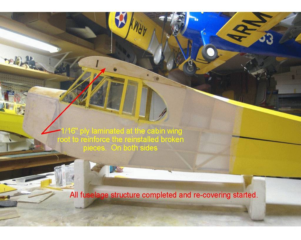

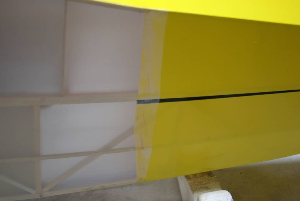

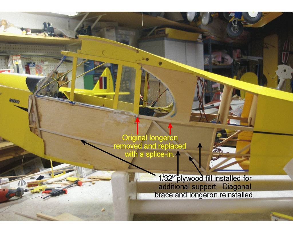

You want to make sure you gather up all the pieces after the incursion (ground, tree or other) so that you can duplicate the broken pieces if you have an ARF to repair. Kits are easier because you have plans to work with. I am presently working on a Great Planes PT-19 that lost its forward fuselage and I used the mangled structure glued with CA to enable me to trace a pattern of it. This allowed for duplication of the first one-third of the airframe in plywood. The old formers were used as patterns also.
These pictures represent the completion of the fuselage repair. There are some internal pieces that I didn't show, but they just amounted to some bracing holding the servo ply mounting.
The covering was spliced with new pieces and is ready for paint. I used the remaining Nelson Lite Fab that I had and also some new Solartex. You can't tell the difference and unless someone knows different, I think they are the same product.
Bob

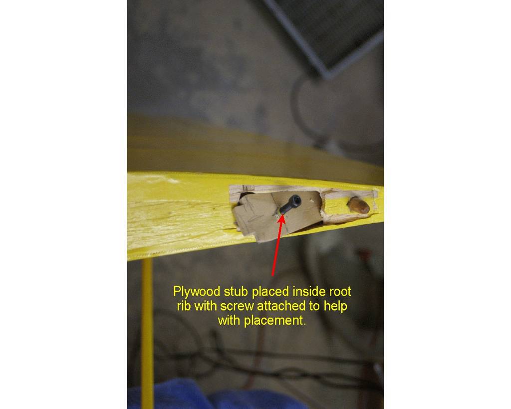

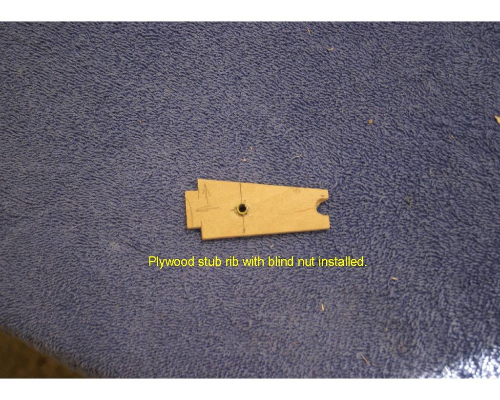

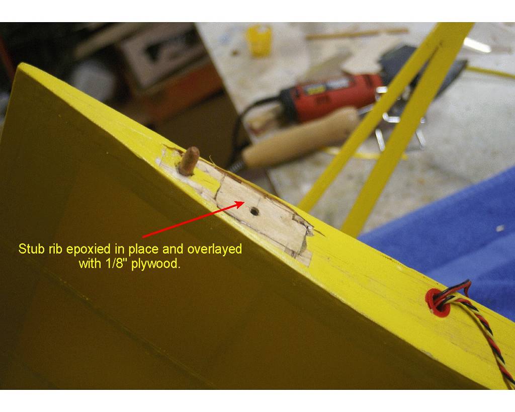

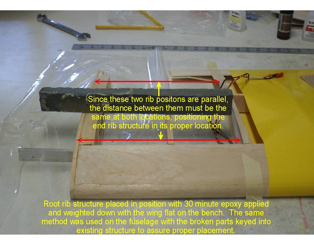

This next group of photos show the root rib of one of the wings and its repair. I had to replace the portion of the rib that contained the T-nut for securing the wing to the fuselage cabin. As you can see, a short piece of rib was fashioned and it was made so that it could be placed inside the existing rib. This piece is actually bigger than the hole it is placed in. If you turn it a bit on its side, it can be slid in behind the existing rib and epoxied in place. i used a socket head machine screw placed in the T-nut to allow placement.
Another piece of plywood was cut and inlayed in the rib over the repair.
Bob

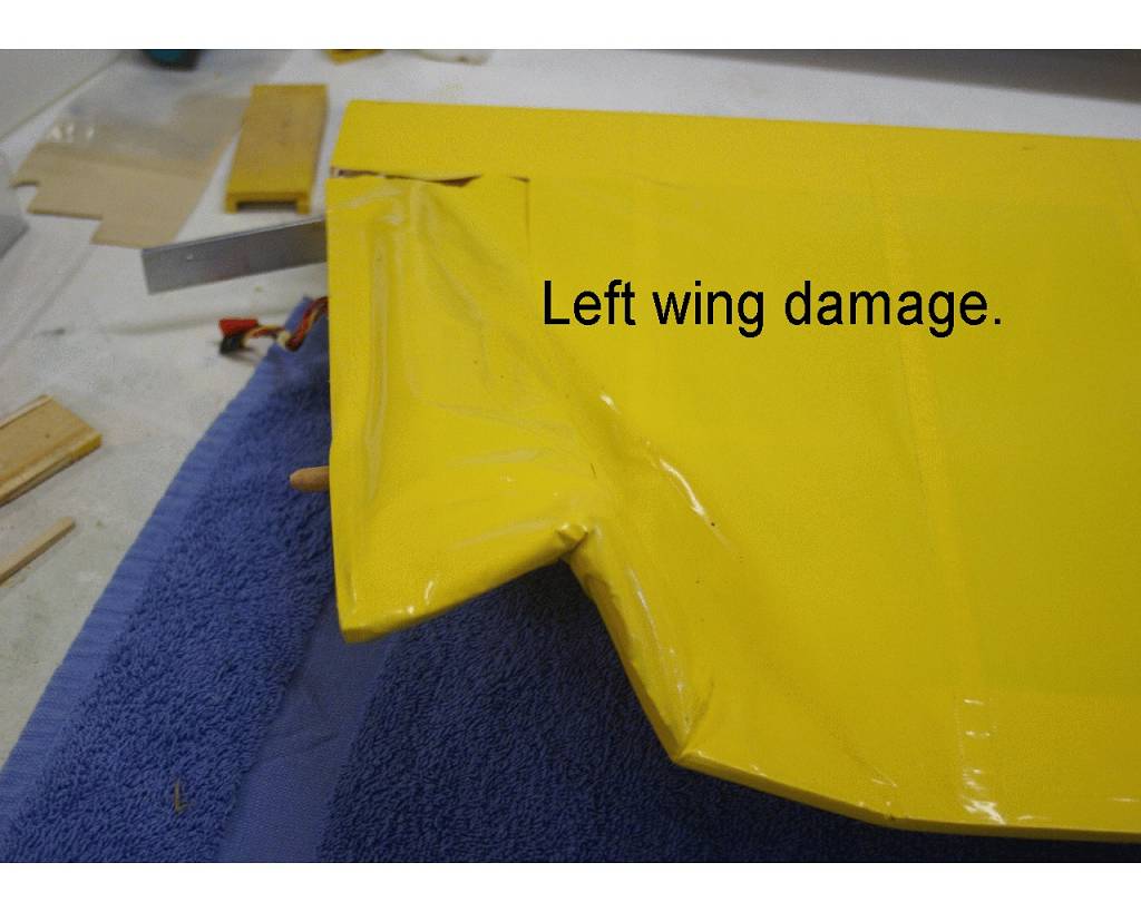

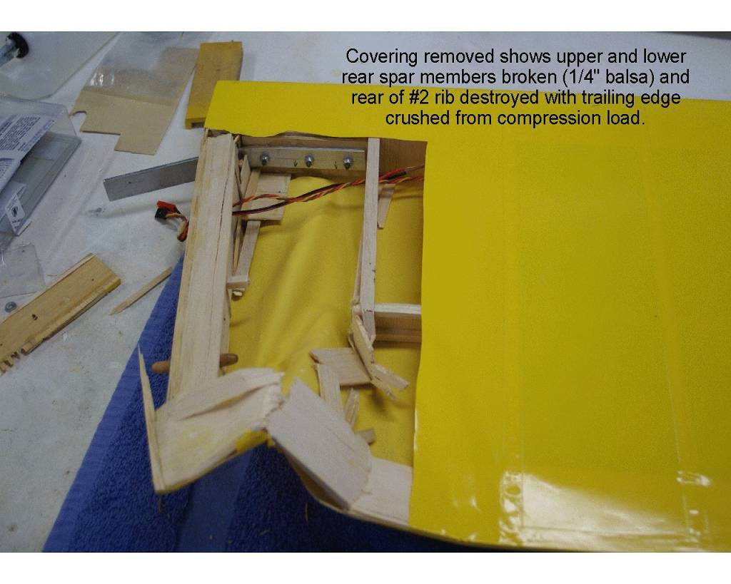

The next two pictures show the damage of the left wing root.
Bob

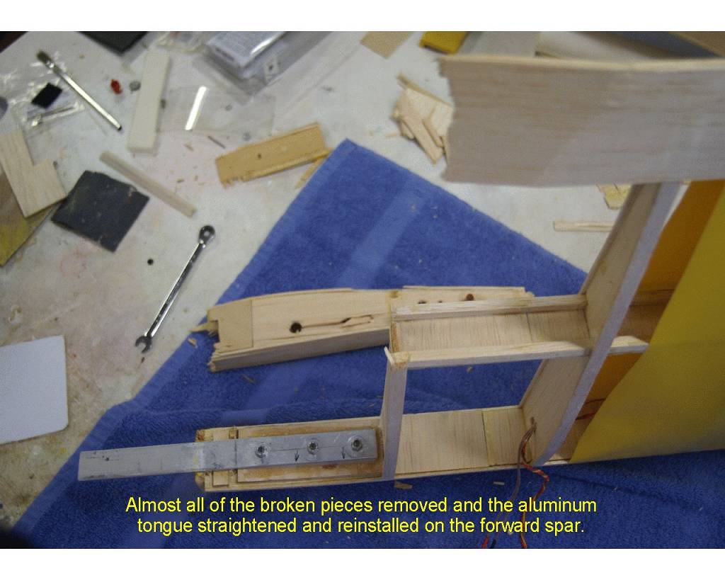

The picture below shows the damage and removal of the broken structure on the left wing.
Bob

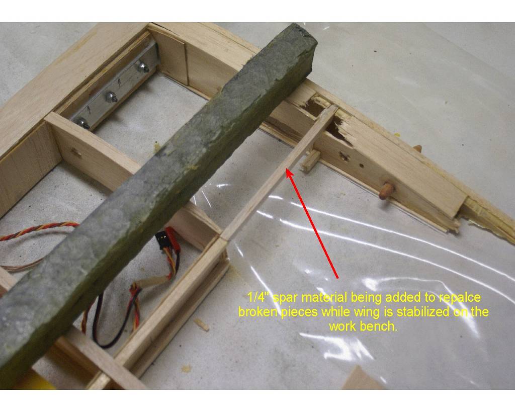

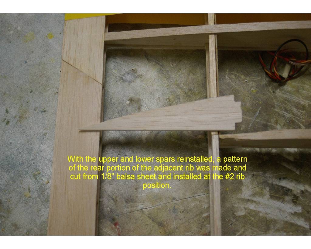

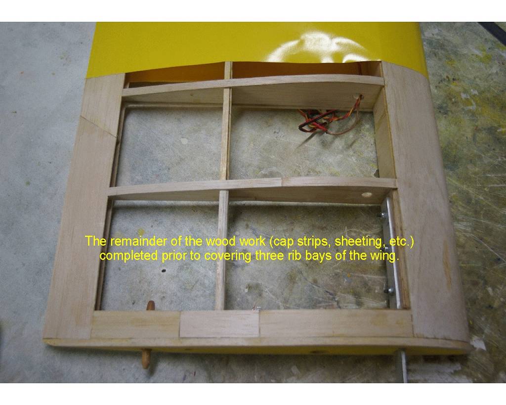

This series of pictures show the repairs progressing on the wing including the installation of the original root rib, upper and lower spar repair and trailing edge. Again, everything must be flat on the building board with this type of wing, Other airfoil shapes will have to be shimmed if they are not flat-bottomed.
Bob

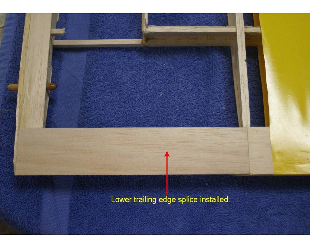

I neglected to show how the spars were spliced in the last post. The balsa peices were cut on an angle to give greater gluing area than a typical butt joint. Always use an angle cut for more strength. If you want, you can face each side of the glue joint with thin ply for more strength.
Bob

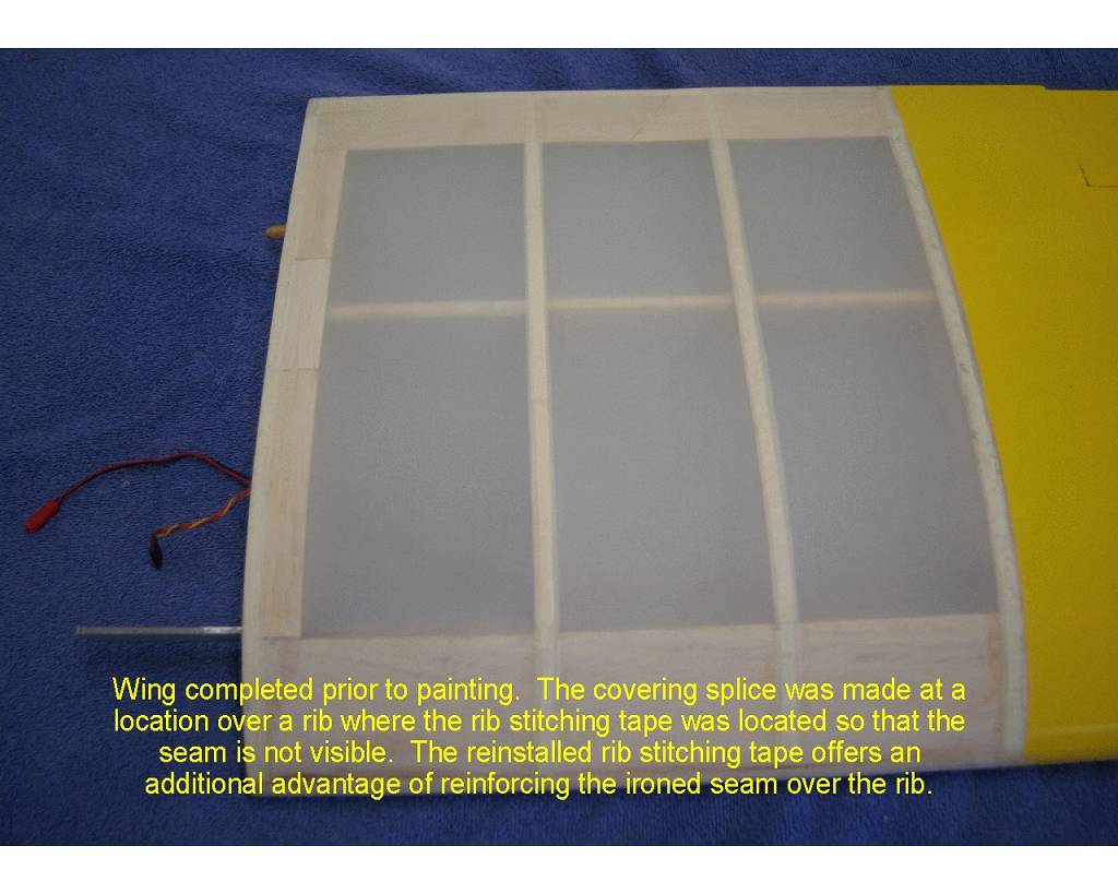

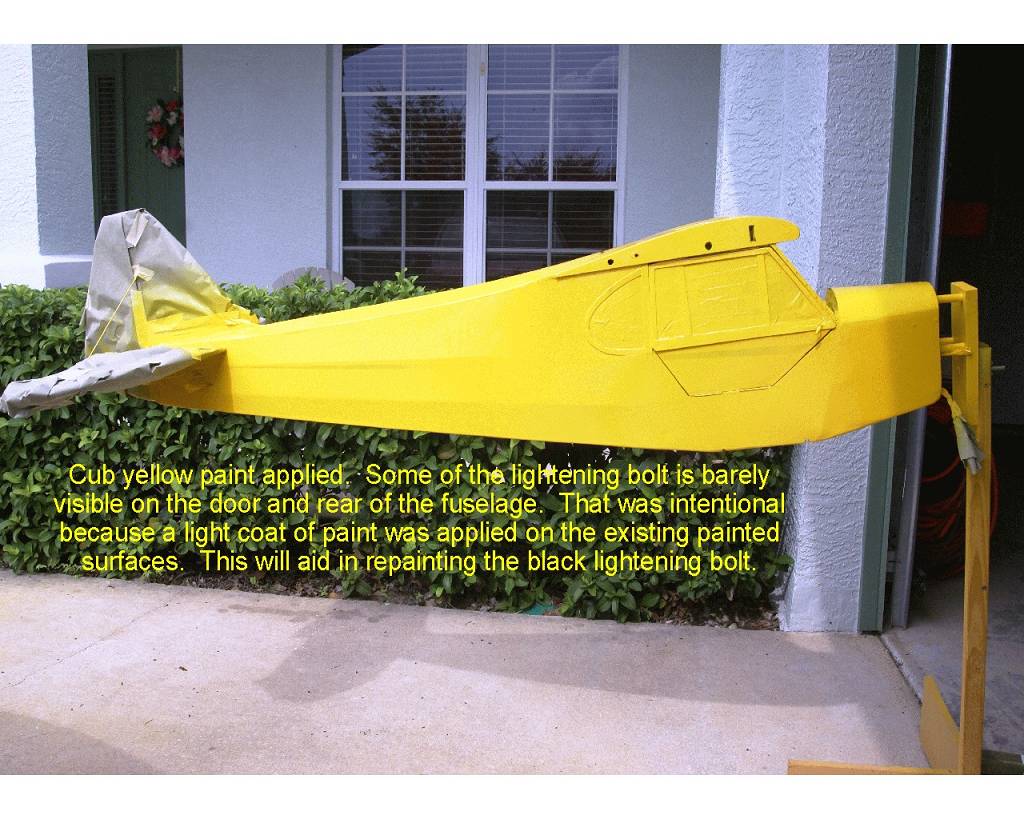

I placed the Cub on a paint fixture that I made. This fixture allows rotation of the fuselage for painting at the ideal angle. I don't have to reach under the fuselage to paint the bottom.
Bob

The first picture shows what I gave the pilot to ride while fixing the Cub.

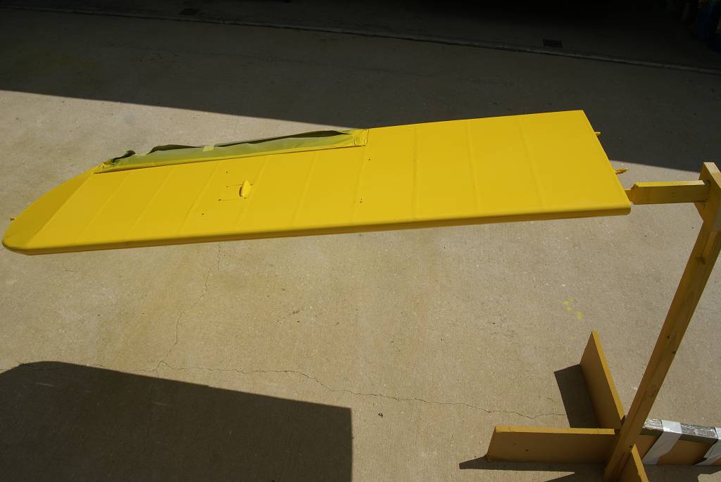

The wings were painted using the same fixture. I was able to hide the splice of the fabric repair under the pinking tape (Pink-It) and rib stitching.
Bob
ID:	1686875   Click image for larger version

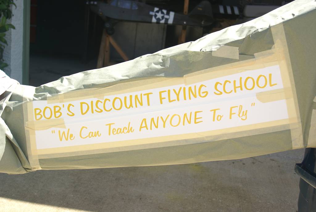

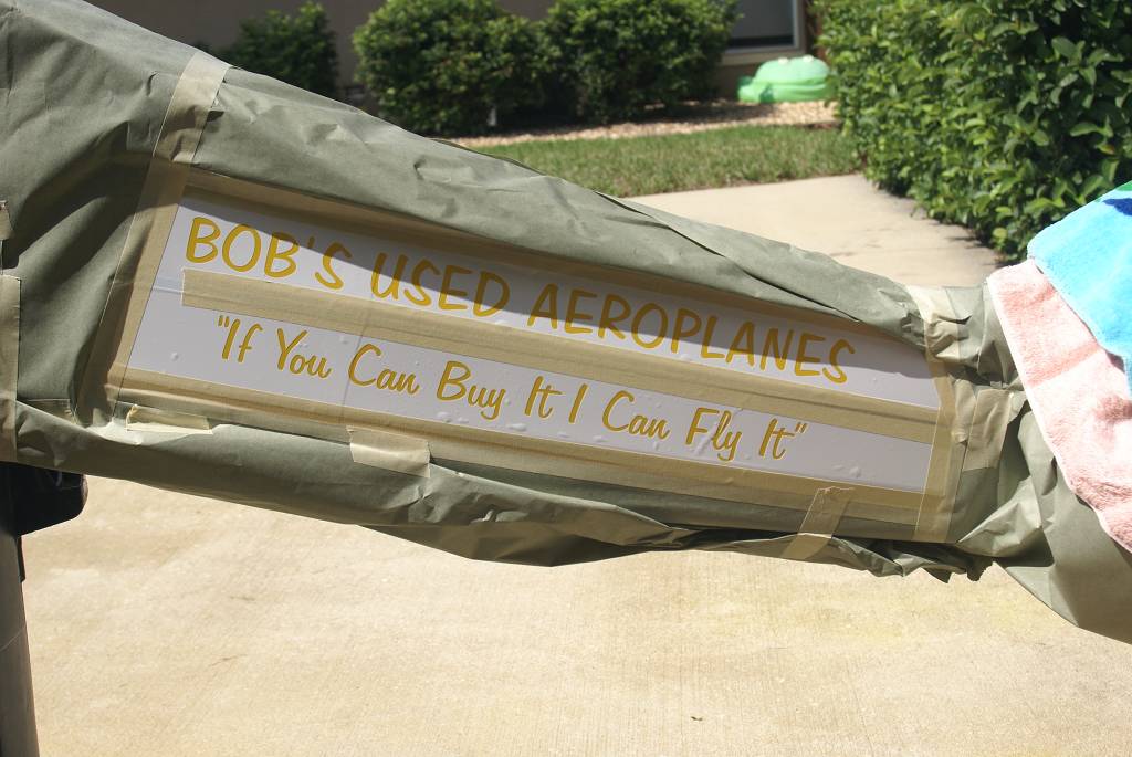

The re-paint allowed me to add something different to the side of the fuse. I obtained paint masks from Dick Tristao at Two Bit Grafix and reproduced the lettering on the side of Greg Kuntz's stunt plane of the Alabama Boys.
Bob

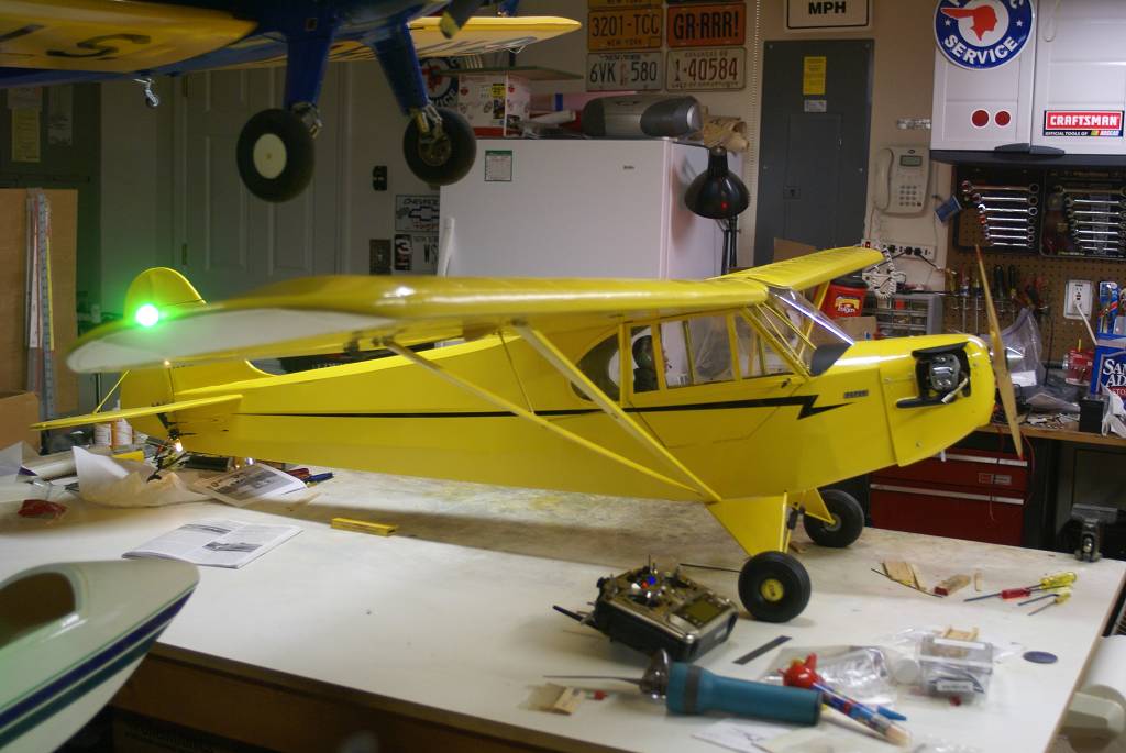

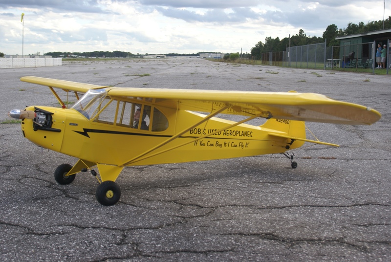

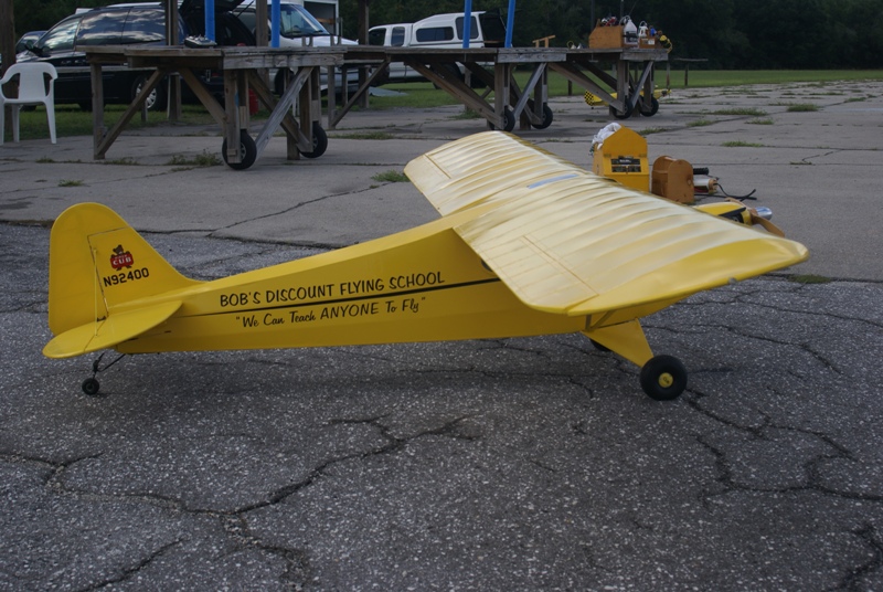

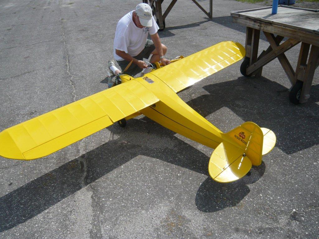

This is the final product. It flies straight, and as is the case for a Cub, has no bad habits.
Bob

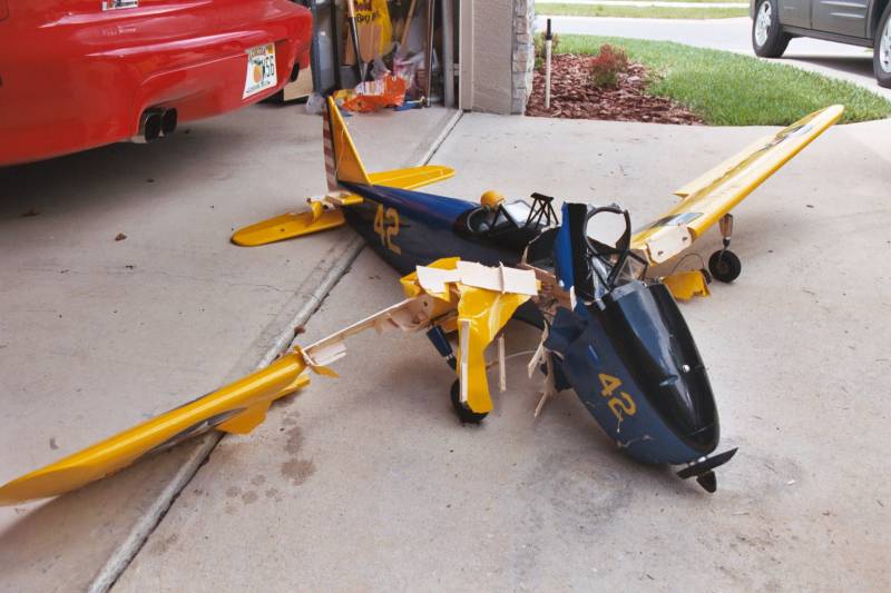

Here is a picture of a PT-19 of mine that was repaired after a mid-air with a Dynaflite PT-19.
Bob
